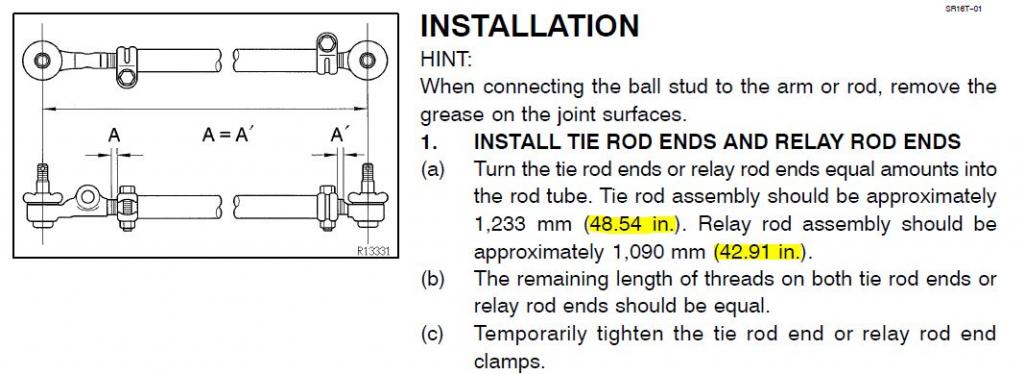

I found these instructions in my FSM. When I replaced my TRE's I didnt have the FSM, so I tried my best to get the new TRE as close to measurement as the ones I removed. Yesterday I purchased a Digital caliper and measured the distances of the remaining threads on each side of the TRE and there was approx 1-2mm difference. So I removed all my TRE's and measured as per the FSM. I got it to spec and put them on the rig.
Today I am going to center my axle some more by way of my adjustable panhard rods, used the eyeball method and it seems to be off by about a 1/4". Then I will perform another driveway alignment adjusting my toe-in to 1/8" using the same method in the FAQ.
