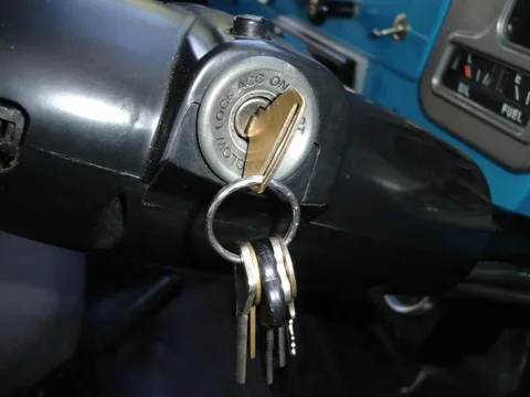

Hi Corglass.
Do you have an ignition switch like mine here:
Turning my key back (anticlockwise) from "On" will always turn my engine off.
I understand this is how it should be on yours too if you have a factory-fitted EDIC system.

lost marbles, my truck doesn't turn off via the key. My ignition looks the same as yours except I have a blanking plate where your has a black button (above ACC in pic)
I'd love to be able to kill it via the key. I presume yours turns off the truck via the key and EDIC?

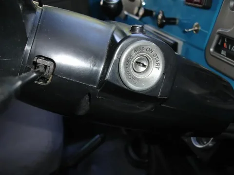

So you don't have that little button?
I think I need to push that down in order to turn my key fully anticlockwise so that I can pull it out... (but my actions with the key are so automatic after 30+ years of ownership that I just do it and never stop to think about it)...

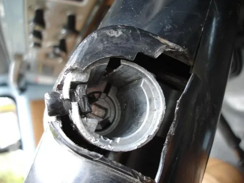

Does your steering automatically lock with your key removed? Mine does... Not that I'm saying this is a good theft deterrent ... because it isn't as this pic shows:
BTW - This is Hohepa's ignition switch after it was stolen here in the centre of Wellington.
(Bart, who was down in Wellington from the Far North for his university graduation named his 1984 BJ42 "Hohepa".)
Anyways... I'm thinking that if you don't have that button then perhaps your model doesn't have this steering lock..
