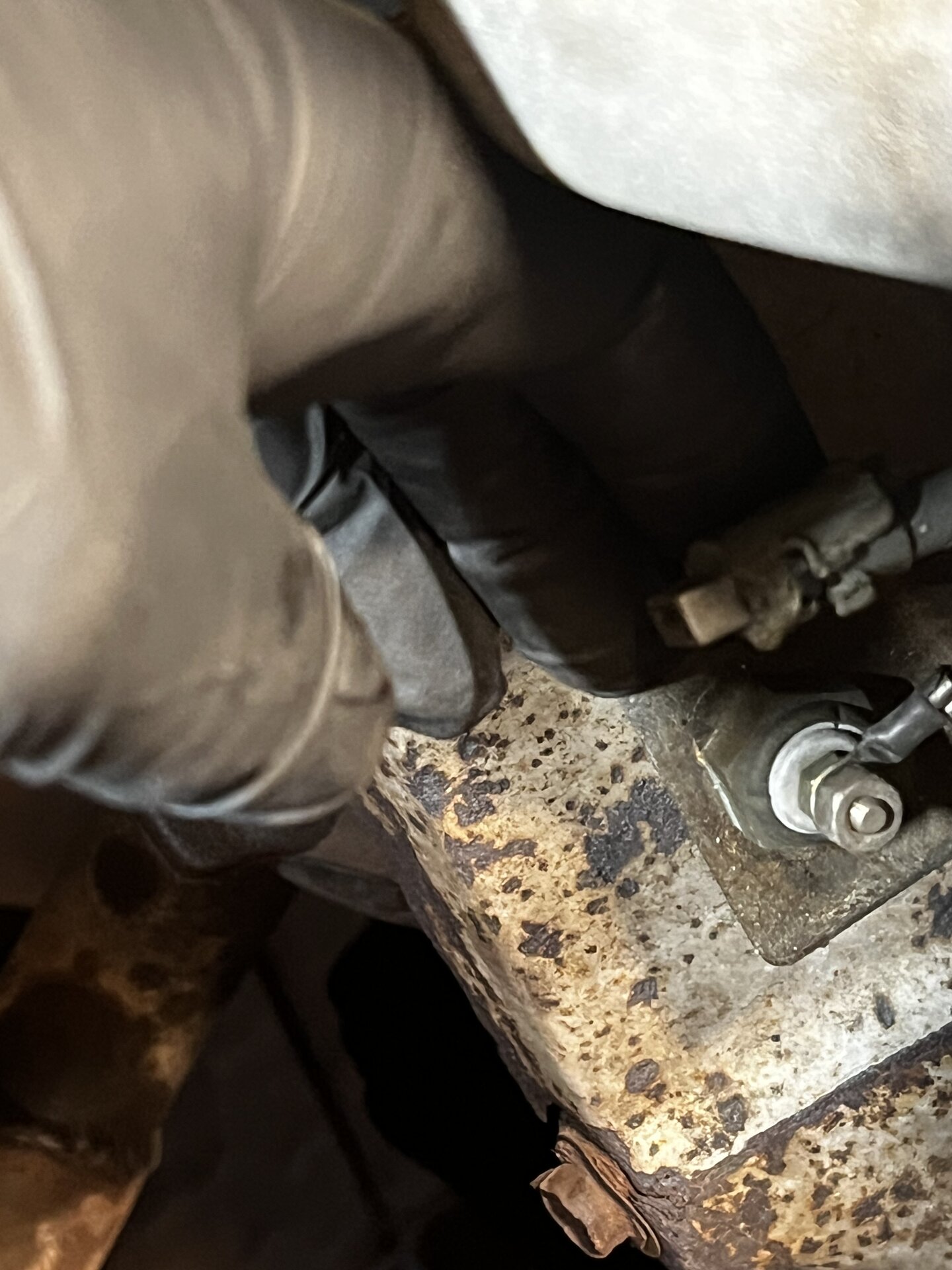

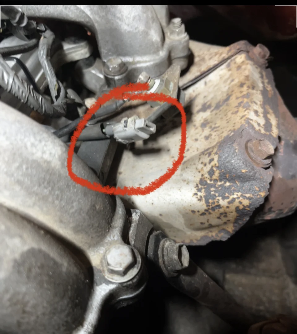

working in the engine compartment today I came across this. Is it something important? Can anybody identify what it is supposed to connect to?
Yes - should have mentioned that - thanks!FJ80 with a 3FE?
Wait for a 3FE guru to chime in @jonheld
EGR Gas Temp Sensor for California vehicles. Put a tie wrap on it and tie it away from the exhaust manifold.
