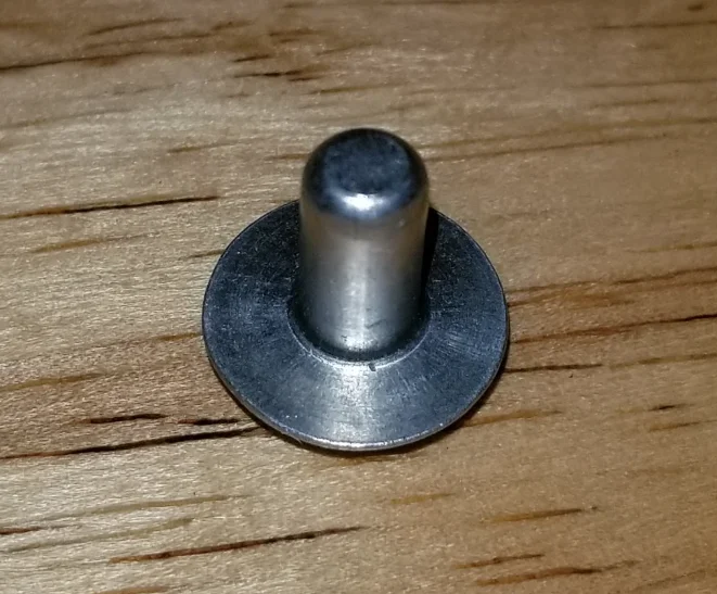

Hey folks. Thanks to everyone who's responded and helped with my roof cap project so far.
Now I'm ready to install the new rivets... The ones cool cruisers sent me are like aluminum mushrooms and they are not the type which work with a rivet gun. What rivets do you recommend? I notice a lot of people here don't like the CCOT ones. But if you have used them, how did you install them?

I did regular pop rivets with the head on the underside.
I did coated aluminum ones. They don't need to be very long, just enough to grab. You want them short enough so when you float sealant on the top side, they are below that level.

Did you use the same Cool Cruisers rivers I got?
I did get the Cool Cruisers rivets but found the head and shaft diameters were larger than OEM. I didn’t want to enlarge the holes so I went with a rivet from McMaster Car.
