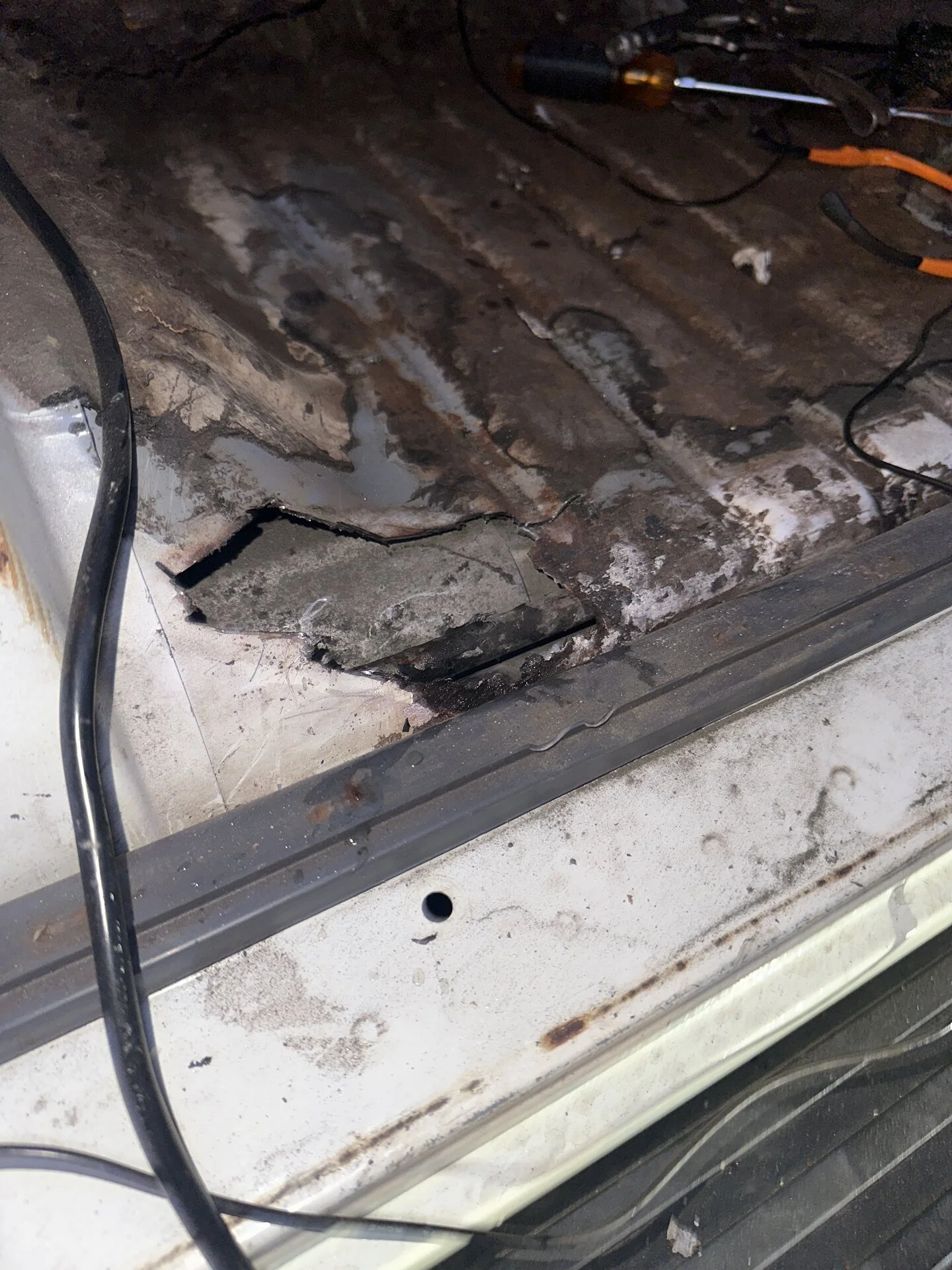

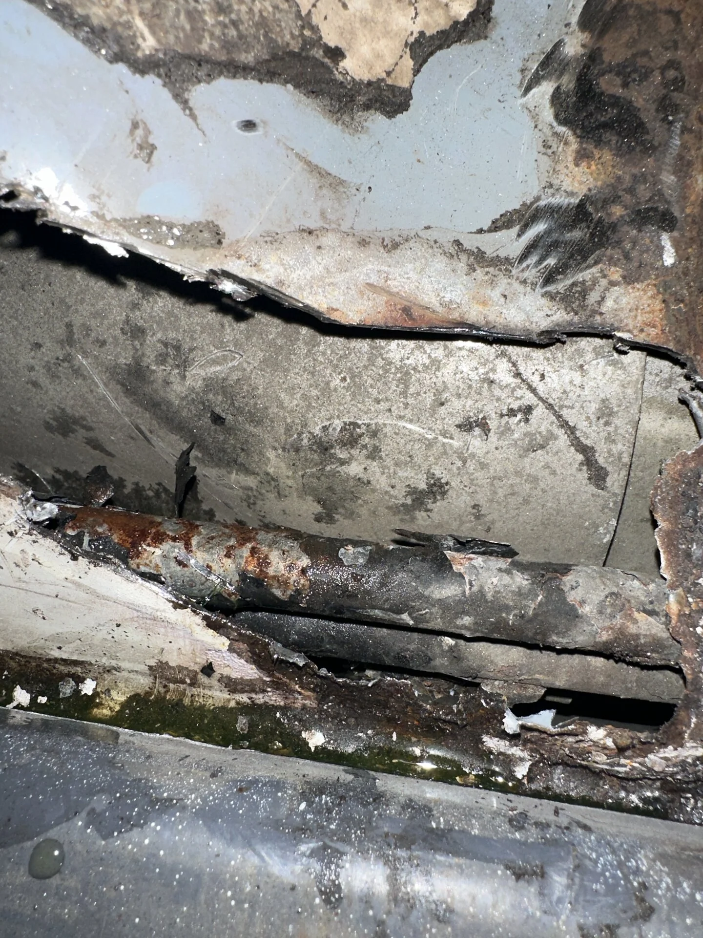

Found some deep rust on my passenger floor board that had made its way through so I decided to cut the small section out and grind the rest of the surface rust down and coat it with some Crc until I could have a new piece welded in. Of course accidentally while I was cutting I nicked the metal water line that is under the passenger floorboard near the door which is spewing coolant. Can someone please help me figure out where to find this line and how to replace it ? Can’t believe I did it. Thanks.
I think that is the rear heater line. Look up rear heater bypass. You’ll do that at the firewall at the rear of the motor. Good luck! You should do the PHH if you haven’t done that yet at the same

Yep rear heater probably a blessing in Disguise.
Line looks like it’s in pretty bad shape better to deal with it now then out on the trail.

View attachment 3280549View attachment 3280550

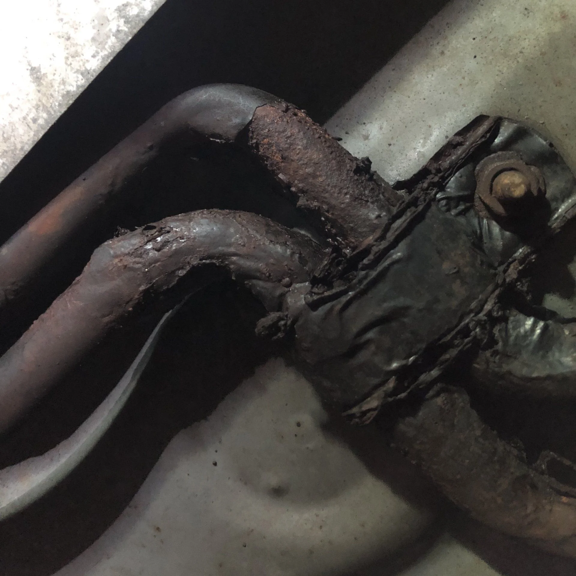

You can buy new lower rear heater lines from Toyota they are "easy" to replace. The uppers must have the transmission out.

Like I said, you can replace the lowers without removing the exhaust. Remove a couple heat shields, and you can get to it. It took me about two hours for the lower hoses and hard lines. Then I bypassed the upper hard lines because they are too rusty. I used hose for that because I couldn't get the old ones out in one piece without dropping the transmission. Believe me, I tried.

On the right side of the transmission. Horizontally.
FWIW, I tried to replace my lower tubes and couldn't remove the heat shields to get at them. And my truck has been in Charlotte since it was new.
I'd highly recommend bypassing the rear heater at the firewall under the heater valve, before you start this job. That way, if you can't get at the tubing, you can still drive the truck.
