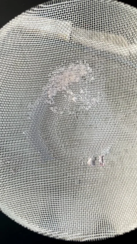

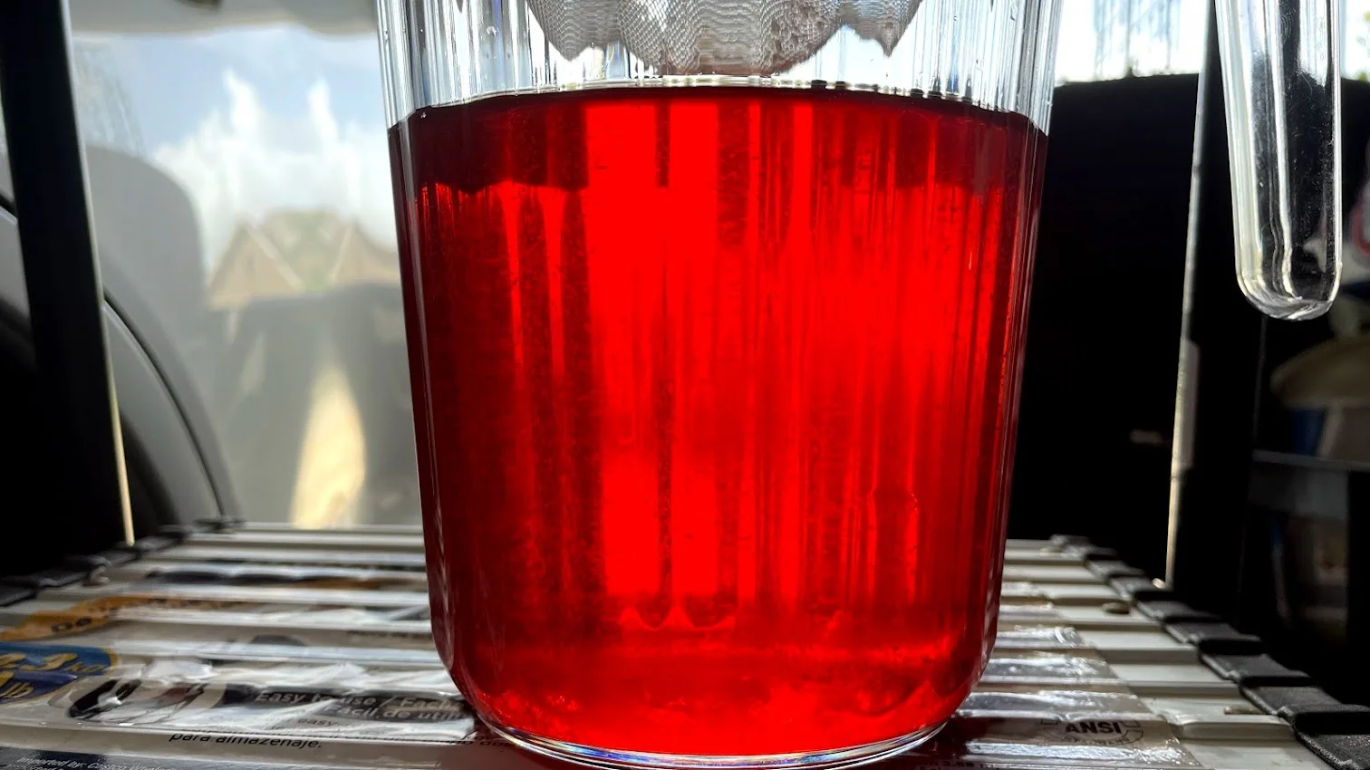

This morning I installed the new pump. I then filtered the remaining fluid from the bottle from Lexus into a clear pitcher and it was pretty pink.
So that got transferred into the reservoir.

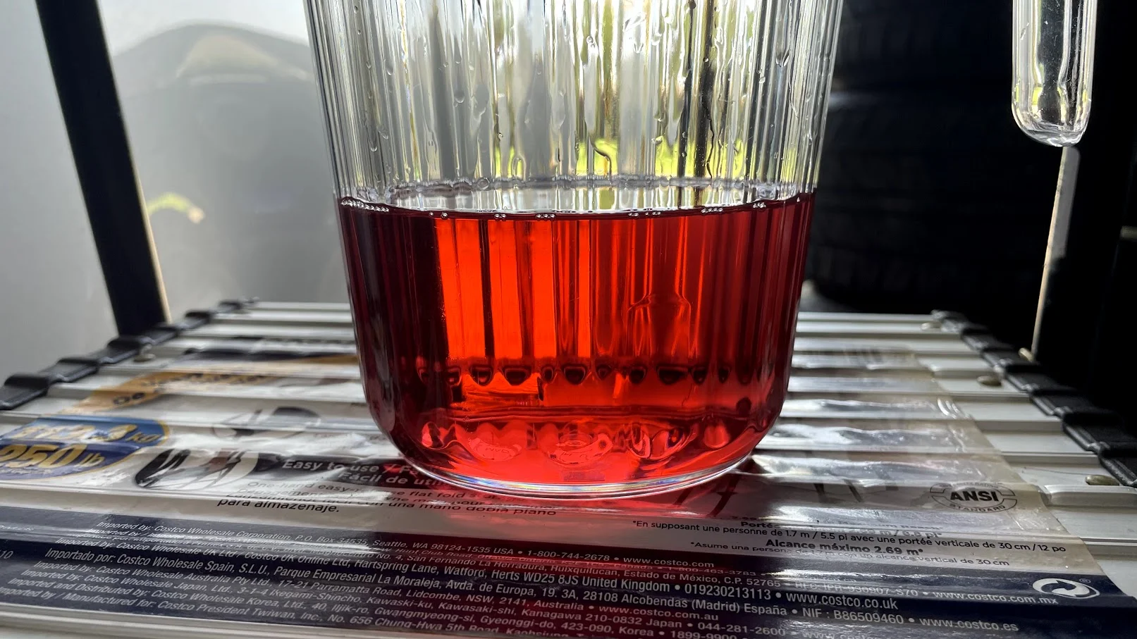

Next I did the same procedure with one of the bottles I got from Toyota... FAIL. See below.
After talking to parts at Don McGill Toyota I was told I could bring all the bottles back and get a refund. Great. I drove up to Westside Lexus, explained my dilemma and purchased 5 bottles of fluid from them. This was now the 5th person I've talked to at Toyota/Lexus who had "never heard of such a thing". Whatever. Moving on...
So far the 1st new bottle from Westside Lexus is clean, it's getting transferred to the reservoir. I'm taking video of every bottle I open and pour into the pitcher now.

I went back to Lexus and bought all new fluid, as stated above. Every bottle I purchased from Lexus was first poured into a clear pitcher for inspection. Every bottle was clean. In fact, all the bottles I bought from Lexus from both visits were clean. In contrast, every bottle that I purchased from Toyota from two different dealerships was dirty. Every bottle lol... This makes no sense to me. I was told by the parts manager at Lexus that all three dealerships are getting those bottles from the same distributor (Gulf States Toyota). Take from that whatever you like but in the future I will be spending the extra money and buying my fluid from Lexus even though I know it's the same damn product I can buy from Toyota for a better price. I've edited my first post on this thread with an AAR for whoever might find it later...

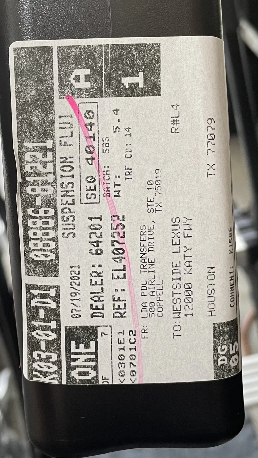

Same part number. Bottles looked identical as well.
Are there any lot or batch numbers on these bottles?
