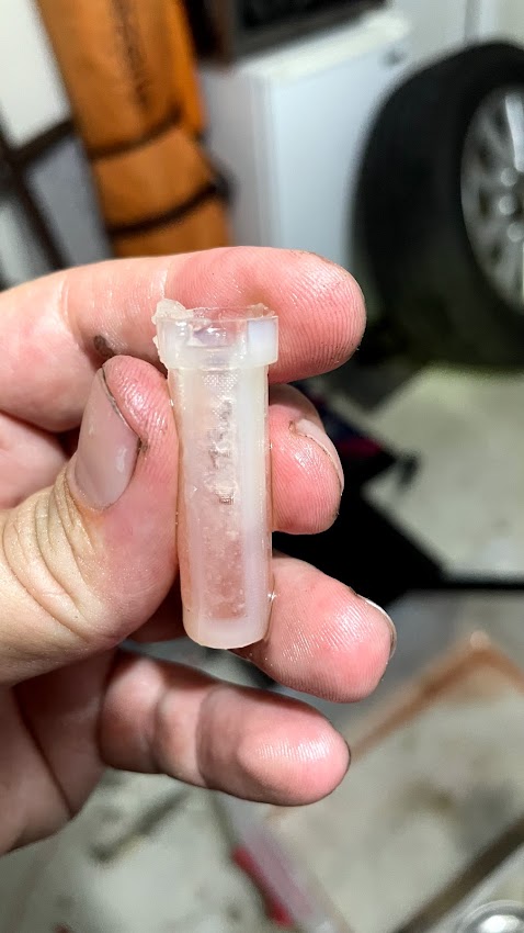

I cleaned the pump and it is/was operating as it should. Awesome! So I re-installed the pump/reservoir and began refilling the reservoir, but this time WITH THE FILTER.

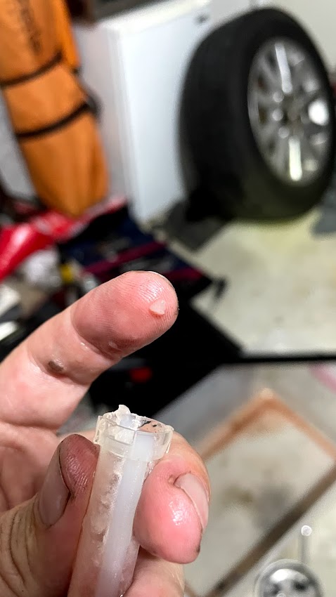

Then I noticed this moving through the tube...

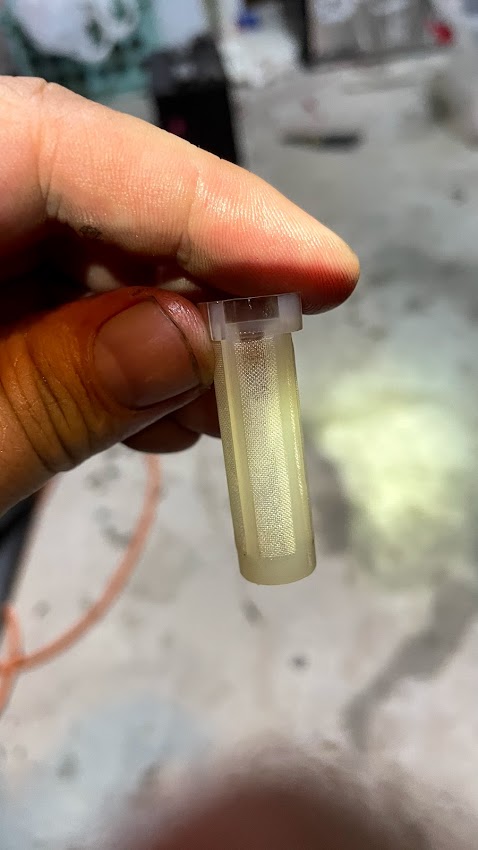

So I stopped and pulled the filter in the filler neck. It was filthy with some kind of jelly-like substance. I cleaned the filter (see clean filter pic below) and started refilling the reservoir again. After what was maybe less than a cup of fluid I pulled the filter again (see nasty filter pic).

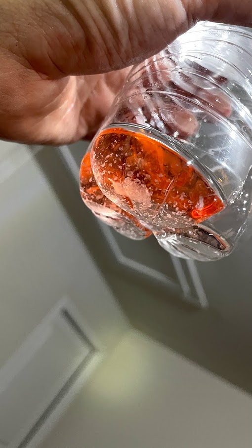

Poured what was left of the bottle into an empty water bottle.
This was from a brand new sealed AHC bottle purchased from a Toyota dealership.
Not sure where to go from here. The filter in the filler neck seems to be filtering this crap out but I'm not sure if I want to put another bottle of this in my reservoir (right now it's lower than max)

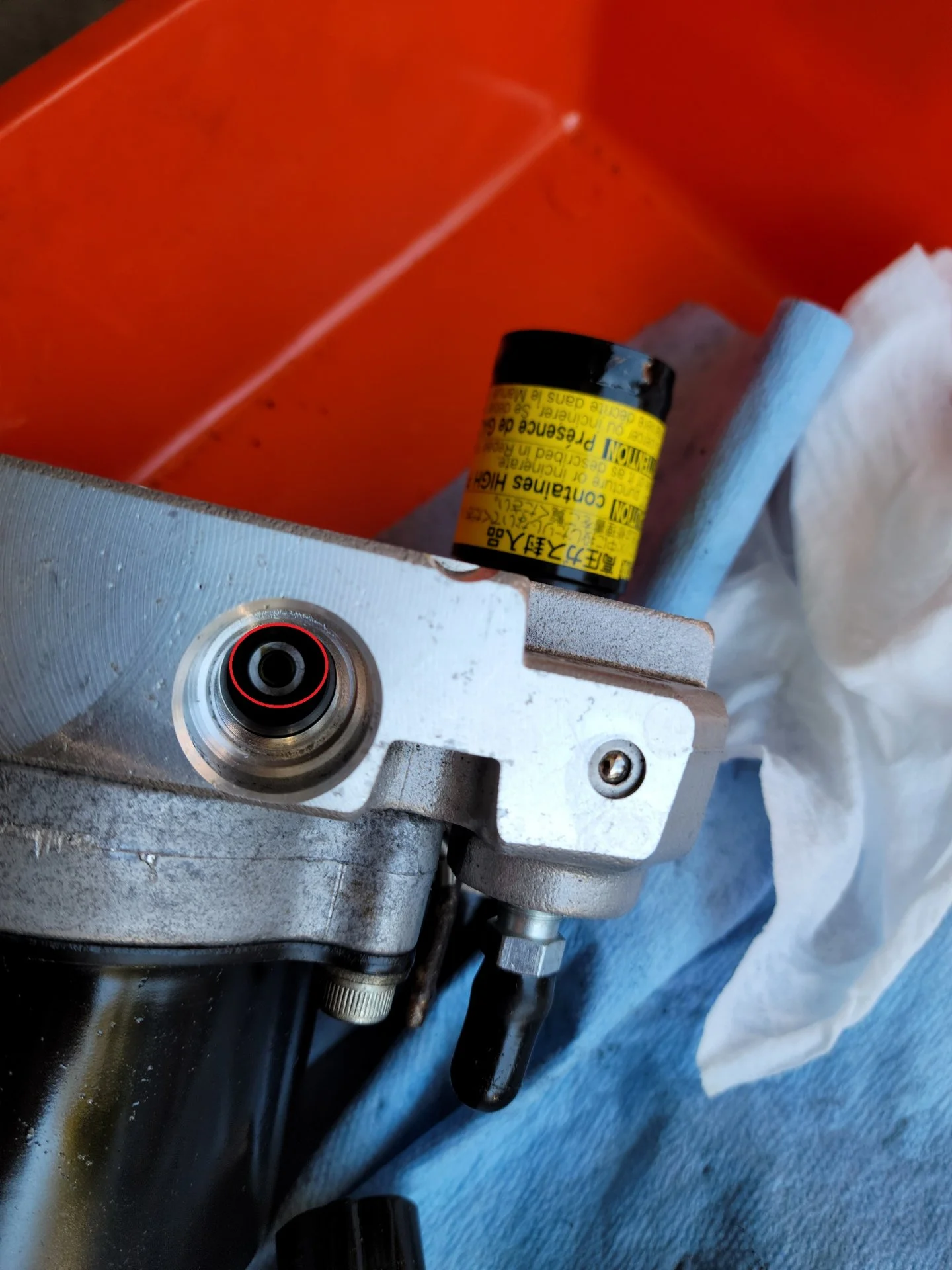

@runnerxa did you clean the third filter? It's under the large hex on the bottom of the pump housing, the filter itself is rather hard to get to.
Are you referring to this one (circled in the attached photo)? If so, yes. Not sure what that actually does, it is plugged with the hex bolt and goes no where.

Will low pressure air work in cleaning the filler neck filter (without damaging it)?
I gave that a shot but the debris was a bit too gummy. I used degreaser and the brushes I linked. The jelly really reminds me of plasticizer.
I turned the filter upside down and shot it with MAF cleaner, that did the trick.
