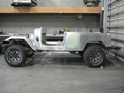

Check out Aqualu they make a fj40 body that will bolt onto a 80 series chassis. 80 series chassis is wider than the stock 40. Aqualu makes a custom wide body 40 to bolt onto the 80 chassis.

Using a different body and frame. I would sell the whole 40 and start from scratch. Would come out ahead selling and sourcing the body parts you need.
While the Aqualu 40/80 body is pricey, I think it’d definitely pay for itself in the long run. Personally any concerns of keeping it “original “ are out the door in this type of build anyways. The aluminum tubs may not be true original, but they have advantages over the old steel ones: sheer strength, clean slate, no dents and already widened to fit the 80 chasis.

Yep that’s a problem, also found that those tubs are 63 3/4”. So would be better to use my 70 fj40 and cut the 80 frame down. I can title it as the 70 and dodge the airbags. Sounds easy if you say it really fast
