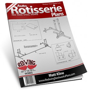

I just built this rotisserie for about $600 in materials from the free plans from Red Wing Steel WorksI agree hard top for sure, I have a best top for my cj5 windows are junk and the threads are worn out. The hard top is still spit spot. I’m selling the cj5 to get a rotisserie and materials.
lol I was zooming in on the rotisserie until I saw the 4 door, that is beautiful! Thank you for the plans, I’m definitely doing that, beautiful welds looks great. How do you think the fenders would hold up to gravel and rocky roads on a consistent basis? I know our aluminum boats get hammered on them. I really like the the four door but I need to keep it as short as I can. Maybe one for the Mrs? And a great big thank you on the plans, I was about to blo 3600 bucks.I just built this rotisserie for about $600 in materials from the free plans from Red Wing Steel Works

Auto Rotisserie Plans - Red Wing Steel Works
Below you will find the auto rotisserie plans with a capacity of 3000 lbs. these auto rotisserie plans are the end result of many days and hours of trial and error to get the perfect balance of usability vs cost.redwingsteelworks.com
The plans were fantastic.

Very happy with the rotisserie compared to the northern or harbor freight I would have ended up with.
