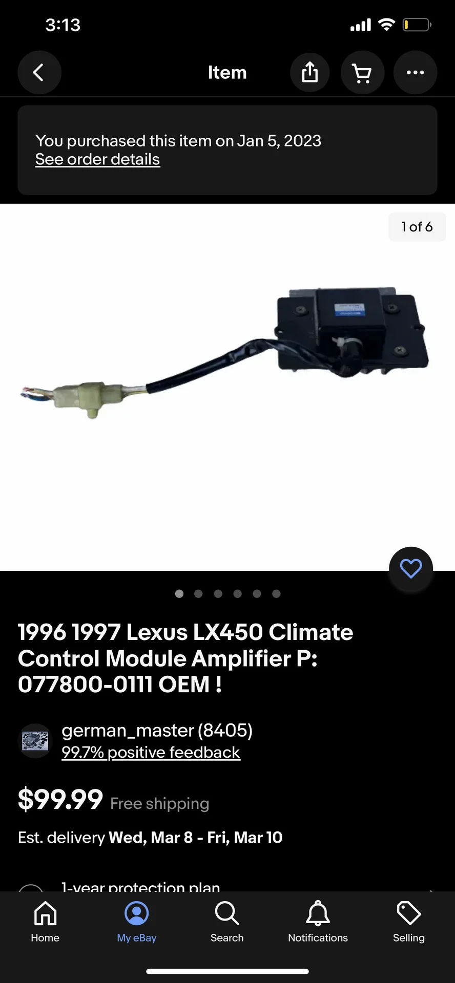

I used to have this problem. My fix was this guy. Had to buy it used, but it now works!
