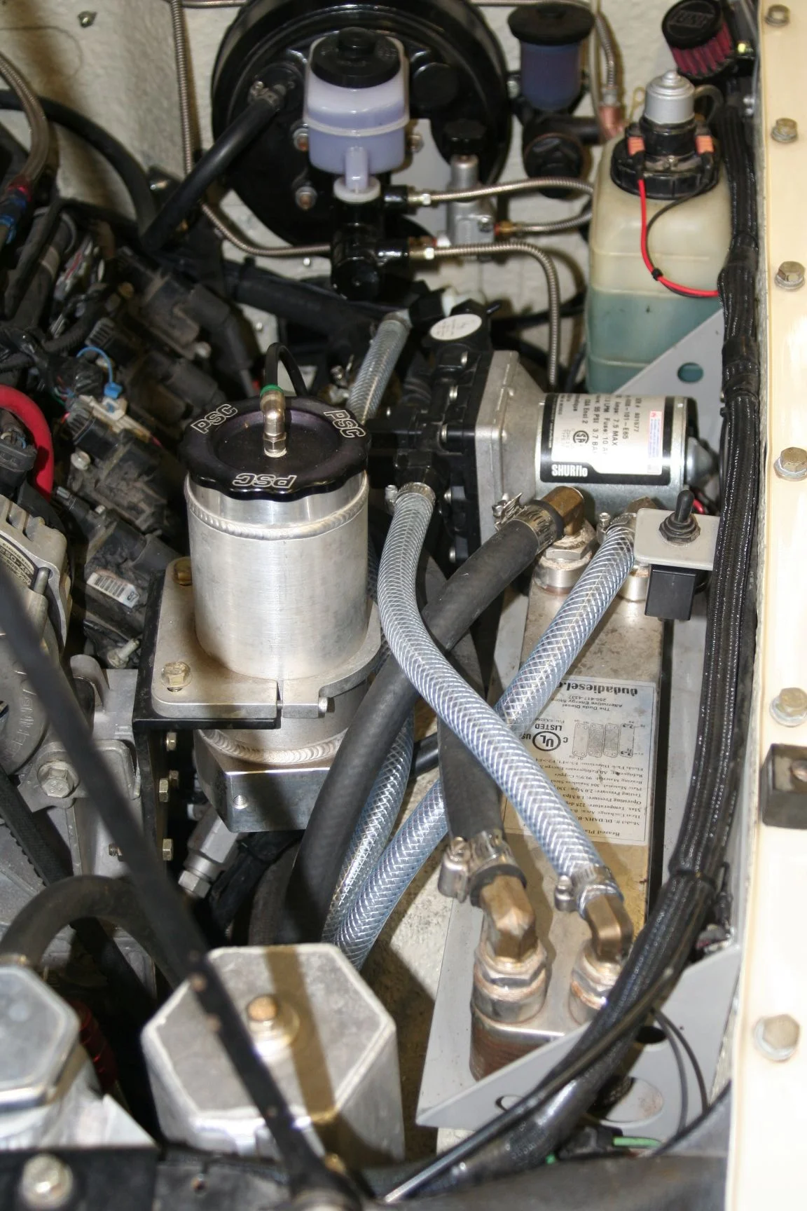

I have a 10 plate heat exchanger , that doest of course heat up the water instantly .
but I have made a closed ciurcuit so that the same water will get warmed up at every cycle -
I can do this while driving , and heat up 35 L , to the temperature I like .
this system acts also as a extra cooler for the motor .
Bye Renago
I'm using a 20 plate exchanger and if the motor is hot then the water gets too hot quick. I have to let it cool a bit before using. After a day of trail rides or getting to camp, by the time we set up the shower, etc. the water is perfect.

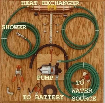

My original lusted for one was here, but out of production now
[ATTACH type="full" alt="1897215"]1897215[/ATTACH]/[img]
[B]R&M SPECIALTY PRODUCTS" vehicle mounted camping shower system.[/B]
https://www.hotcampshowers.com/vehicle_mounted_shower
