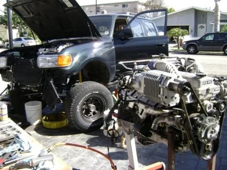

This was yesterdays project. I finally got to the point where I could do the actual swap old for new. The old engine had a bad wrist pin after a valve job and HG tightened up the top end. I acquired a new (0 mile) engine complete with blower (prior to buying the 94 Green 80). Time passed, backyard landscaping projects to keep the :princess: happy took priority.
So, Saturday was the day and I was watching the weather and looked like I'd have most of the day w/o rain. Well, it came in a little earlier than I thought, about 1:30 it started sprinkling but we kept up with it because the engine wasn't even out at that point.
With the help of my son and his buddy, we pulled the old, swapped over some parts from to the new, stuffed it in and the patient is currently resting comfortably til I can get back to button it up. I figure the better part of two more days and it'll be good as new.
In retrospect, if I had to do it again, and I had a better hoist (not a rental), I would probably have pulled the engine/trans as one. Likely easier in the long run but very difficult in my circumstances.

Here's some pics. I'll post more if anything interesting pops up.
First one, the weather is great, second one, not so much.
A new, 0 mile engine w/ a supercharger!?! That must have put a serious dent in the ole' billfold.
WOW, heart transplant in the drive way. You are Da Man....
Congrats on the new heart!
I've done several in the driveway but this was definitely the toughest! I can't believe how hefty that engine is.

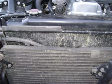

Check this out. I disassembled the front thinking I'd need all the height I could get in a truck with 6" lift. The only thing I didn't completely remove was the AC condensor. Just really loose. Anyway, check the radiator and all the fuzz on it.
You can't see this just by looking at it, only when I had it all exposed could I see this. Looks like it blocks a lot of the radiator, undoubtedly blocking airflow, probably running warmer than normal.
