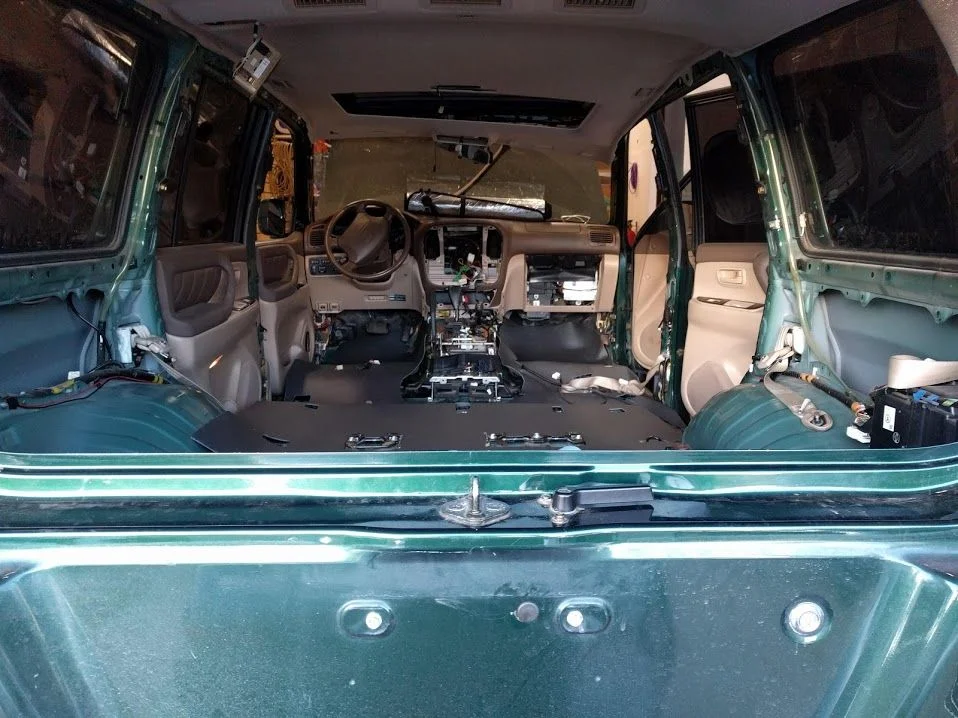

I just removed all the interior of my 99 (and installed sound deaden-er throughout) and reinstalled.
The headliner is the very last piece of interior to come out. It requires EVERYTHING else to come out first. You could probably skid a step on some lower panels if you could bend them out of the way, but I wouldn't do that.
It's not terribly hard, just time consuming and likely to cause damage unless you have a set of interior removal tools. The 100 is really nice in that most the panels are held on by plastic clips and everything just pops on/off with an interior trim tool. I only lost/broke a couple clips in the whole ordeal.
The carpet is about the only thing you dont need to remove to get the headliner out... but you need to do the carpet too, so you'll just have everything out, haha.
Get a set of trim tools like this if you don't already have them: https://www.amazon.com/MICTUNING-Removal-Molding-Fastener-Remover/dp/B07917TDL6/?tag=ihco-20
I think with a philips screwdriver, a torx bit (T20 maybe?), a set of trim removal tools and a 14mm and a 10mm wrench you could take apart all of the interior in an afternoon. You'll need a full garage space to store all the panels out of the car. It's a lot of plastic.

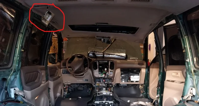

bump from the dead. did you need to remove the seats to remove the headliner as well?
Oh god. Do the seats have to come out?
Good. Sheesh! I don't have the room in this apartment for all the seats! Unless I made a movie theater setup... hmmm...
Thanks xD
