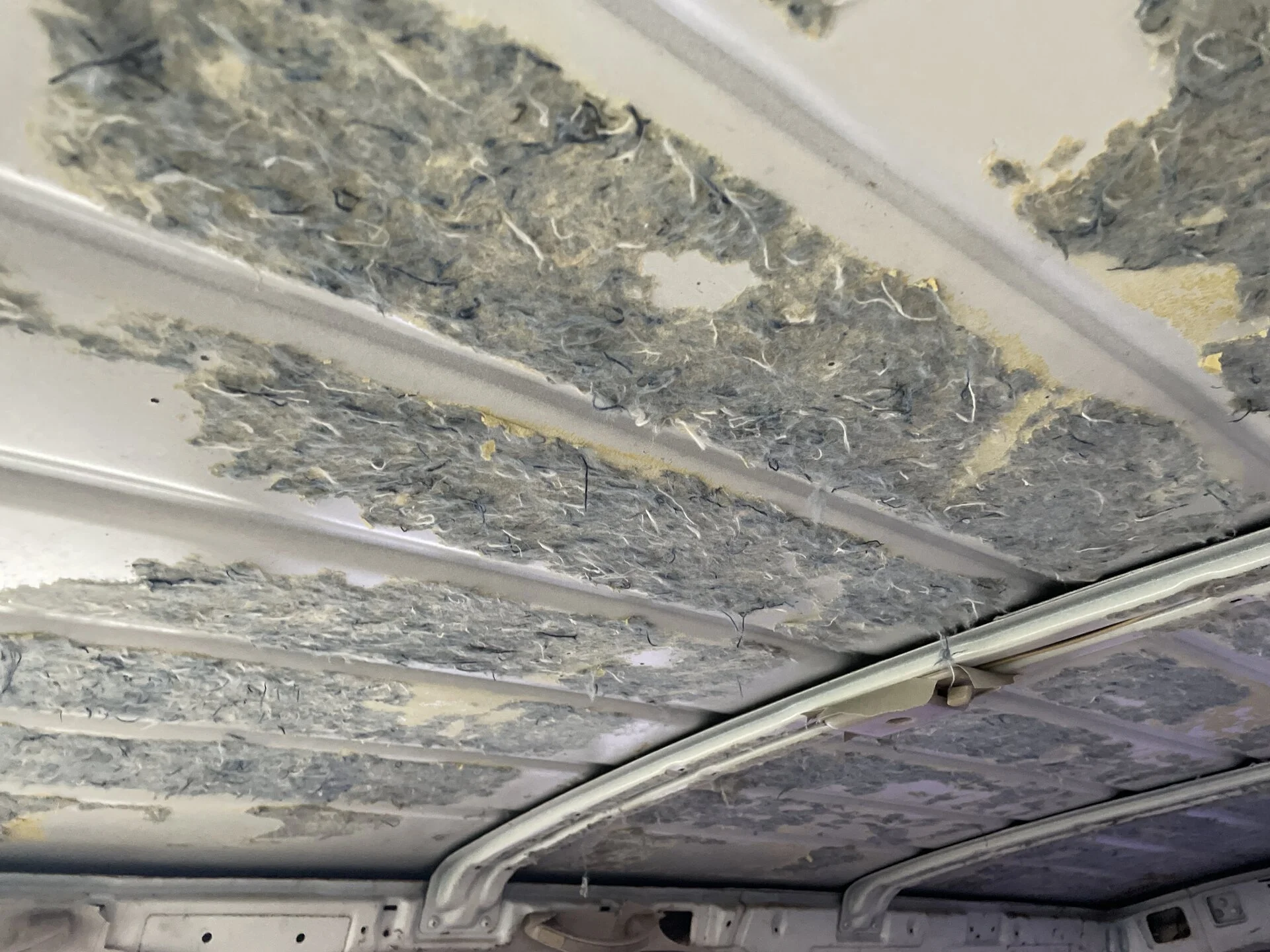

Hey guys I have removed a lot of it but how do I get this nasty glue off!?
I’ve been using a scraper tool. Fj60 1984
I tried all the chemicals... acetone, wax and grease remover, thinners.. nothing worked.

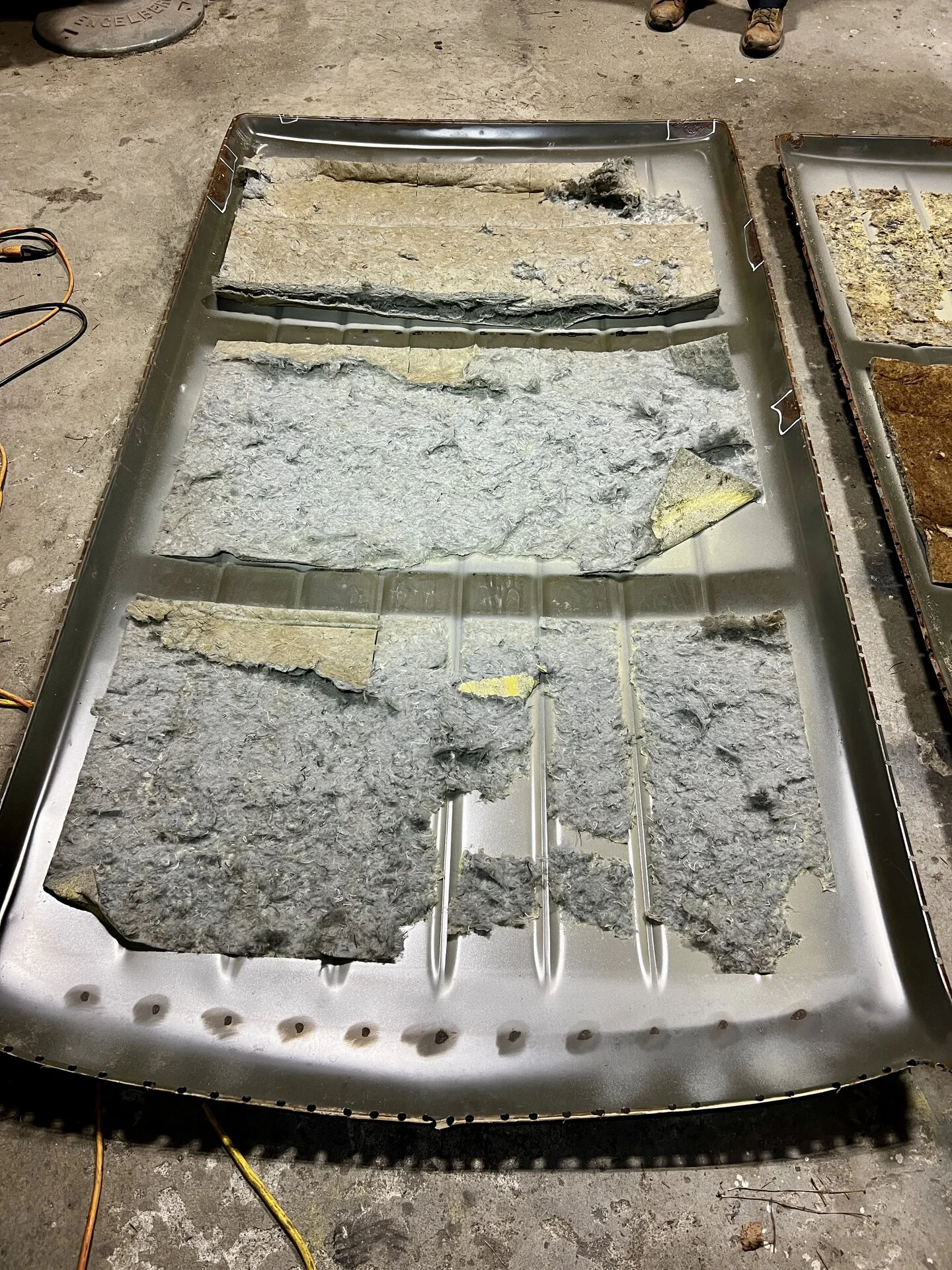

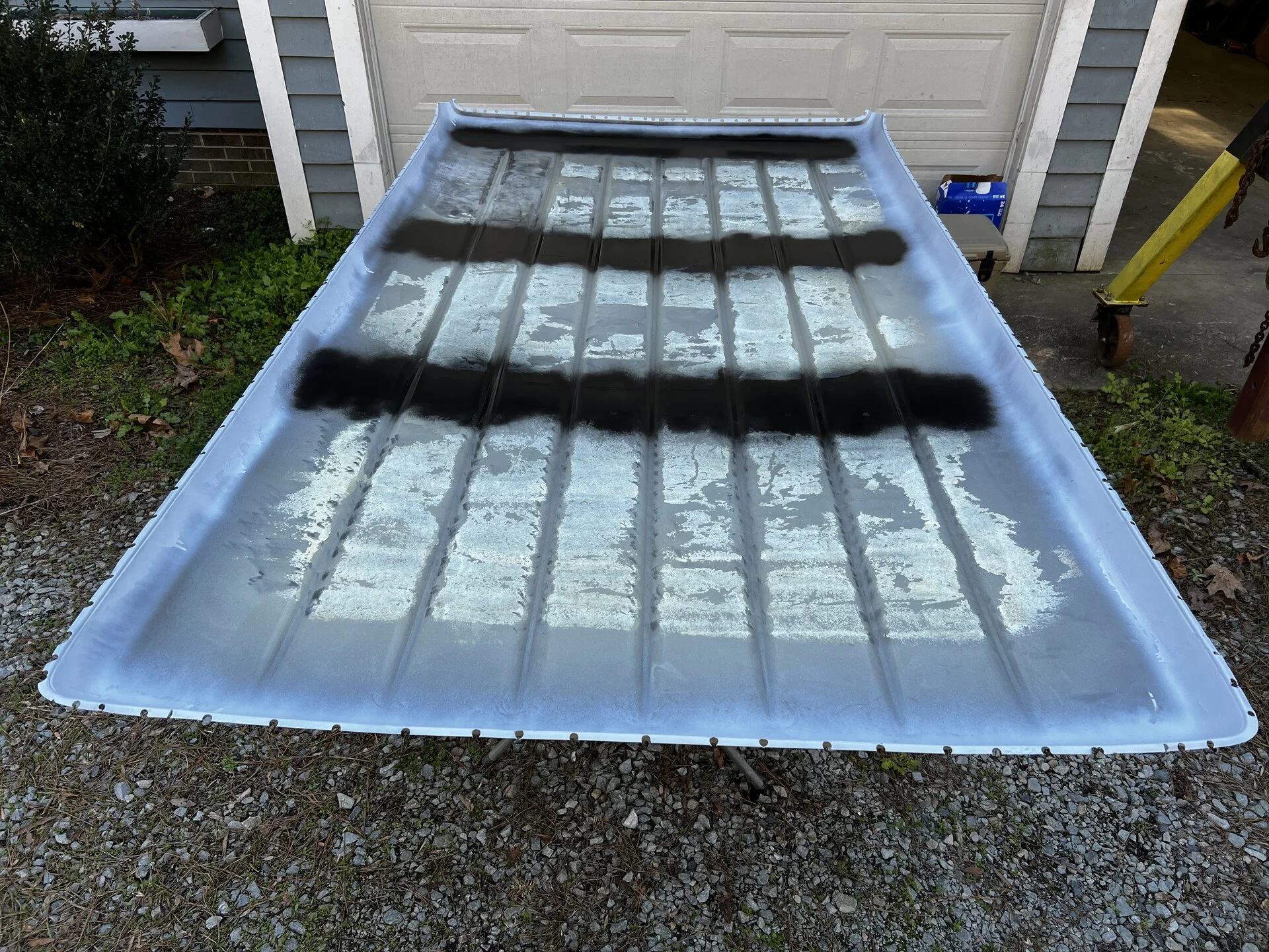

I ended up taking it off with a cup wire wheel on an angle grinder. Unless your prepared to go to bare metal you wont get all the glue off, but you WILL get all the insulation off and the glue thats left will be clean and strong and well capable of taking another layer of glue on top for your new insulation/deadening.
I used a wire wheel on a drill. It was nasty, wear a respirator.

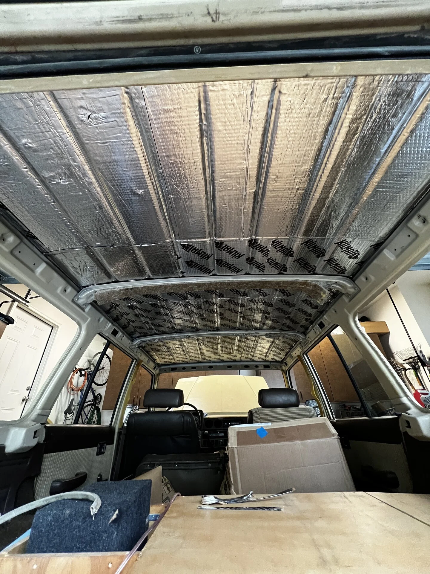

This. I did this when i had the skin off for my roof repair but wire wheel took care of all of it in like 2 minutes. Finished off with some butyl sound deadening. Made a HUGE difference in cabin sound reduction.

It’s in my build thread in my signature but my signature also has a thread specifically for removing the roof skin.
