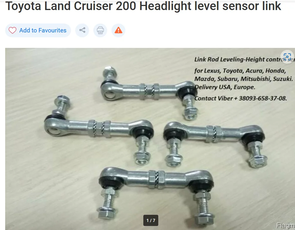

Longer Sensor Link
On lifted vehicles the light level sensor at the rear suspension driver side may need adjustment or an extended operating arm/sensor link, like the picture below. Not saying this is the preferred part, just an example. You would need to search this forum and the internet for the best product.

Longer Sensor Link
I have a Bilstein lift on mine raising the front about 1-1/2” to 2” so I’m sure that definitely affects the angle at which it would hit an oncoming vehicle or one that I’m following.
Seems looking into one of these aftermarket adjustable light sensor links is the way for lifted LC's. Be nice to get input from other MUD'ers who have done so.

Your lift makes it seem like you have your brights on. Grab one of those adjustable links and it should get a whole lot better.
