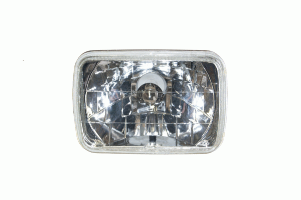

i went with euro lenses (Susquehanna MotorSports - High Performance Vehicle Lighting and Competition Accessories) and hid setup (www.ddmtuning.com , they are pretty damn cheap but i have had no problems with them so far in three vehicles for the past year). h4 hid kits come with an "upgraded" harness. the original plug for the lamp is used only to trip the relay for switching from high to low beams, power for the ballasts is direct from the battery. the h4 hi/low kit is only one lamp, switching from high to low changes the position of the lamp under a shroud-thingy instead of powering another lamp or filament. hid lamps give you way more lumens per watt. i have 55w hid for headlamps, and 90/130w auxiliaries, the hids easily drown out the halogens and draw a little less than half the amperage.
dot lenses are crap, they diffuse the light too much. euros are more focused, and throw a beam at the shoulder of the road (that's why sometimes rhd and lhd is specified for ordering them). you could put the biggest wattage halogens in a dot lens, and they would still suck.
Agreed. "DOT" spec lenses are very inefficient.
I have Hella DOT conversion lenses and I'm happy with them. It came with truck but I recently hit a deer damaging the drivers side. I bought a replacement from the same place Chang-kuao-lo got his. The problem I have in getting the Code E lenes is the Department of Transportation wants to see the "DOT" label on the lenses at each inspection here in Texas. Everyone I have talked to have liked the Code e lenses and I agree it's a much better. So I may still be getting them in the future. Check your voltage at the headlight connection and than check it at the battery while it’s running. That should give you an idea where you stand as far as how much more voltage you will gain if you went to the "upgraded" harnessss. You can make you own harness for a lot less just make sure you use a relay for each side.
