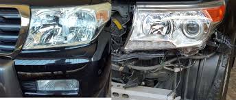

Hey, I'm a college student looking to continue modding my 2000 Land Cruiser and thought that set of new headlight would look great since mine are a bit old and not working as well. I was hoping if anyone knew of some headlights that would fit that car and were maybe more modern looking with halo running lights and such!
something of that look in the picture I'm attaching!
Thank you!

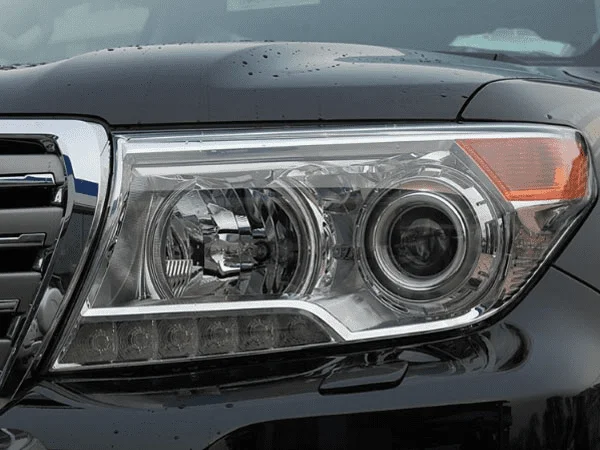

The exact ones you posted in your pics are actually headlights on the later model 200 series which are different. I've never seen 200 series headlights on a 100 series but maybe someone out there has done it that I'm not aware of. The big difference (other than dimensions which I'm also unsure of) is the side of the light that contains the turn signal that wraps around toward the fender. On the 200 series pics you posted its just the little orange 'ear' at the top part and then it reconnects with the main section of the headlight about halfway down the side. On the 100 series the turn signal takes up that entire side portion. Also the inner portions of the 100 series lights that snug up next to the grille are convex, while the 200 lights are concave.

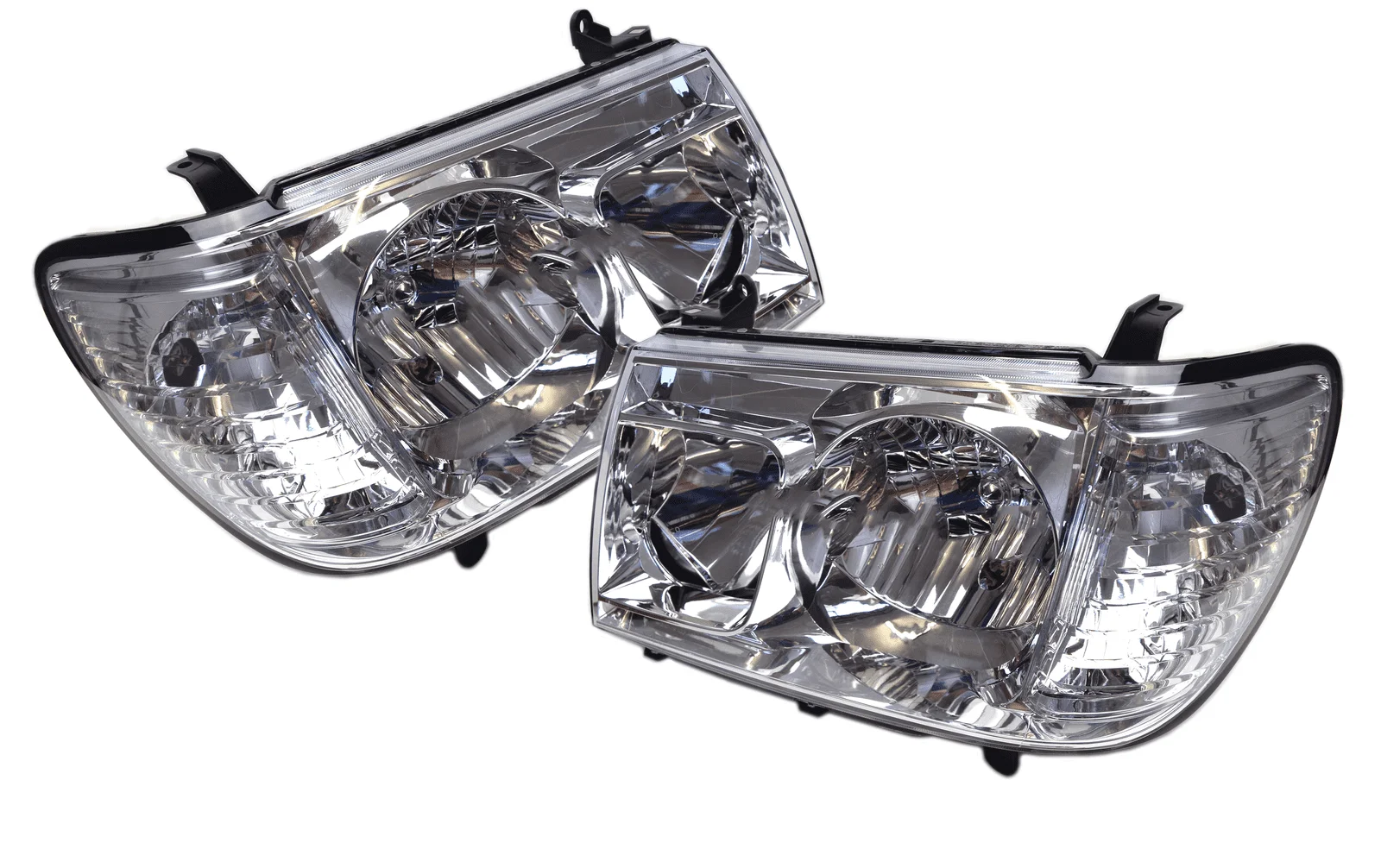

100 Series Headlights (these are the clear DEPO lights; I run these exact ones on my truck and love them they're my recommendation)
Versus 200 Series Headlights (note the difference in turn signal shape)

98-02 has one set of lights. It is what you have on your truck that is a two piece bezel. The two pieces are the main headlight buckets and then turn signals.
03+ have a one-piece design (like what @TheForger posted) and takes a bit of modification (slight) to get it to fit into the earlier year models.
