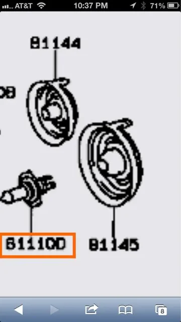

I just went to install HIR bulbs in my stock housing & found the PO had broken both PS & DS bulb retaining ring thingy's. I don't know what they are called but they are round, black, have 3 slot cut-outs, have 3 screws & the bulb 'screws' into them to hold it in the housing. Does anybody know the part number or name of this piece?
I've searched google for hours & have not came up w/much except it appears it's called a headlight bulb retainer. Can't find 1 for a LC or LX450. ANY idea where I could get a part number for this piece?

That?
Fat-fingered on my iPhone using IH8MUD
81144 COVER, HEADLAMP, NO.1
90075-99028
81145 COVER, HEADLAMP, NO.2
90075-99027

I found that but I'm thinking that only consists of the part that bulb retainer screws into, I could be wrong though.
Well I ordered 2 of the 90075-99027's. Hope they include the ring that the bulbs twist lock into!
Got them today & they do NOT have the plastic rings that the lights twist lock into. They are just rubber boots. Any other input would be great!!!!!
Yep, that's it!!!!! Mine are broke into 3 pieces each. So I can't buy them new? Any idea what it's called or where I can get 2 of them for the low beams? Thanks!
