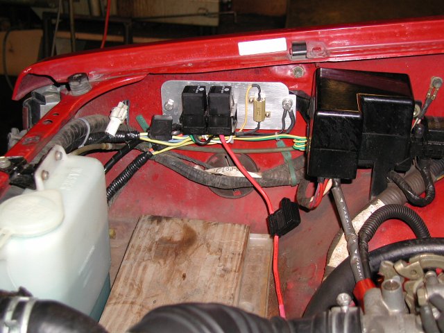

There are 2 issues that contribute to the poor headlight output in these trucks: crappy DOT sealed beam headlamps, and pathetic undersized wiring in the factory harness. I fixed both, it was not cheap or easy, but it was definitely worth it, HUGE difference.
Headlights: I went with Hella E-code headlight assemblies, with 55/100W H4 bulbs. Very nice pattern, excellent cutoff to the beam, and the high beam is awesome. I bought mine waaaay back in 2002 from what used to be Susquehanna Motorsports, now they are rallylights.com
http://www.rallylights.com/all/h6545-hella-165mm-ece-hi-lo-h4-conversion-headlamp-kit.html
I did a lot of research on wiring harnesses, ended up home-brewing my own, from parts I had in my bins, and stuff I had to order from Waytek Wire. Comes right off the battery, #12 wires to each headlight, separately fused & grounded, only uses the factory wiring to trigger the relays. I'll try to find my hand-scratched out wiring diagram, maybe post it up.
