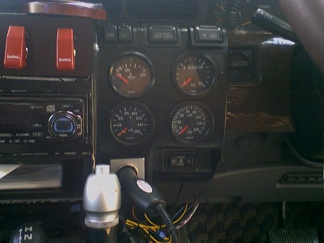

I like the VDO gauges. Very easy to read, and nicely back-lit (with a red needle that lights up).
Here's a pic of my gauge cluster. Boost pressure, tranny temp, EGT (pre-turbo) and onboard air tank pressure.

redstang410 said:
I just put these in, Got the pod locally at a Ricer store...;p
Nice gauge install! But the things that many of us will drool over are circled in red below.
Also, is that the control for a PTO winch?
Thanks for the pics, -Steve
Thanks for the compliments, Yes that handle is for the PTO winch. I love that thing. Never quits and can be as fast or as slow as I want. The other switchs are for the rear A/C and Secondary Tank. It also has that little refrigerator that goes under the armrest.
Most of the VX cruisers down here have those options . Though the winch option is pretty rare. Which is the main reason I bought it. Tapage is a buddy of mine, and his 80 also has the rear A/C, subTank and cooler. But his is automatic. Its super Clean.
