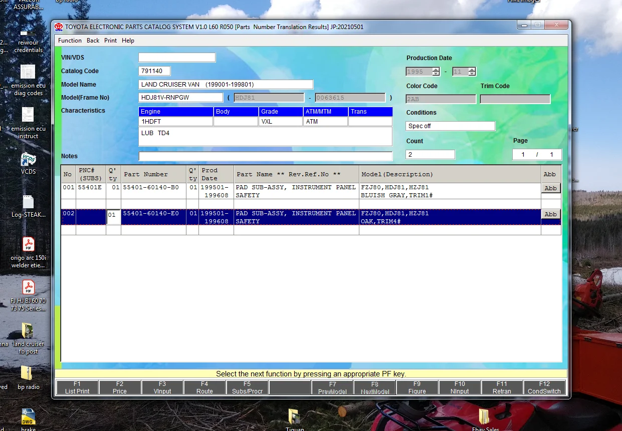

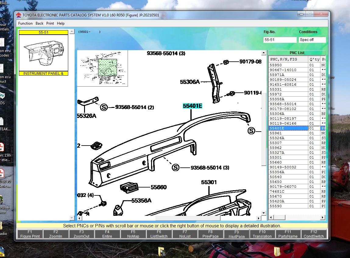

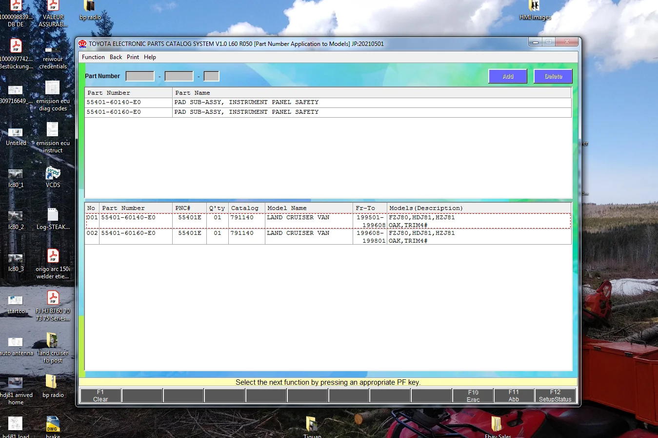

Using the EPC, i was able to find the applications to vehicule with the part numbers:

One may be LHD and the other RHD.
Cross the number into partsouq to see if it gives an alternative number.
Also, if it is gray or oak in color may be a difference.

Well i figured it out and it was pretty simple. Its the airbag slot! 95 no airbag, 96-97 airbags! So it won't be the same! Thank for the info guys! I know amayama doesnt always have everything availaible. But for that one, after 2 weeks of waiting they had told me the order was ready and ready for payment and all. Then 2days after paying they cancelled it.
