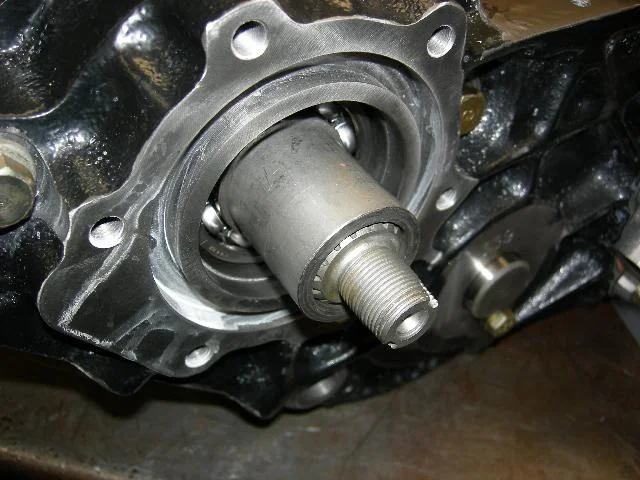

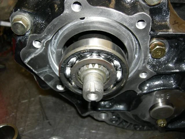

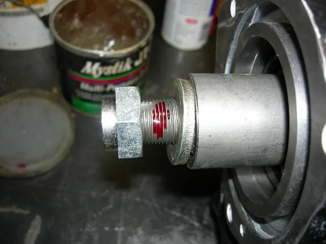

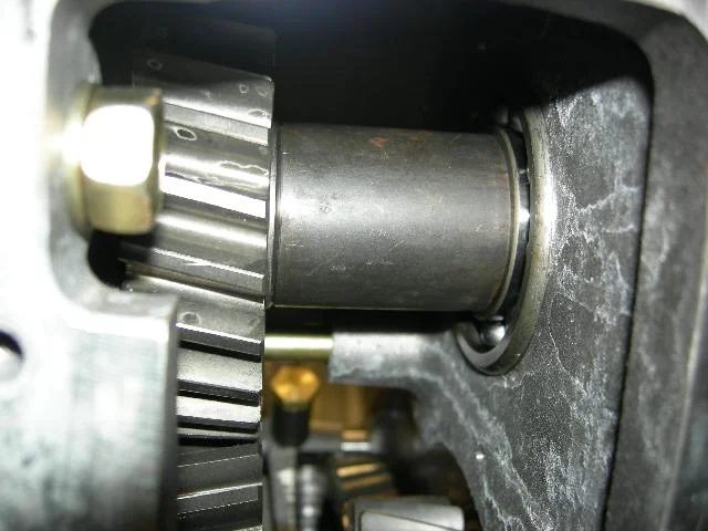

Actually, there is an additional spacer that takes the place of the rear output PTO gear on the transmission output shaft after the transmission main shaft support bearing you referenced in the transfer case and the large flat washer and nut.
This rear output PTO would bolt onto the one piece transfer case where the tin cone cover is attached. Typically, this PTO box was used to run a water pump on Land Cruiser fire trucks.
