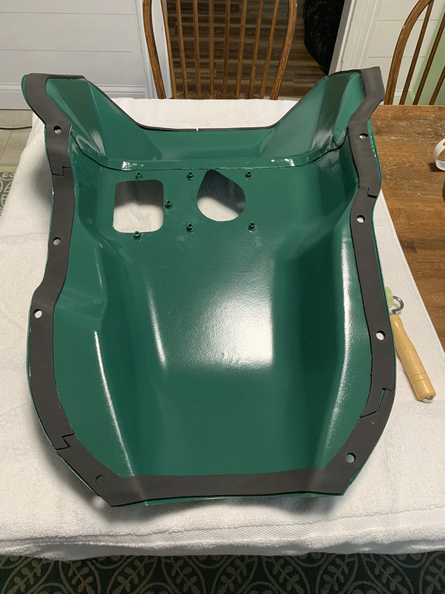

My wife wanted a ride last week. Without the transmission tunnel cover, the truck blows hot air all over our feet. No good. I want to get my transmission tunnel cover reinstalled. There are a dozen or more bolts that hold it on, each bolt with its own captive nut. Five of my captive nuts are inop; some have broken bolts in them, some have the nut missing. I cleaned out the good ones today, and chased the threads. Where I'm missing the captive nuts, I'll add nut/bolt sets where I can reach the bottom side, and do the best I can. Gonna get some solvent and clean the gasket surfaces. I have the SOR gasket kit, and am planning to get that installed. Ran out of time this evening.

I don't really know how this gasket set works. It's on release paper. I assume you stick it to either the hump or the floor.
Gasket to hump
I just did mine. Carefully separate from the main shape and then line up the pieces where they should go. Don’t peel all the paper at once and work your way around until you are happy with where it falls and then press it home all the way around.
I put my tranny hump back on. No closeup pics.

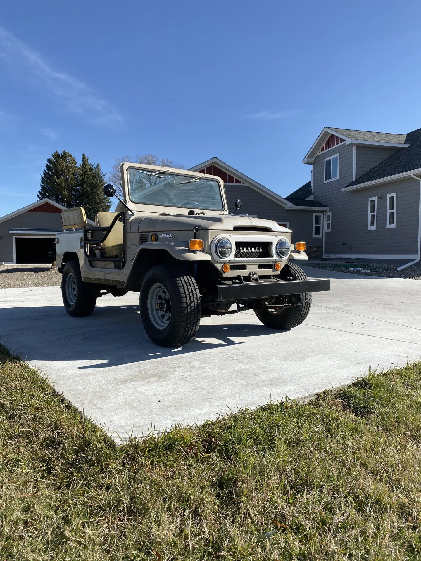

My boys had a few friends over this afternoon. Hobie says, “Dad, take us for a ride in the 40.” We loaded up, me, :princess:, and five boys. A mile down the highway is a country store. Headed there for cold drinks and a few gallons of gas. This was the first time I’ve ever driven Hard Ways at anything approaching highway speeds. She wanders just a bit. I think my toe-in needs to be tightened. In other words, I think it needs to be toed in a bit more.
The front axle was all rebuilt. All new bearings. It has new tires, new spring bushings, new shackles, new tie rod ends, and Mark tightened the center arm when he was here. What else could I look at to stop it from wandering?
A man at the gas pump was asking me about the truck. He really liked it.
