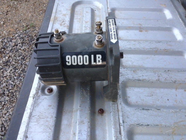

After a year of being on the truck and a few, short uses my Badlands 9k has finally stopped working. Hooked up the newly bought wireless remote and tried it. The motor started to engage then stopped. Followed online procedure and motor does not respond. Don't know if I should tear it apart and try to have it fixed or just move on to a Warn????

Took motor off and dropped it off to get fixed at the local industrial electrical repair. They got it fixed, but it was due to water intrusion that ruined a bearing and rusted the brushes. Cost $155 to fix.
Wonder if this going to be an ongoing problem???? Is this winch more susceptible to water intrusion?

Meh, I have my fair share of water crossings and opened up the winch about 4 months ago to find that the winch was very clean and dry inside. I wouldn't say that they are more susceptible to water intake than any other winch, such as my smittybilt for example, which was full of water and rusted and ceased to stop working when I got stuck in water. Obviously I let it sit for a while for the rust to build up.
I have had it underwater for a while, and it was dry when I opened it up.

Got it back from repair and it it works again. I couldn't figure out how to open the gear side, so I just reassembled and reinstalled. I will plan to open it up after deep water crossings and drain it.
Note the smudges all over the bumper. That is from my 2yo helping me immediately after eating something chocolate.

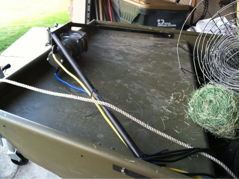

3000 lb harbor freight winch. $160 +/-.
Worked great so far for 20-30 pulls getting the river survey boat on the water,
Steep banks where no boat ramps.
