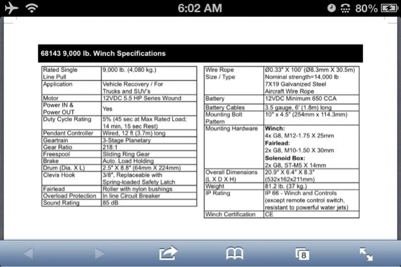

First question is... would you get the 9000lb winch or the 12,000. I am not really in a hurry to get the winch and may catch the 12,000 on sale for close to the 9000.

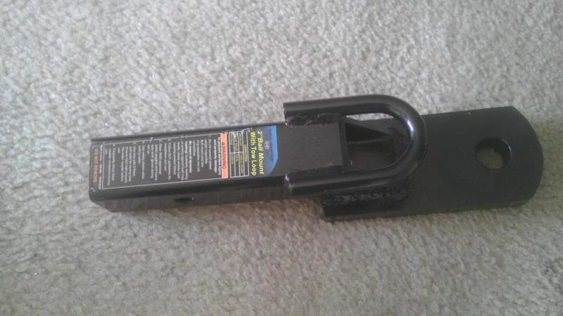

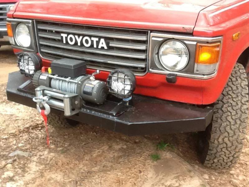

2nd question is would you trust the harbor freight hitch reciever mount with the 12000 lb winch? I have the hitch receiver thing in the picture and I imagine that with some creative welding I could come up with something that is stronger than the HF piece.
I would mount a hitch receiver to the front on my cruiser so that I could pull stuff from either end.

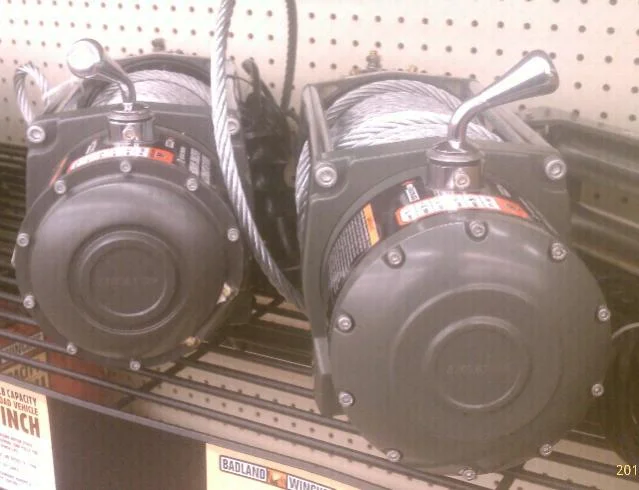

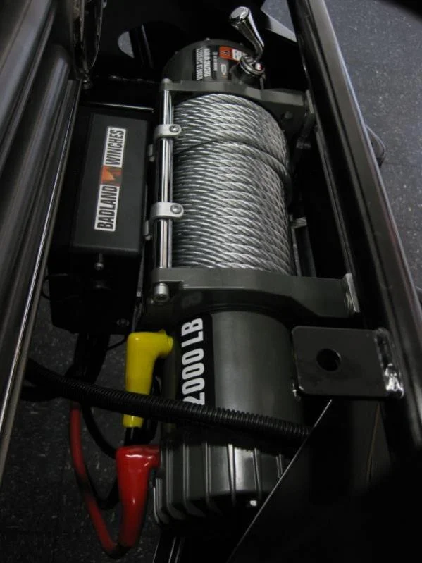

The 12K winch is significantly bigger than the 9K. I usually buy the "biggest and best" model, but the rope on the 12K was just way too big.
With that said, I have it mounted on my trailer and was quite impressed by what it could do.
It pulled a civic straight up the ramps with all four wheels locked up no problems.

If you haven't seen them in person, go to a HF store and actually look and compare the two models.
It's been a while since I was in HF, but I remember the 12k and the next size down being the exact same size externally. Just a heavier motor and bigger cable.

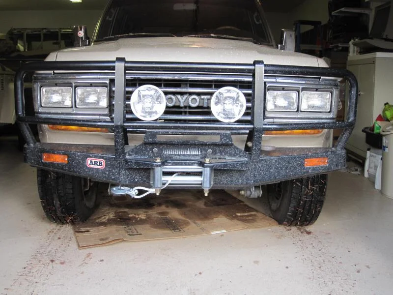

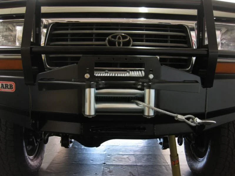

The wire rope is really stiff, as previously mentioned. I have a Warn 12k lb on a 40 and its wire rope has a smaller diameter. Does anyone know, or where would a good source to find out, what size wire rope would be a good replacement for a HF 12k

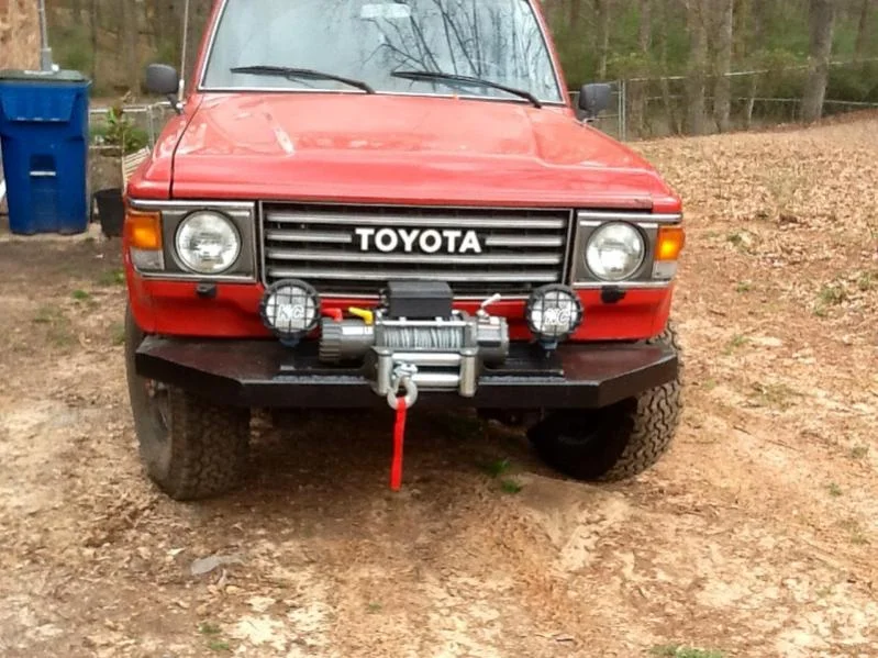

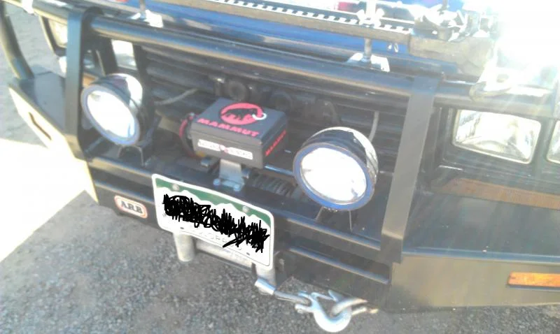

Badland winch installed, and it looks great. I'm very glad I got to save some Benjamin's with this purchase!!

James - if sticking with wire don't go smaller than 3/8". As a comparison the synthetic line we sell is stronger by a bit and for a 12k winch we sell 3/8" and even some 7/16".

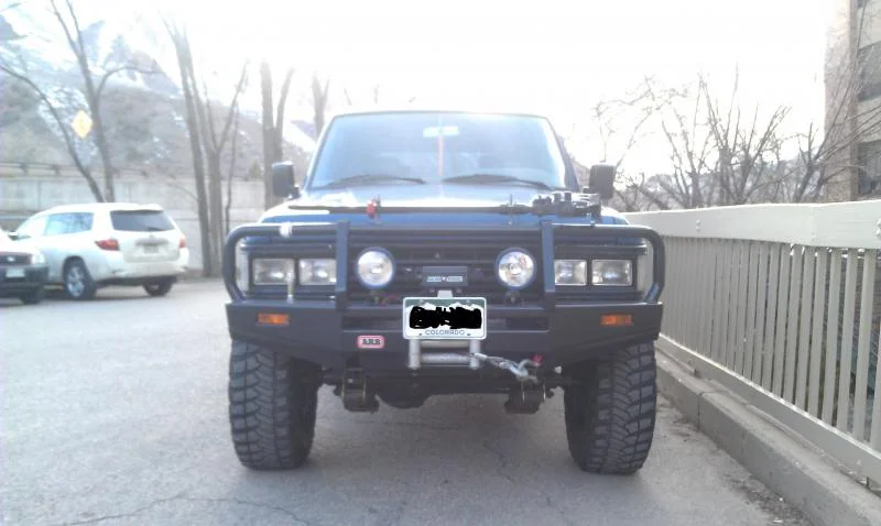

Here's a photo of my set up.

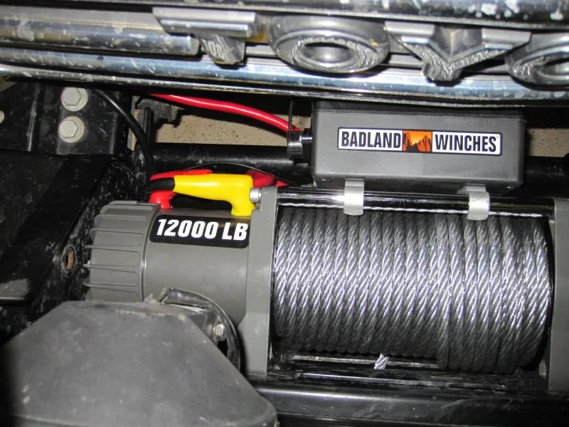

Update on mine:
Installed the Badlands 12k in April 2011. Most times, I use my winch once every other event (so, 8 or so times a year). Thus far, other than a controller connection issue at GSMTR 2011, it's worked flawlessly.
I needed it this past week while at the RoundUp in TX...I had not touched the winch since I used it in Hot Springs AR in October 2012. It worked perfectly, and drug my FZJ80 towards a wedged Jeep TJ...haha We finally used a hi-lift to jack the front end up (busted axle) and winched 'er free.
The chrome finish on the lever isn't pretty anymore (rust) but everything else is in fine condition. Despite TWO Wisconsin salt-encrusted winters...
I still have the original finicky controller. The In and Out button now sticks (ie: stays toggled) so it needs to come apart for some cleaning. Considering the lack of maintenance thus far, I'm not complaining.
