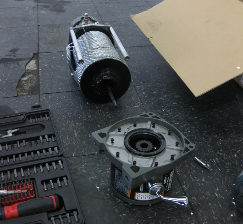

How exactly do you rotate the lever? It is different than the warn setup. I took the screwcaps off and couldn't tell how to rotate it. Do I need to take all of the plantary gears out of the end and unscrew the housing to rotate it?
edit: found my answer here
https://forum.ih8mud.com/80-series-tech/558590-need-help-mounting-winch.html
It is called clocking. You are basically rotating the gear system relative to the base(footing). Remove the 2 6mm hex, pull out the gear/lever halves. You will see 10 3mm hex, remove all. Rotate 1 slot, each slot equals to 36 degree.

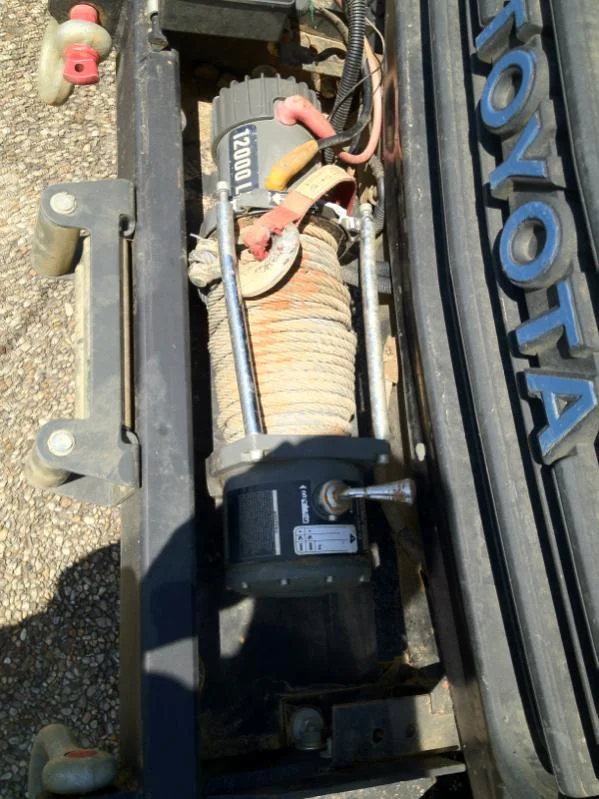

here is a couple of my BL 12K winch installed on my Metal tech bumper. fits perfectly!

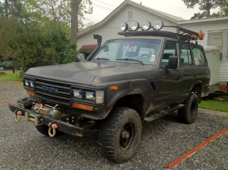

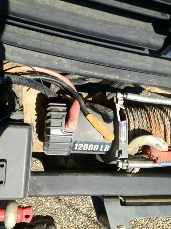

I normally don't drive the cruiser abunch, sucks I know, so after I parked this morning at school. I thought it was a good photo opp. So I took one. Well when I got back from class I walked in front and knew something was erring. Then I spotted it. So I went back to the pic I had taken this morning and sure enough. It was like that when I left. So no vandalism.
Apparently sometime between yesterday afternoon, have pics on the trailer from after trip so o know it wasnt while being used, and this morning. My winch sucked in the cable. It made it threw the rollers, under the bottom of the drum, broke the rear chrome bar mount. Then did the same with the front. I'm guessing it went at lease 1 whole cycle to make it back under the front bar.
I had the wireless box plugged in. I guess the people using the winch this weekend to recover some other rigs plugged it in after pulling out the hand held. (wireless remote battery was dead). So not sure if the wireless remote decided to start working again or if there is a short somewhere in the box..... All I know is I couldn't get the wireless to work after I found out so not sure. Now it's all unplugged to doesn't matter. :)
Havn't checked but does anybody know if this piece is available separately form HF. It looks like it is 5 main pieces. The 2 cylindrical parts on each end. Drum. And the 2 attachment blocks. I'd need one of those. Kinda sucks.... Wishing I would have bought the warranty

Cody that sucks. I bet it just caught a random signal from some other wireless source, from what I have read online hf doesn't offer much in the way of spares, but the damaged areas look to be repairable. Repairing it may be more expensive than replacing it though and if you replace it you have a spare motor, drum, line, etc.

I would check the wiring in the box to see if anything may have shorted. My guess is the remote was stored in the vehicle in such a way that the winch "cable in" button got pushed in enough to make contact. This may explain why the batteries were dead. While I haven't purchased a wireless remote but if I do the receiver will only be pluged in while being use for this reason. I do remember early in this thread there were posts on faulty wiring in the control box. The remove wiring was very light gauge and broke easily. My winch is pretty new but after seeing this post I think I will pull it apart and double check and redo it if I have any doubt.
