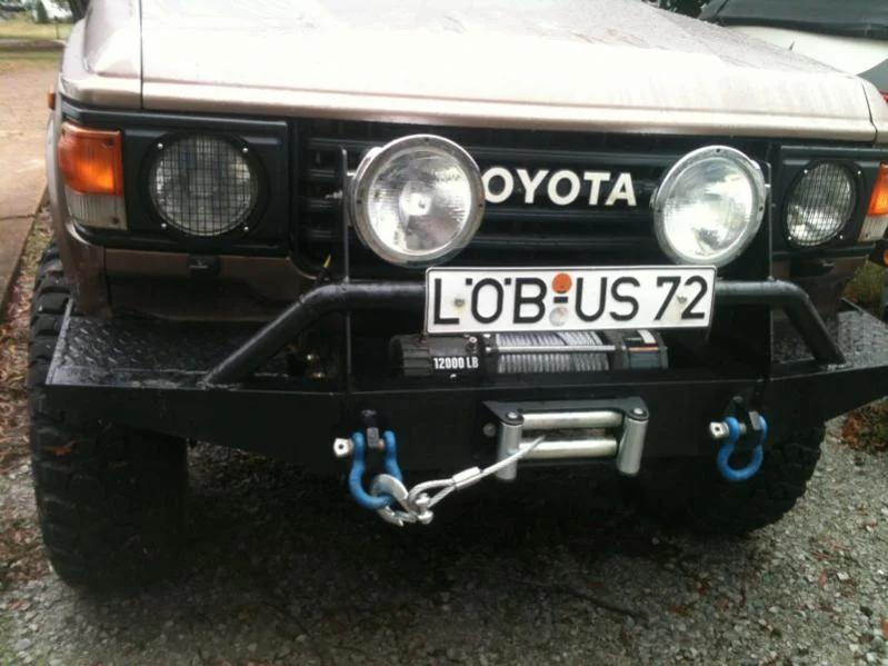

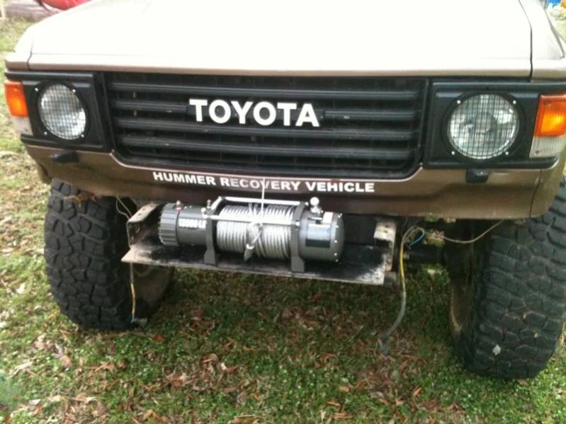

I can see the confusion, I cut some squares out of a foam sleeping pad and siliconed them in the ends of the tube just to keep water out. Because I didn't want to mess with the bull bar, I just used the 4 existing holes where the tow hooks are mounted and drilled the mounting plate to match. Those are the only 4 mounting bolts. If I didn't have the bull bar, I think I could have moved the mounting channel further twords the front of the truck. This would have eliminated the need for the 1" spacers. The bottom of the fairlead would have been hanging over the front of the bumper. If you need more pics, let me know.
Ok, I can picture it now. If it were me, I'd want the winch mounting plate, bolted directly to the frame (no spacers) and the bolts more spread out, than the tow hook bolts. In other words, the 4 bolts evenly spaced from front and rear edges of plate. Looks like now, the tow hook bolts are more biased towards the rear of the plate. When your winch is under heavy torque, you could bend or over-stress the plate if not evenly supported. If you're going to use spacers, use solid bars -those tubes look a little on the weak side -IMHO.

finally got mine put in and wired up. i'll see if i can post a video. i was happy with the install although i couldn't fit the remote box on top of the winch so i had to take it apart and modify the box brackets. will post another pic.
Good looking install is that the hf winch plate?
no, i just welded a piece of plate between the frame. i can remove my bumper without the winch coming off with it now.
