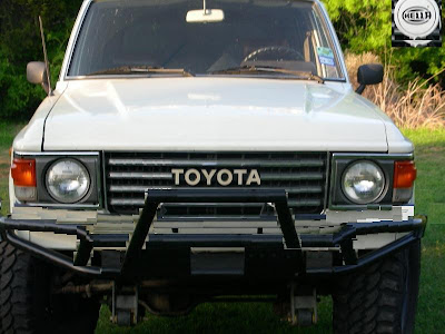

I've started looking at a high clearance front bumper. My bumper sticks out a good foot, seriously affecting the approach angle, and since most everyone wants $$$$ for a decent front bumper, I was looking at tube. Found that SROR makes one, but I'd want to change it up a litte. I've already talked with Jim to see what his pricing for both would be, just want to see if we could do it for a reasonably cheaper price. Steve, while I like your idea, I figure if it's gonna be tubed up front, might as well have a tube in the rear (boy that didn't sound so dirty when I typed it out...:doh:)
SROR's
more pics -> My new solid rock beast
My update to SROR's - bad MSPaint job, but you get the idea. I'd also want it to be a little more vertical than the one in the link

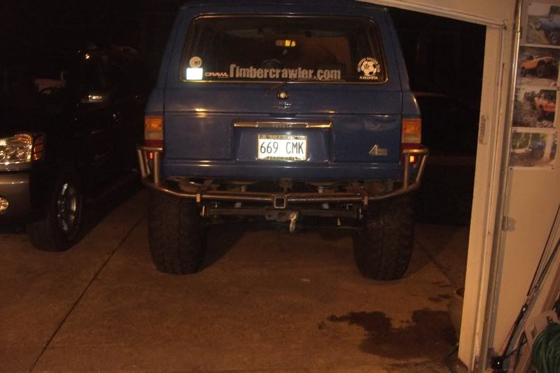

Their rear bumper
more pics/info -> SROR tube bumper kit install
