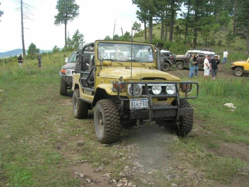

I had some tabs mounted on my brush guard for my CB and UHF (NMO) antennas. They were out of the way for the trail. For highway driving I will move the UHF to a NMO mag mount to a tab on the rollbar. On the bumper I was getting five mile range on the highway I bet a couple of feet higher will help a bit more.
