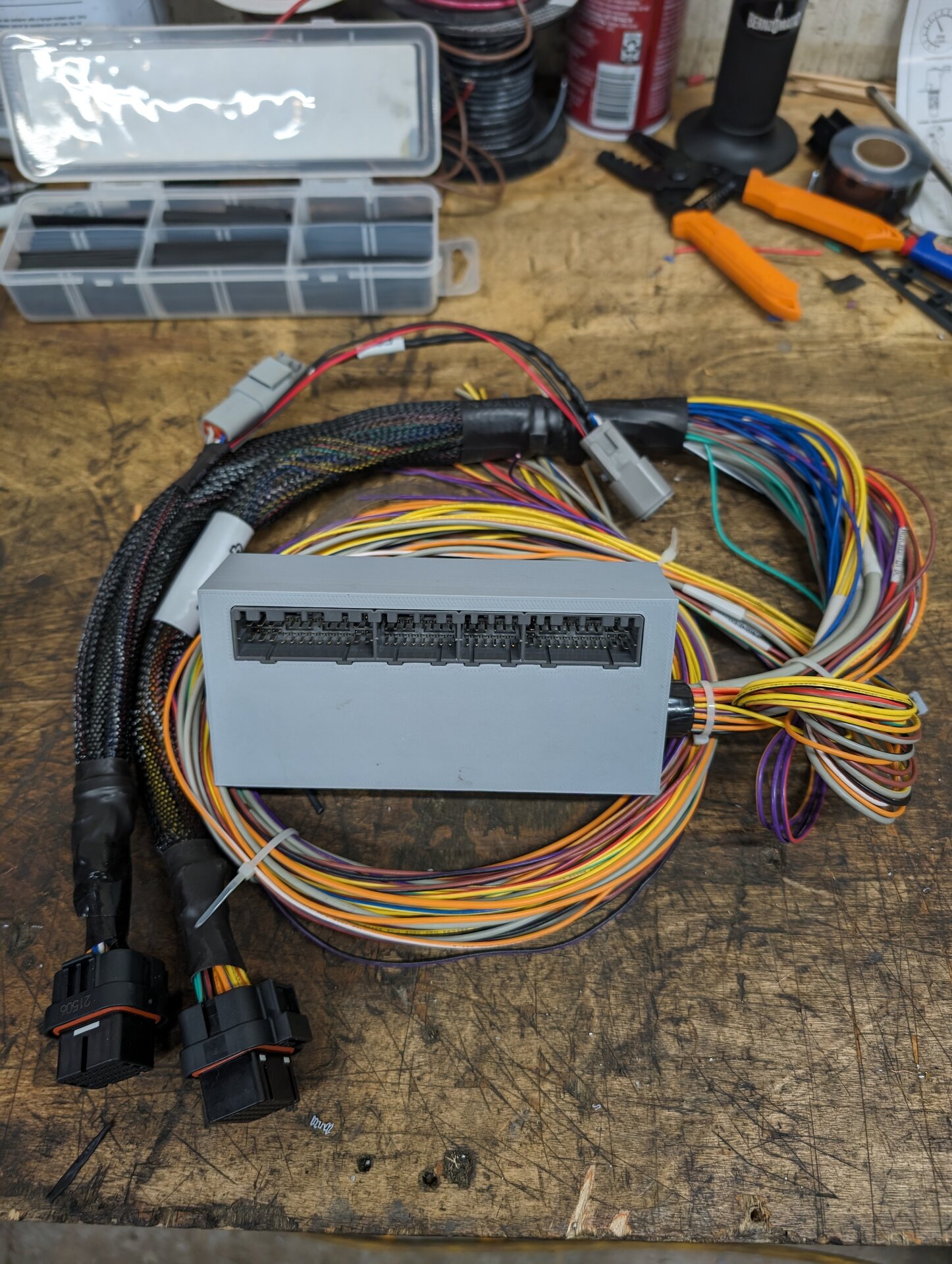

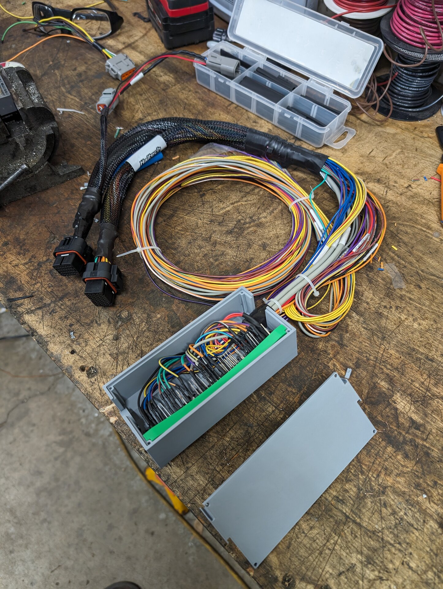

Why not ditch the afm if you are already on a haltech?Working on the TCU box over the next couple days. Have it laid out so it should be completely plug and play if I can find a matching plug for the AFM plug.
Can I ask where you get your color coded wires?
I am. I'm using some of the abandon wires in the MAF deletion for air temp sensor and fuel pump relay signal. I'm try to make this completely plug and play, so I'm repurposing abandoned wired.Why not ditch the afm if you are already on a haltech?
Haltech. I used the "basic" wiring harness for the 2500.Can I ask where you get your color coded wires?
I think he wants the side present on the VAFM not the cableOh got it. So you need this 7 pin connector?
That's kind of what I was thinking, but he said plug? Not the jack side, I think you'd have to cannibalize a vaf to get one though.. but I get what you're saying.I think he wants the side present on the VAFM not the cable
