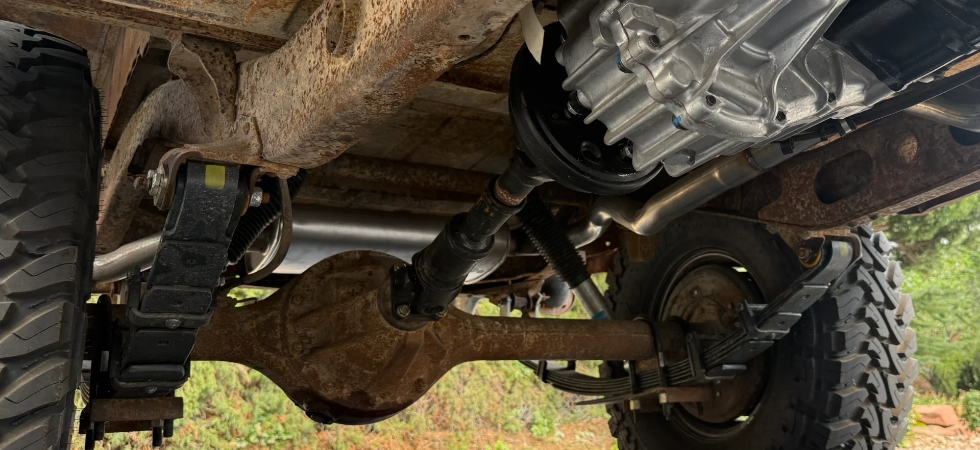

I think mine is a tad shorter. We didnt do the install on this 40, but we built the trans/tc, front disc axle, etc. So when the customer wanted to sell, I snatched it up as a fun "ranch" Cruiser. I may move the rear axle back similar to what I did decade ago in my blue 72 with the 2F/H55F
Did you do the 180 flip of the springs, or just move the whole assembly back?
Done both over the years. On my othet H55F 40, I run FJ60 rear springs for the added length and improved ride.
How far back does it push the axle and do you need to modify the wheel well with the 60 springs? What did you use for the front springs when using 60 springs in the rear. Lastly, was the springs stock 60 or lifted 60 springs in the rear?
Approx 5", and yes I re-worked the wheel wells to suit. It's been 25 years (almost to the day) that I was doing the work so the exact numbers are a tad fuzzy :D

I flipped my rear springs probably 15 years ago, when I centered the rearend and went to a centered rear output tcase. I didn't really notice any differences in ride or offroad capabiities from driving it. Obviously there was an improvement, but it wasn't anything earth shattering or noticeable. And yes, you have to cut the wheel opening. You've moved the axle back about 3".
I don't love just flipping the 4x rear springs.
In stock form, when the axle droops, the axle pivots on the short side of the leaf spring so the pinion angle increases, staying in better orientation with the t-case. Likewise when the axle compresses, the pinon angle lowers, again staying in better alignment with the t-case.
However with the springs flipped and the axle working on the long side of the spring, it's the opposite. Down travel increases the pinion angle, the opposite of the desired effect particularly with a short rear driveline and lots of flex. Totally workable as proven by the many running that but I like the 55/56 or 60/61/62 options more, but they are more work/parts too.

Good to know. I don't have a long or short side. I needed the added wheelbase to get a decent driveshaft angle. The tcase centered rear output is several inches higher than the stock offset rear output tcase.
