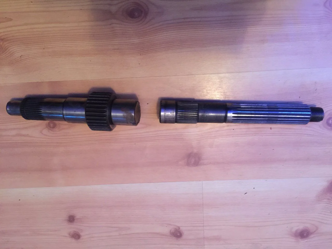

what happened to your trans? I had five speed that broke a snap ring on the second gear... and another that broke the counter shaft...
I've got one with a blown lower idler gear. I have completely lost 5th gear on the 60, kind of a parking spot
