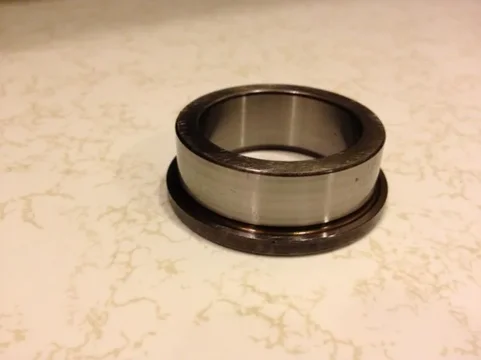

I forget what that is, but it looks like some kind of oil slinger or washer. Check the parts diagram. It doesn't look particularly important, like a gear.
You need to support the other end of the counter shaft when you walk the bearings on. Otherwise, you will just be pounding the shaft back and forth.
I forget what that is, but it looks like some kind of oil slinger or washer. Check the parts diagram. It doesn't look particularly important, like a gear. You need to support the other end of the counter shaft when you walk the bearings on. Otherwise, you will just be pounding the shaft back and forth.
How the heck do I do that? I tried bracing a pipe to one end, using the retainer, which broke the parts, etc. FSM says go back and forth.
Part is Not shown in diagram.
The thrust shoulder has broken off the bearing race. Without the shoulder, the rollers will wander away. The shoulder is part of the inner race isn't it? I can check tomorrow when I'm back in the shop.
Well, it is the old race, so I hope it is. It is that gray/green color so it looks like the shaft material.
I can look at the new race, it's on the bench.
Good news - JimC is right.
Now, getting old one off will be fun.

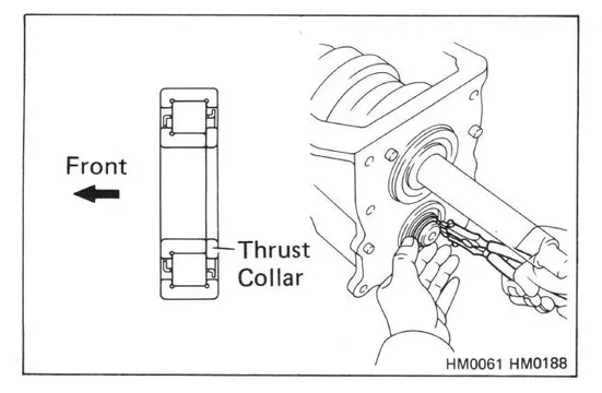

Here's an image of that bearings correct orientation from the Aug 82 transmission FSM 36237:

Ahhh. I think I may have found where you got the idea from...
I think they only wrote "if necessary" here to cover someone who is planning on reusing the ENTIRE original bearing.

I think you got it right. The "collar" looks like it is part of the inner race. It is definitely hardened like a bearing race. The original bearing is also in the opposite orientation as in the manual.

Inner race
Hi Vae,
You definitely shouldn't use the inner race that has the lip broken off. The rear countershaft roller bear is captured on the CS and slides in the case for expansion contraction when it is hot and cold. The front CS bearing is a ball and takes the thrust as it is locked in the case with the outer snap ring and the front retainer and locked on the CS with the front snap rings.
Yes, I think that may be why I thought that. I just looked thru the thread too and don't see where anyone told me to leave that race on there.
