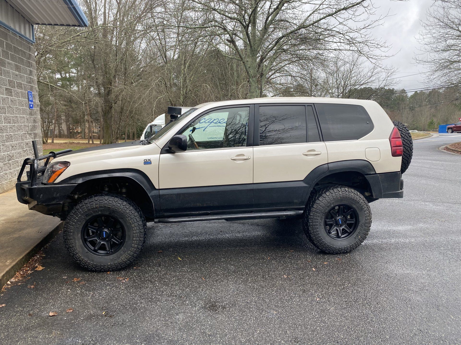

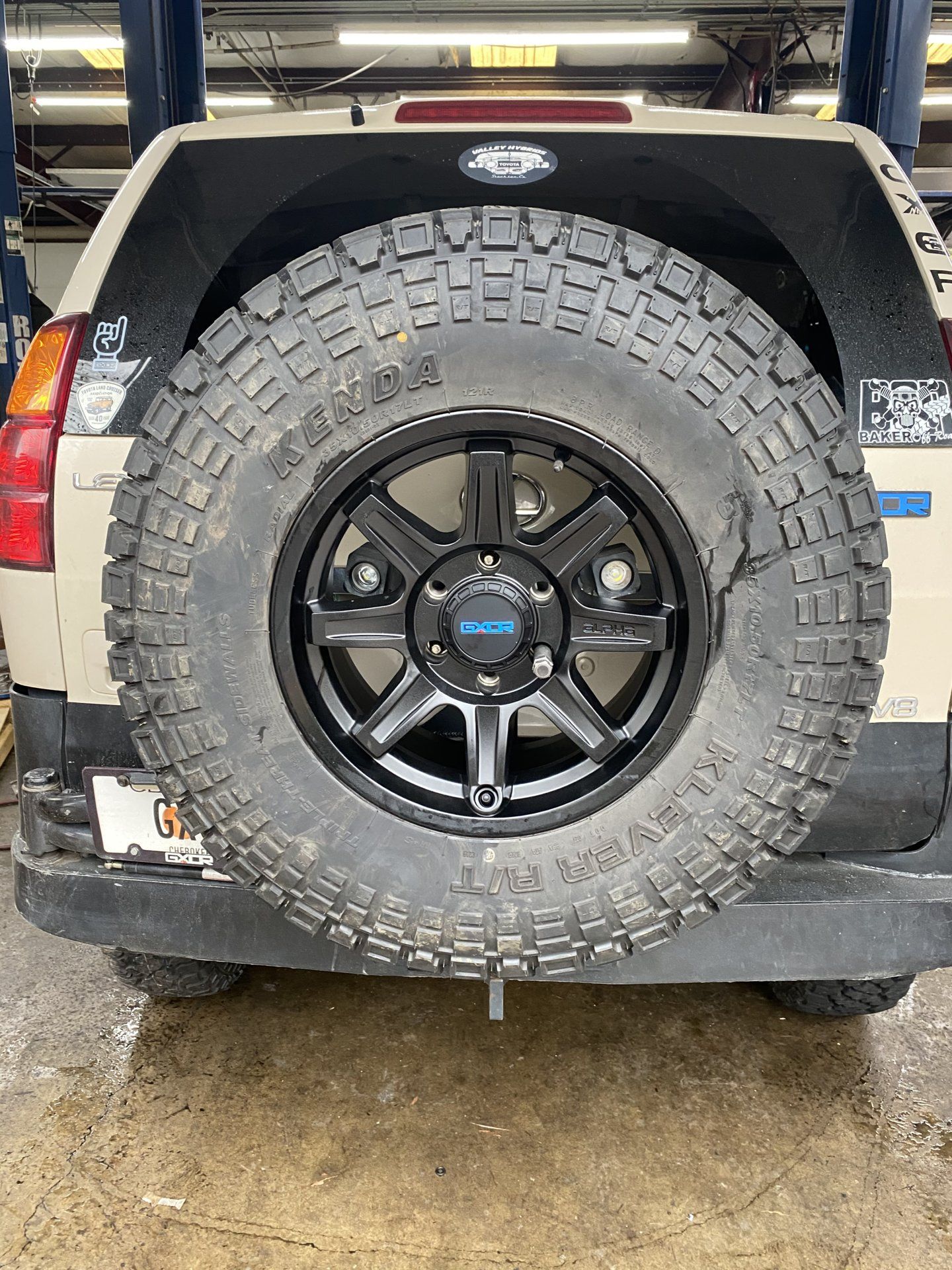

Truck is headed to the shop tonight for a stock tank pump/sending/filter, purge valve R&R, some new rear calipers, and some little welding things I don't have the gear to do. Then June is trans cooler and suspension time. Then I will be ready for FJ Summit and the rest of this year! Then I will see where Marlin is with the new front end and steering rack for late this year/winter/early spring rebuild of the front and I can call her done aside from PM after all these years.
Working on solutions for suspension, steering, and getting things prepped for yet another Colorado trip in a few weeks. Looking forward to Summit! Towed my trailer to Nashville by way of Knoxville and the nomad VB and TCC with the tank were a killer combo. Filled up in GA, drove to Knoxville, then south of Nashville, then back to Knoxville on one fill. Got around 10.5-11 mpg and never had trans temps above 200 the whole time (there are a lot of long mild hills on that drive that usually cause gear hunting).

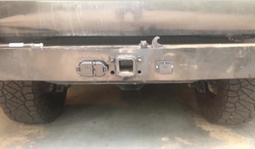

Finished my wiring for the conqueror trailer. Also figured out how to get into the wifi controls on the trailer.
Can now hook up a lot faster and run the brake controller, plus charge the trailer with a 50A anderson hookup!
do you have a BT trailer brake controller or standard box under knee-panel
