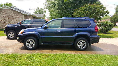

I want to thank you for all the contributions you make to the 120 sub forum, and more specifically about the GX470. I have been looking for a platform to build for trail driving and extended camping trips with the family. After drooling over LC100s that were over my budget, I discovered the GX. I now believe it to be the best kept secret in the off road community. After studying and searching for almost 5 months, and having several of them get sold before I could even look at them, I finally got one.
This is my new-to-me 2005 GX470
tcCz3uHgsAbgUKX0Hmrr1LLRBB0Ze2PhXC2fHYZVjq8=w460-h259-p-no
139k miles, one previous owner, no accidents, serviced by Lexus dealer every 5k miles.
I decided to go for a simpler no navigation, no Mark Levinson, no KDSS model.
I can't wait to start tearing into this thing. I have a few maintenance items to take care of first. The rotors feel like they have warped, check all fluids, and one torn axle boot. Then I need to get a few things its missing, a lug nut, a second row headrest, and a shift knob.
