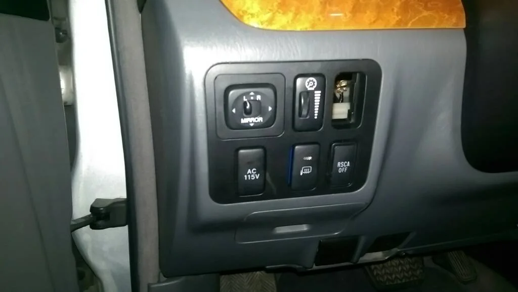

Sorry to bump this, but do you think the FJ rear diff lock switch would fit in the 07+ bezel p/n 5544660050 ? I'm looking for factory looking options to add rear diff lock...Here is a generic picture of them....
uploadfromtaptalk1453249677207-jpg.1194318
Yeah if I had to guess I think it should fit. Seems to be the same size to snap into that space.

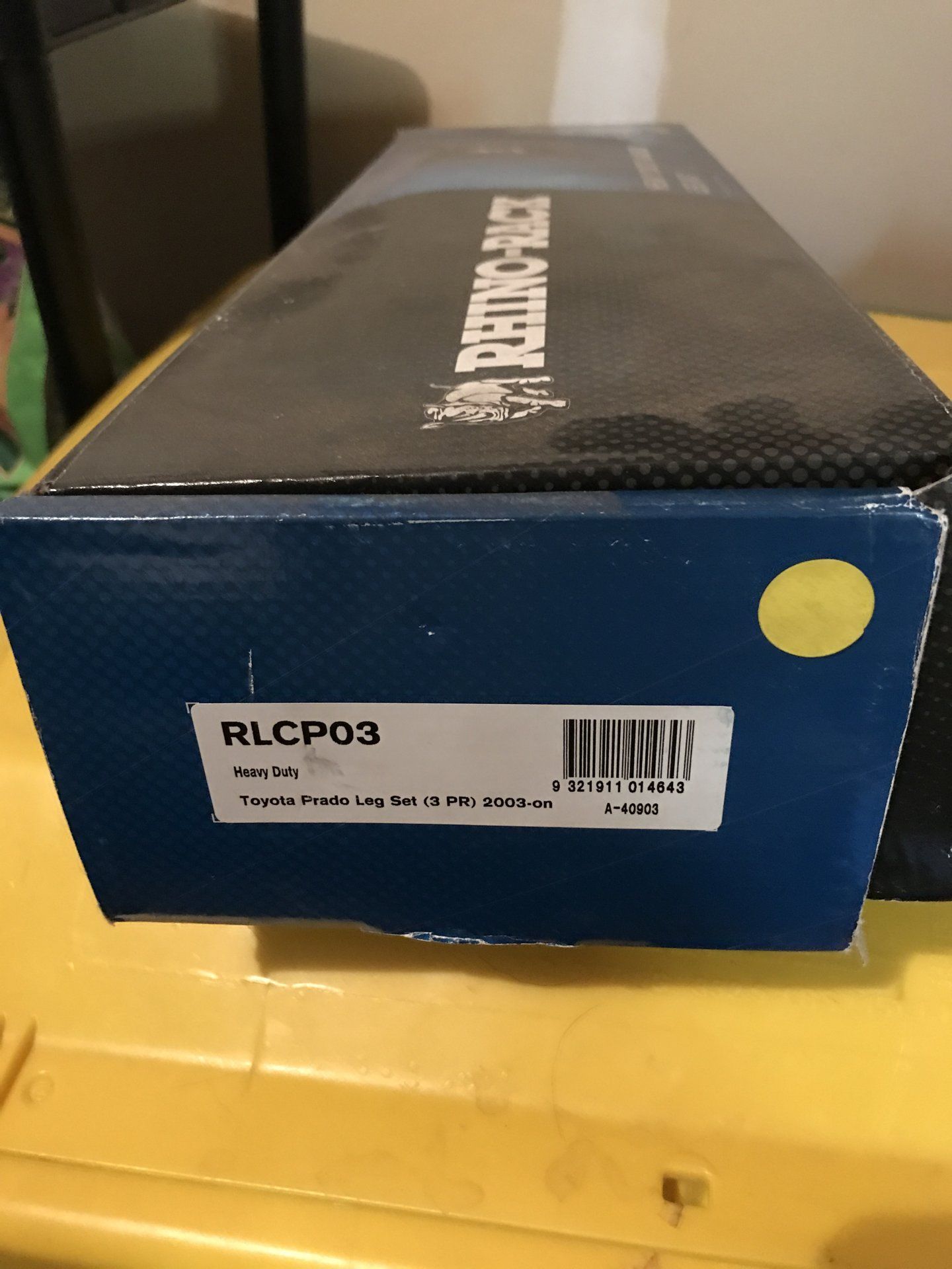

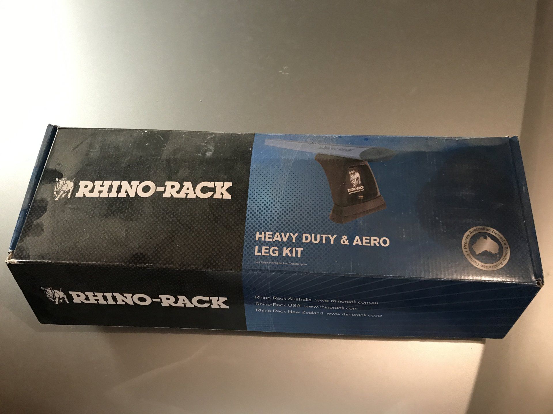

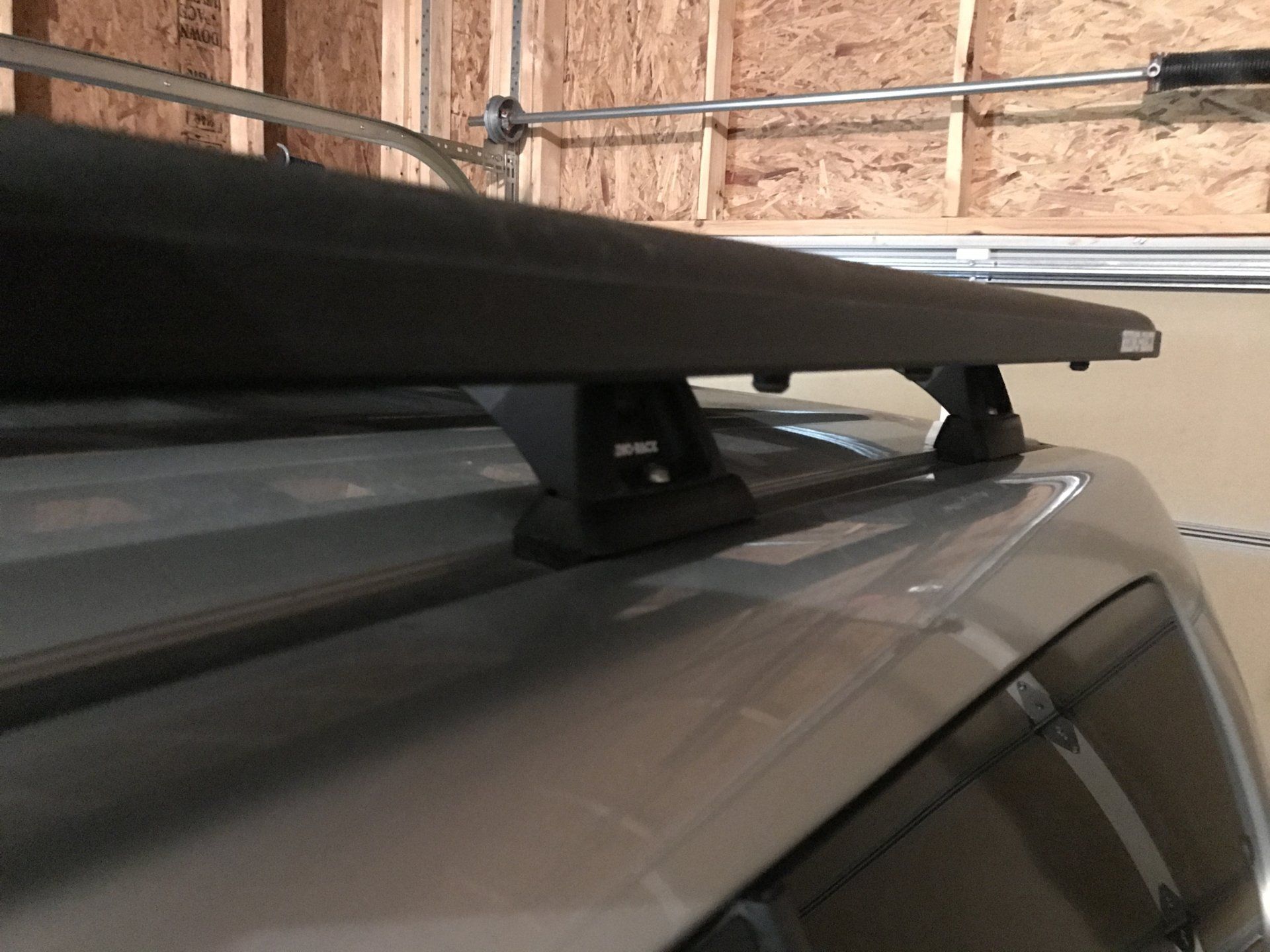

Hey Willy- I have a question. Sorry this is responding to such an old post but, I am attempting, literally at the moment, to install the Rhino Rack Pioneer Platform. Their site, and the parts that they sent for the GX include two RTS01 tracks that are supposed to be riveted into the roof. The tracks don't match the profile of the channel on vehicle so I am seriously doubting that this is correct (even though their website shows it as part of the fitment). I'm curious if yours has this track installed or if the feet that yours uses are the ones required for the Prado.
Hey man sorry for the late response. I didn't get a track to rivet into the roof with my order, I used the 6 mounting feet for the parado which bolt right into the holes that the stock roof rack mounted to. I've attached some photos of the feet.

Also digging up old news, but how'd your RR instal go in the end? Yeah no tracks for Prado/GX, just towers or backbone (not known available 2+ years ago, but is confirmed now) for platform or crossbars.

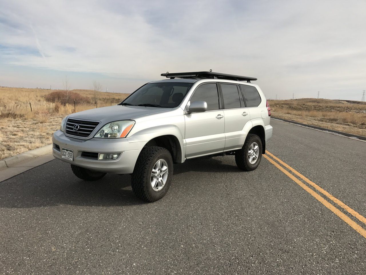

It’s been 3 years and 3 kids since I’ve posted on this thread. It’s time for some updates. My 2005 GX470 now has 144k miles, and is the best vehicle I’ve ever owned. The current list of mods I’m over the years:
-Iron Man Foam Cell Pro suspension
-265/70r17 General Grabber AT2s
-Rhino Rack Pioneer Platform
-Mountain Passes off road sleeping platform
-Opor sliders
-Factory nav to non nav and 9” android conversion
-Spidertraxx 1.25” spacers
-Apex overland recovery points
Looking to upgrade tires soon as my Grabbers have 55k miles on them, on the fence between 285/70r17 or 255/75r17.

I'm eyeing that suspension. Which spring did you go with: comfort, performance, or consistent rate?
Im running same color (but 07 and sport) same tire (size), same rhino platform ( but backbone vs towers), same sliders, and considering same bumper trim mod. Your pix give me a damn good concept of outcome for FCP and skin trim. 🤘👍🤓
A few questions though ...
How much lift did you ultimately gain? Which coil conversion kit did you use?

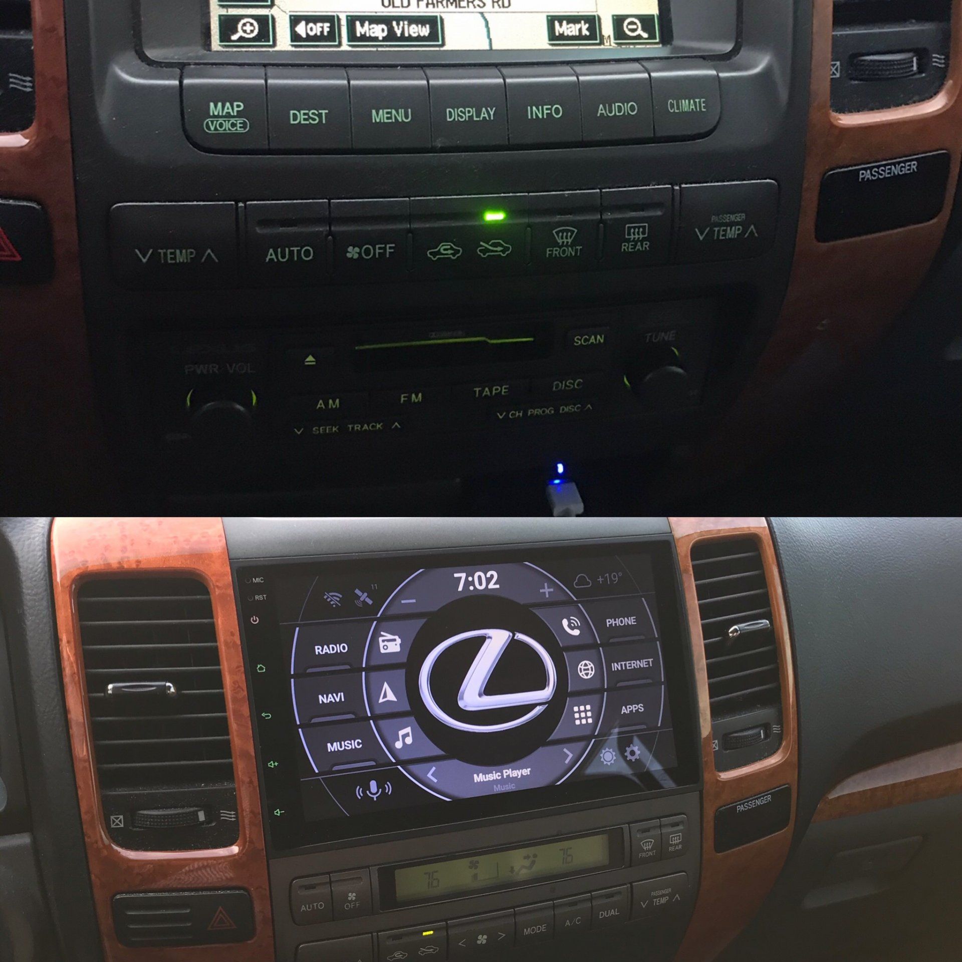

The head unit looks factory, is it the one from aliexpress/china? What are your impressions?
Yes it is the one from Aliexpress, I believe the brand of this one is Micronavi. I have had the head unit in for over a year now, and have been very pleased. I am sure the quality of a brand such as Pioneer or Kenwood is better, but for $270 I’ve been impressed. Zero issues to report, and my steering wheel controls function correctly. I bought a dongle and run apple car play most of the time or just the radio. I bought the 8 core with the most ram, and don’t have it loaded up with a bunch of apps so it is very smooth.
Would love to know more about this.
There’s a detailed guide on the Facebook group GXOR and I believe someone posted it here as well. You essentially have to track down your same year hvac controls for the non navigation GX, the model # can vary by year, so it may take some time to locate. You then have to extend some wiring from the passenger footwell to the center dash, and then you can run a double din head unit of your choice. It’s involved, but not terrible.
