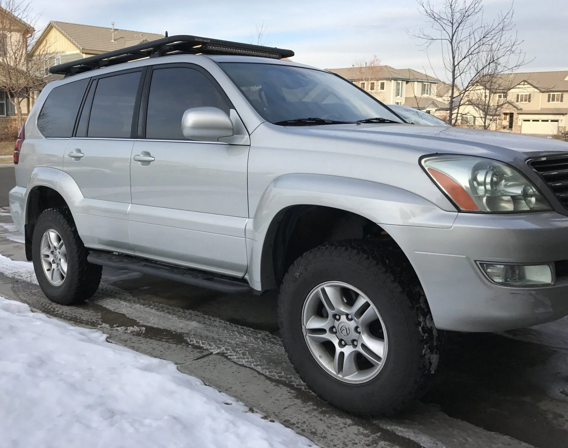

Yeah it's just the front ones. If I had the right tools it wouldn't have taken more than an hour or so. Once I had the running boards off, I used a solder gun as a hot knife to cut the plastic off the front of the running board and a sander to smooth out the cuts. After you've got your two front pieces, it clips right back on where it was originally to cover the white clips.

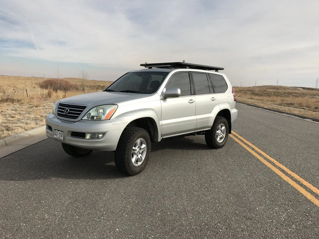

Was just checking out your thread and I really like you build so far. I like the LED light bar under the Rhino rack, clever. Never thought of that, I may use that idea. Was also looking at the curved 50'' LED light bar and mount just above the windshield. Still Low profile but yours is nice and hidden. I like it. Did you happen to take any picture of the process when you removed and modified the running boards? I am interested in taking mine off but don't want it to look like something is missing. Any more detail about the process would be helpful also. Thanks if you can help out.
Thanks, I appreciate the kind words. I was hoping the lightbar would turn out low profile and clean, I think it did. I had to order a single row bar to fit under the rack however, they are a little more pricey but just as bright in my case.
As far as the running boards, take a look at this link, near the bottom of the first page, this guy Orion was really helpful on the running board removal, and the subsequent steps to cover up the unfinished look near the front wheel. They come off fairly easy, just be prepared to break some of the plastic clips, they are kinda trickey to get off.

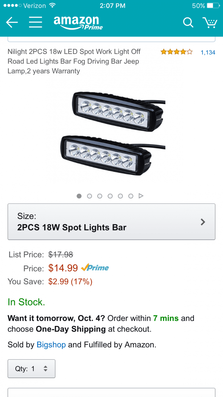

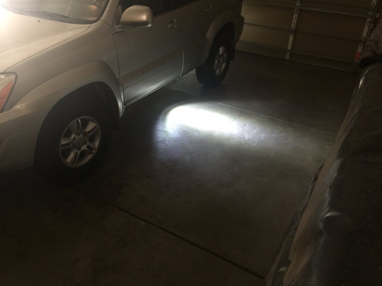

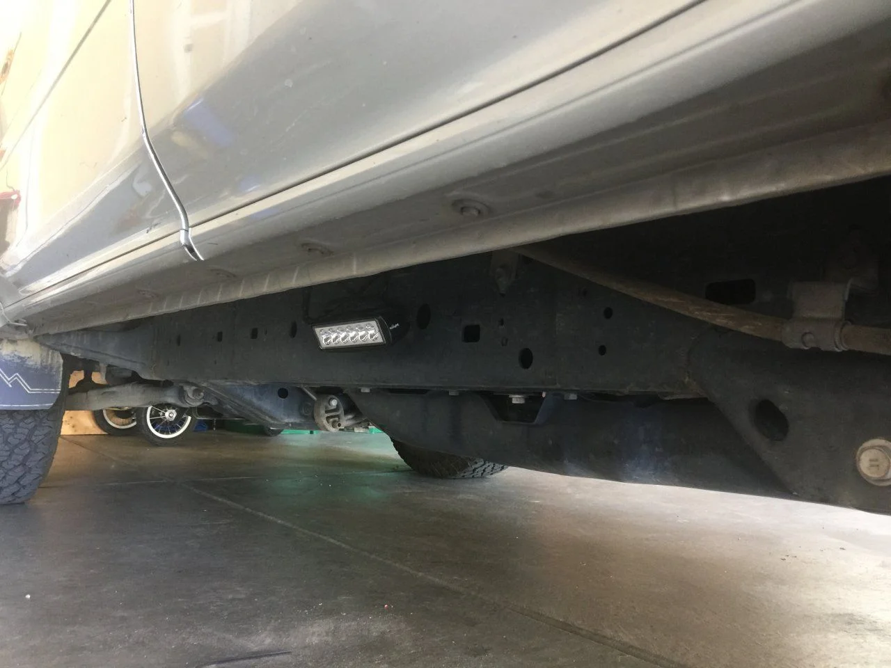

Not a big mod, but finally did something about the old running boards light harness dangling under the truck. Spent $15 on some leds from Amazon. We'll see how long they hold uP.

I mounted the lights flushed to the frame to minimize any damage, they were only $15 so if they rip off no worries. No new mods as of late. Probably won't be for a while either. ☹️

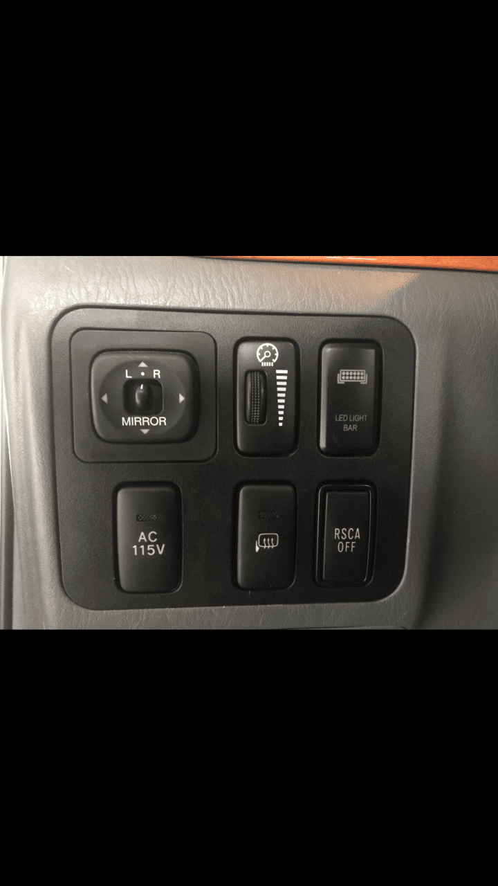

Haven't done much to the rig lately. Did move the lightbar switch from the little square blank under the steering wheel to the left of the steering wheel. I grabbed a '07 GX switch panel which has the spare slot and put the led switch there.
