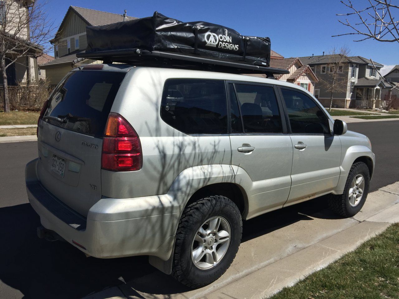

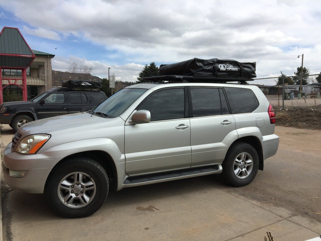

Just got my Rhino Rack Pioneer Platform installed with a 3 person RTT from Odin Designs in Castle Rock, CO. I'm very pleased with everything so far. Any Colorado guys looking for a rack or tent hit Odin Designs up, he's a new outfitter getting his business going, had some pretty good deals going. Next up is running boards delete, sliders, radflo lift, and tires.

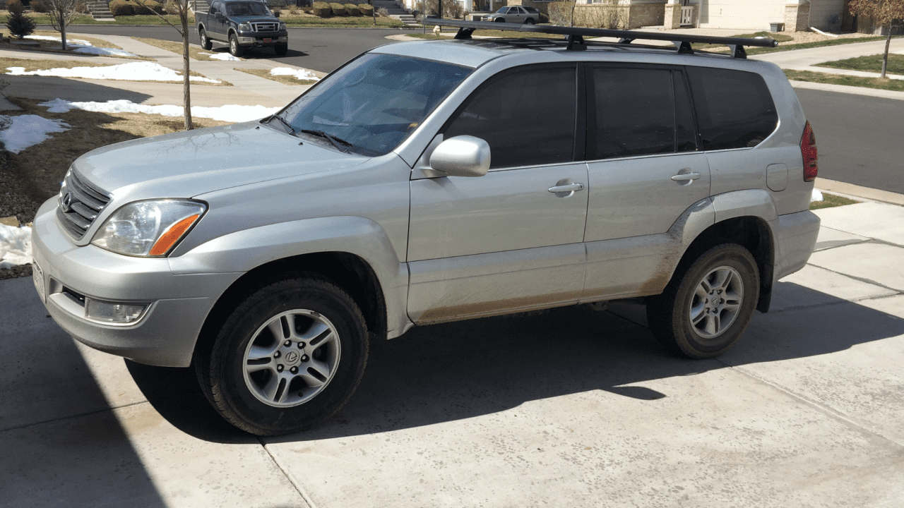

Removed the running boards and did the Orion mod to cover up the white clips behind the wheel. Totally changes the look of the truck.
Is it just the front splash guard that needs the mod. Wondering how much time it takes to get it done.
Yeah it's just the front ones. If I had the right tools it wouldn't have taken more than an hour or so. Once I had the running boards off, I used a solder gun as a hot knife to cut the plastic off the front of the running board and a sander to smooth out the cuts. After you've got your two front pieces, it clips right back on where it was originally to cover the white clips.

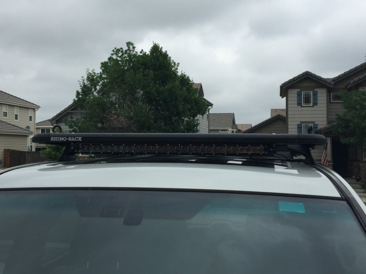

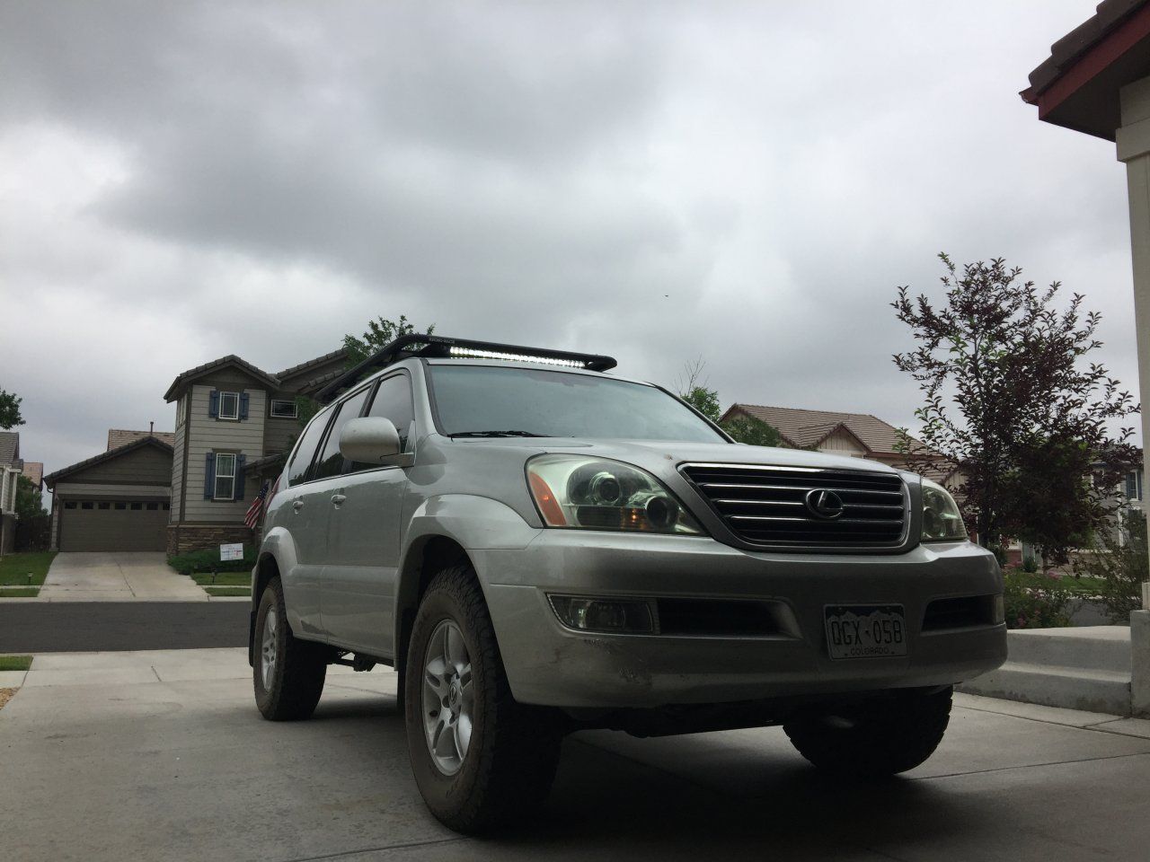

Went for the minimalistic look and hung a 31" single row light bar under my rack. I was back and forth on the 41" or the 31" and I'm glad I went for the smaller one. There would've have been an issue mounting the larger one. It is very bright at night.
I know it's been a few months since you installed the new rubber, but I am having the same dilemma you were regarding the suspension and new tires/wheels. Looks like you ended up going for smaller tires instead of the 285/70s. The 265/70's are a smidge bigger than the stock, do you have any rubbing at all?
Yeah I've had them on a few months now and don't have any complaints. I'm glad I opted for the 265/70s since I'm stock right now. I have zero rubbing. Not sure if that's just General Grabbers AT2s or what, but they've been a great tire so far in that size.
