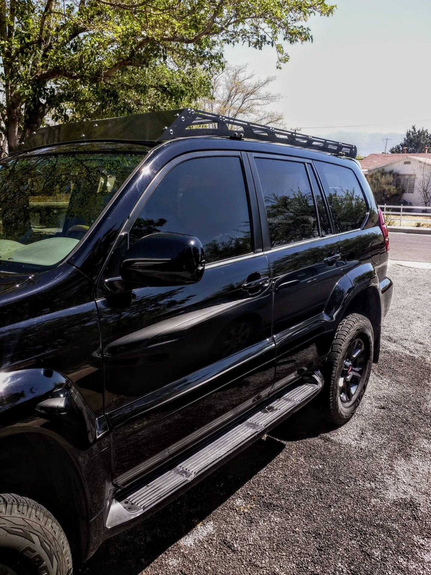

The Wood Grain Warrior rack from SS Offroad consists of of 80/20 extrusions mounted to custom side rails. It looks very nice and well executed. And it seems some Frontrunner accessories will fit on the rack.

Prinsu rack is now available for the GX. This is a similar option to the SSO rack with the aluminum extrusions between 2 aluminum plates.
Yaaaaaaaaas!
Anyone know what rear bumper the Prinsu model is running?

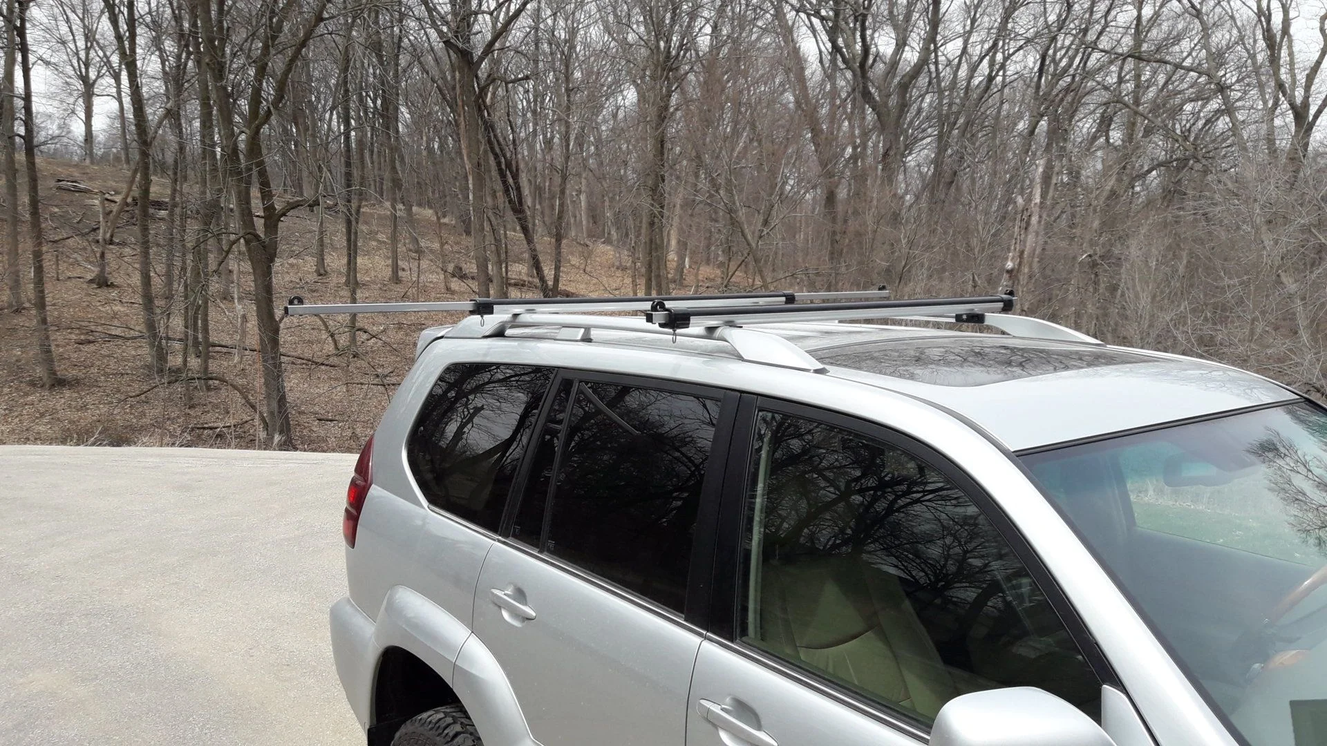

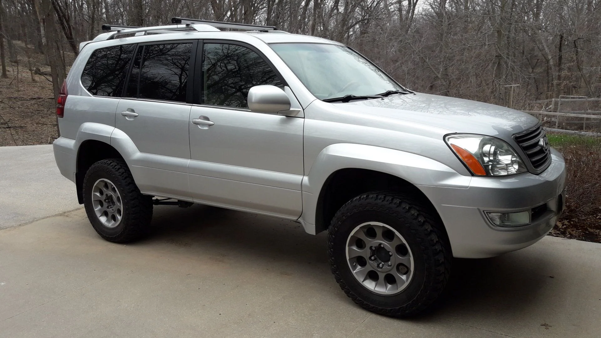

I just ordered some of these cross-bars from Apex.
Apex Overland | Off-Road Parts Accessories | United State
I'm sure they won't have the full funcfunctionality of an actual rack but i plan to use them exactly as pictured. Looks like I should be able to park in the garage when nothing is attached to them, then when I go on a trip I can attach stuff as necessary.

I got these brackets from Jeremy Keenan on GXOR I use to mount some cross bars from Spring Creek primarily used for hauling canoes. I plan to mount a Hi-lift, Tred Pros and shovel to them for a trip this summer. Could use the brackets for a variety cross bars.

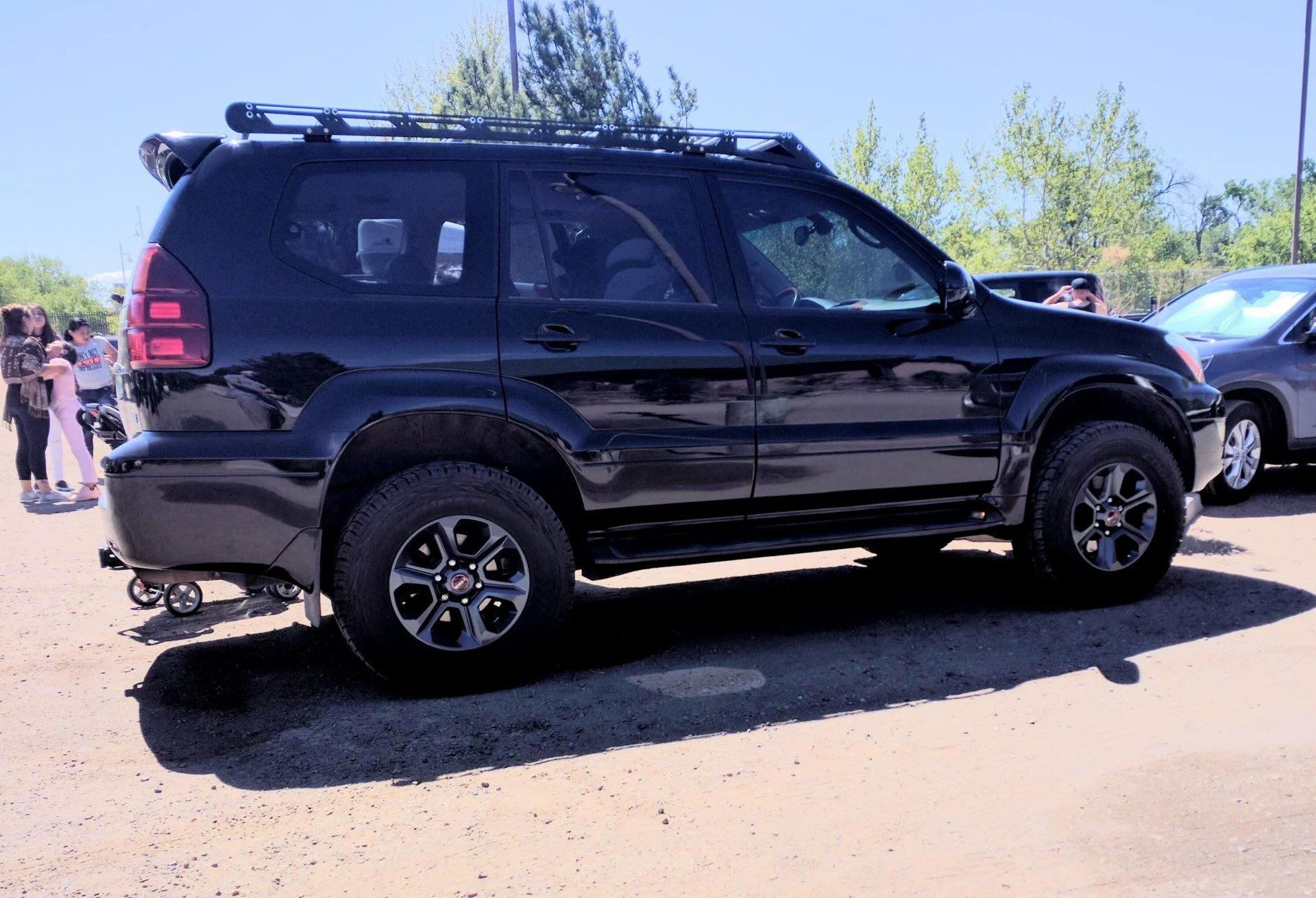

I designed and built myself a rack using 80/20 t-slot crossbars like the SSO and the Prinsu and now I'm working on a short version, like 3/4 roof length and low profile. I've got the drawings into the CNC cutting place and I'm awaiting a bid. Here are some pictures of my full length but the 3/4 will be a shortened version and lower profile (less tall for the garage clearance ) At the suggestion of another member, Im thinking of trying to sell just the side pieces and brackets to guys interested in sourcing their own 80/20 crossbars to save a little money. Anyhow, not sure if you've found what you're looking for but I'll have some pricing information tomorrow I believe.
