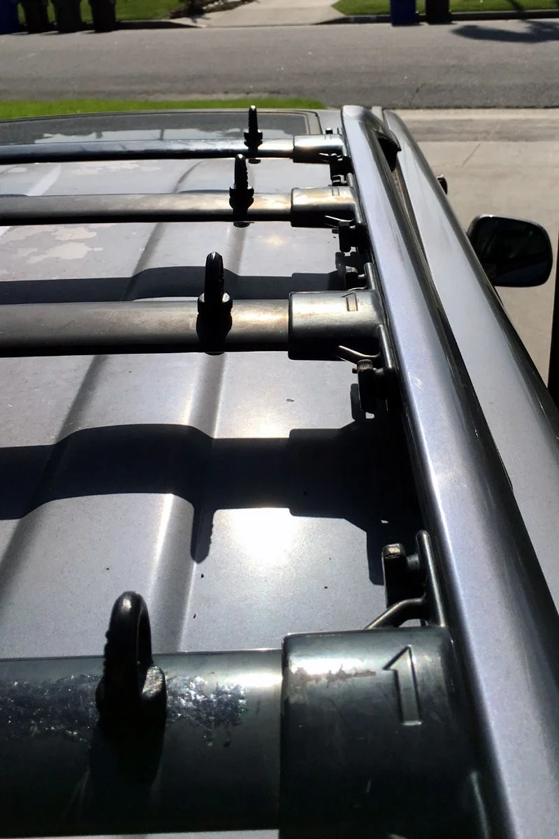

I'm thinking about putting a tent on the OEM rails. (07 gx470) I read that the weak point in the system is the aluminum crossbars, and have been recommended the Thule Areoblade or the square cross bars at around $500. but using the stock side rails. I have been looking for the static weight allowance for the stock equipment??
So here is the question-
Has anyone added another one or two OEM crossbars to beef up the weak link and spread the weight around onto the OEM side rails?
I have a 50# tent, fits just fine for the lbs limits of the OEM crossbars. and 320# of people up there when at rest.... if I install four OEM cross bars, why not wouldn't this work?

I did. Found two used oem crossbars for $20 and added them to the existing roof rails, so I have 4 oem cross bars.
Since I didn’t plan on a roof top tent, I didn’t research the weight limits. Also, only plan to carry light stuff up there.
Oem crossbars are curved and hollow. Not sure how you are going to evenly distribute a RTT load across all the curved oem crossbars.
Since the suggestion is to place rubber between cross bars and the tent, perhaps I cound add more to the outer mounts, to build up some cushion.
I was thinking like strong hard plastic, maybe boat trailer rollers cut and fitted for example, but suggestions would be appreciated. The curve isn't too drastic that some plastic cushion washers could manage? Your thoughts?
dense foam "washers" or rubber, do it.
If I were to put a RTT, I would consider at minimum the aftermarket crossbars that are flat and stronger than oem crossbars.
The aftermarket crossbars also allow you to attach all kinds of aftermarket tie down rings, shovel holders, rotopax fuel containers, etc.
Also, I’ve seen @Dissent on the 80-series use an REI tent as a RTT. He setup some type of platform on a Prinsu roof rack and placed the tent up there. I thought that was creative.
I ran a roofnest Sparrow X on my OEM side bars with 5 sections of 80/20 crossbars for about a month before I bought my Prinsu rack. I started getting a weird rattle that I discovered was a broken aluminum mounting foot for my factory roofrack side rail. I'd avoid a rtt on the factory rack.
