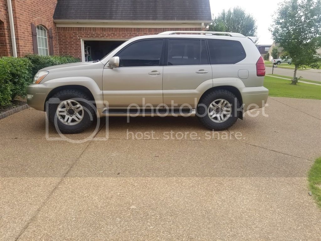

I bought some 285/70/17 BFG KO2's before I got my lift installed, I drove it for about 2 weeks prior to having the lift installed...I did put them on my old Tundra wheels which have a slightly different offset than the GX wheels. It did and still does rub just a bit on the front mud flap. I am going to have to trim a couple inches off but here's with them before and after 2inch lift.
Looks great! Did you have to run spacers with the tundra wheels to clear the UCA? What 2" lift did you go with?
Wait, how? You're saying you put on 285's and only had SOME rubbing on the front mud flap? This doesn't exactly jibe with what I've read here and elsewhere.
I'm also learning that one man's rubbing may not mean the same thing for others... For instance it may rub for you when you pull out of your driveway, but if you were to go on a trail it may be a whole other story. Sorry, nothing intended I'm just trying to make sense of all this since these tires aren't cheap and I want to get it right the first time.
So no spacers, and only a slightly different offset from the stock GX wheels? Do you know what year the Tundra wheels are? Or more specfically what offset they are?
I have not been on the trail at all...this is just regular daily driving so far. Without the lift I would for sure not even attempt to take it off road at all. After the lift again..just daily street driving it rubs the front inner running board when turning 80% to full turn, I need to trim or heat and bend back about 2 inches or so. As far as how much travel I will have out on the trail IDK yet its going to be a little while before I can get out there.
Thanks...No spacers and I went with Lowrangeoffroad.com I went with Bilstein 5100 and OME springs..they put them together for free and in the rear bilstein shocks and OME 2895 springs, I like the ride a lot better than the old worn out air bags! Oh and the Metaltech rear spring conversion kit.
