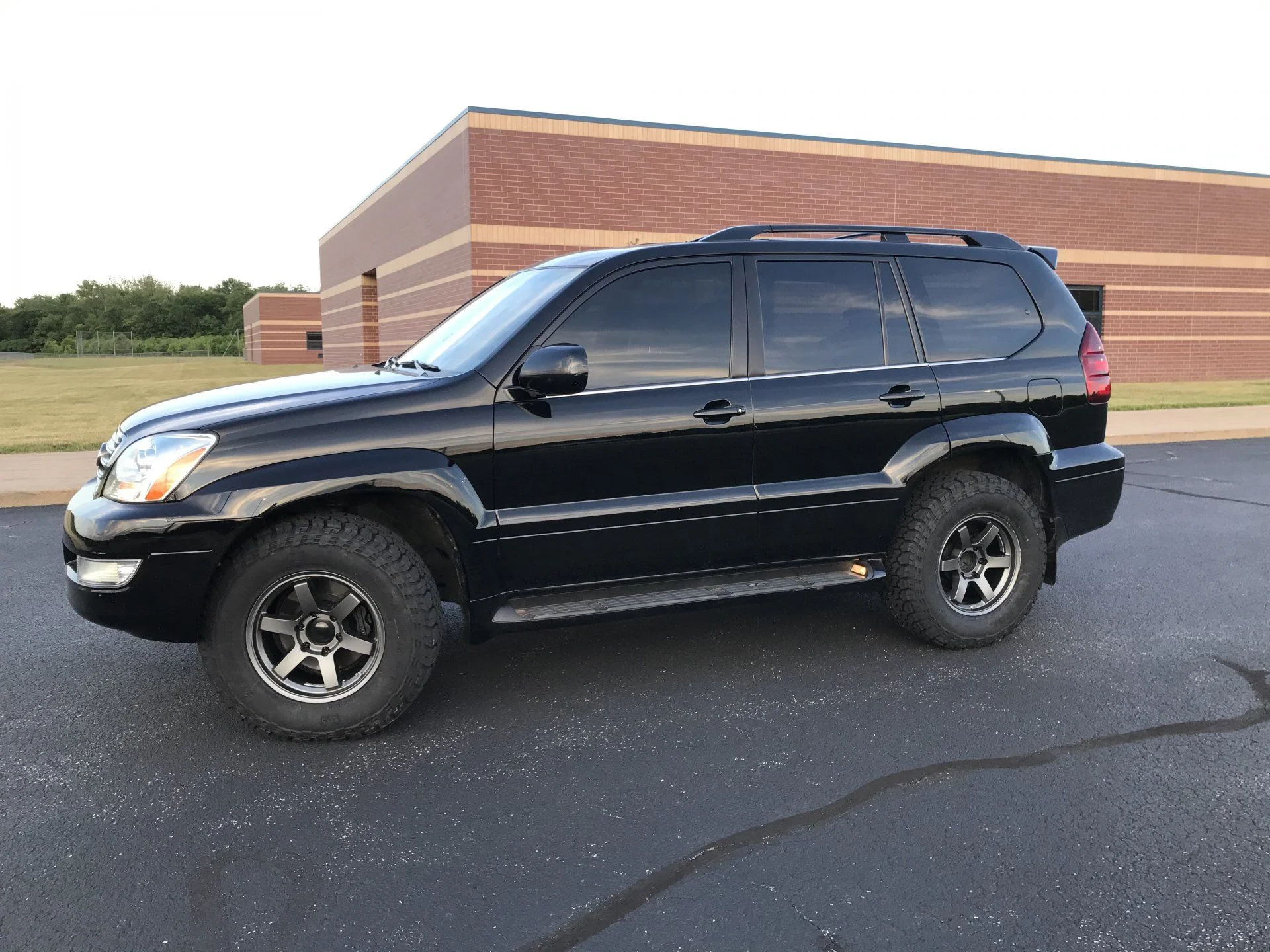

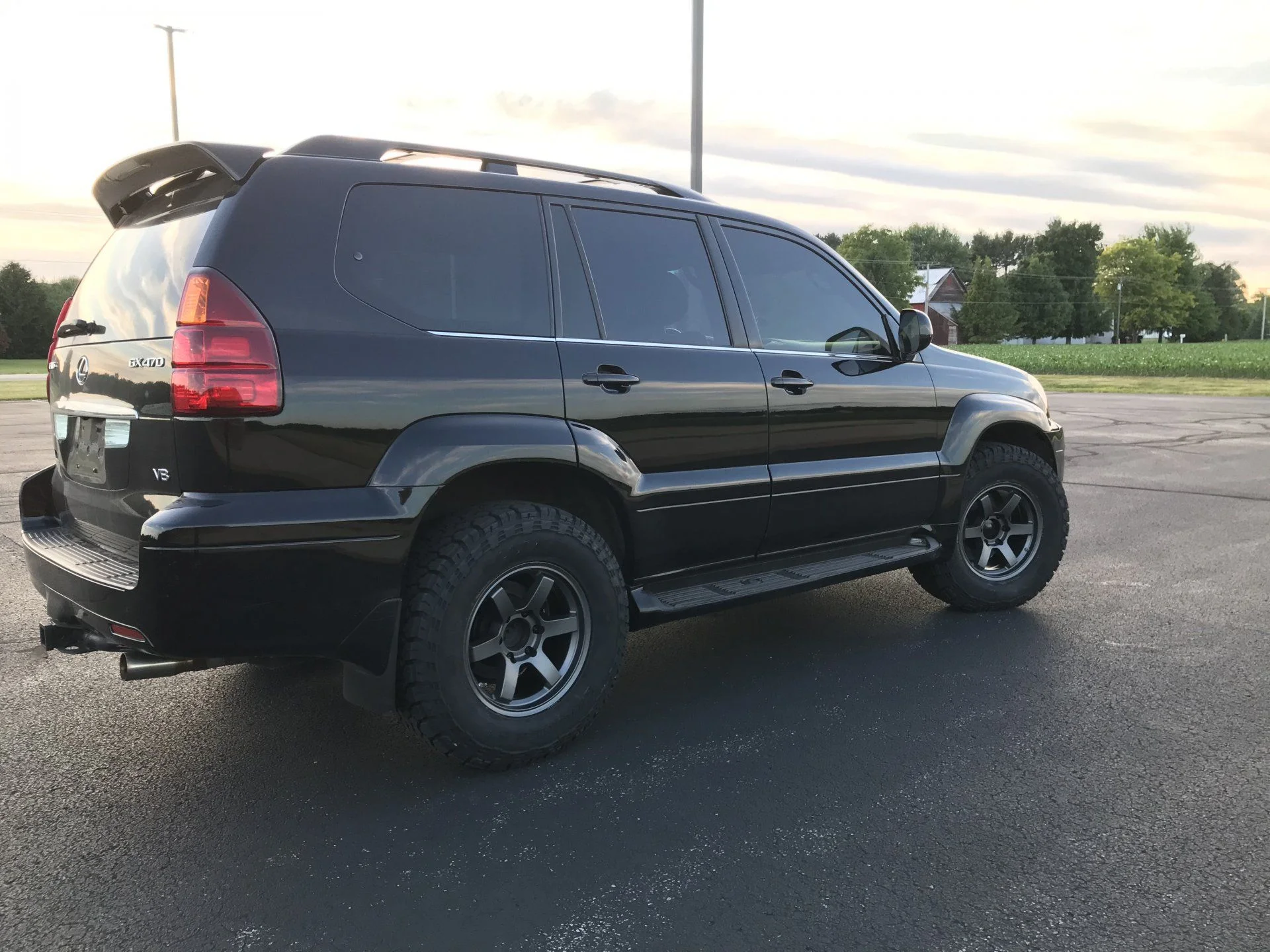

GX470, no lift. Will 275/70-17 K02's fit?
275/70/17 General Grabber ATX.
Level 8 MK6 17x8 et25.
Stock suspension, no lift, no spacers.
Based on the wisdom captured on this forum,
I knew I would have to push the front fender liner forward and heat/mold the liner behind the front tires. I hammered the pinch weld behind the front tires, also heated and shaped the front of the running board.
Nailed it, no rubbing yet! Mostly street use, so I will report back if I get running under more extremes.

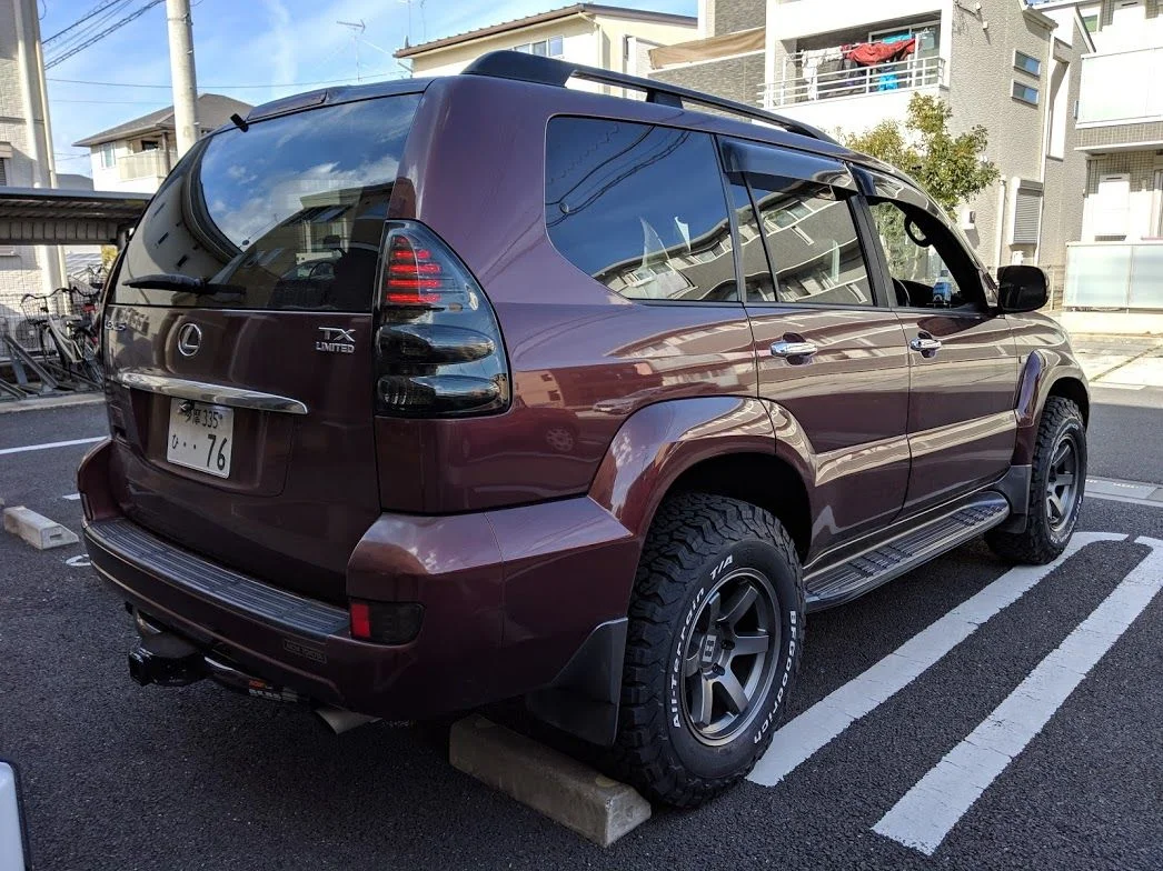

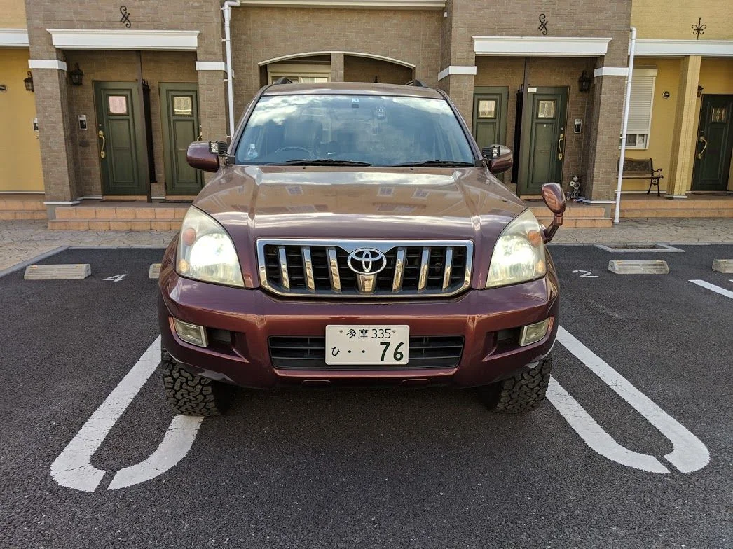

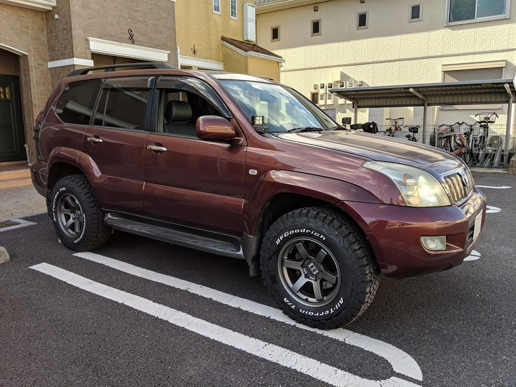

What's the backspacing on your wheels? The ones I just ordered are 17x9 0mm offset and 5 backspacing and wondering if I'm going to run into issues with the wheels or 265/70r17 BFG KM3s.
Same as yours, my wheels are:
LEVEL 8 MK6
17x9.0 6/139.7 ET00 CB106.1
MATTE GUNMETAL

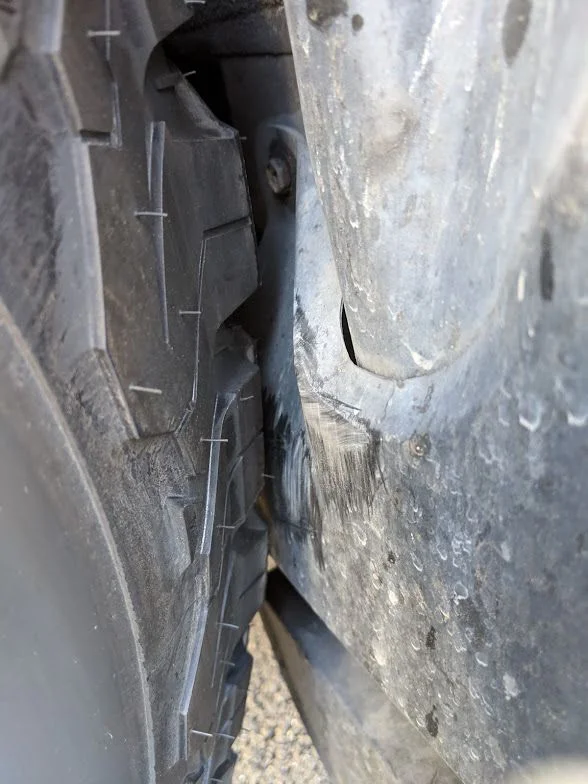

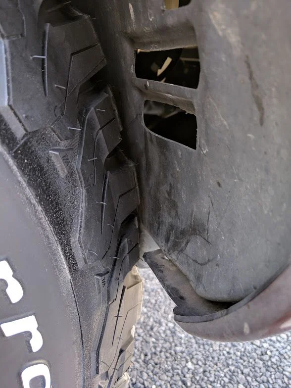

Without a lift, probably not without some rubbing if you are offroading. You will need to trim fender liners (or massage with heat gun) and the side skirts no matter what.
To answer your PM, I run a 285/70-17 on a 17x8 -10 with a 2" lift (front spacers, rear spacers + airbag trick)
Here is a comparison of my setup vs your proposed.
