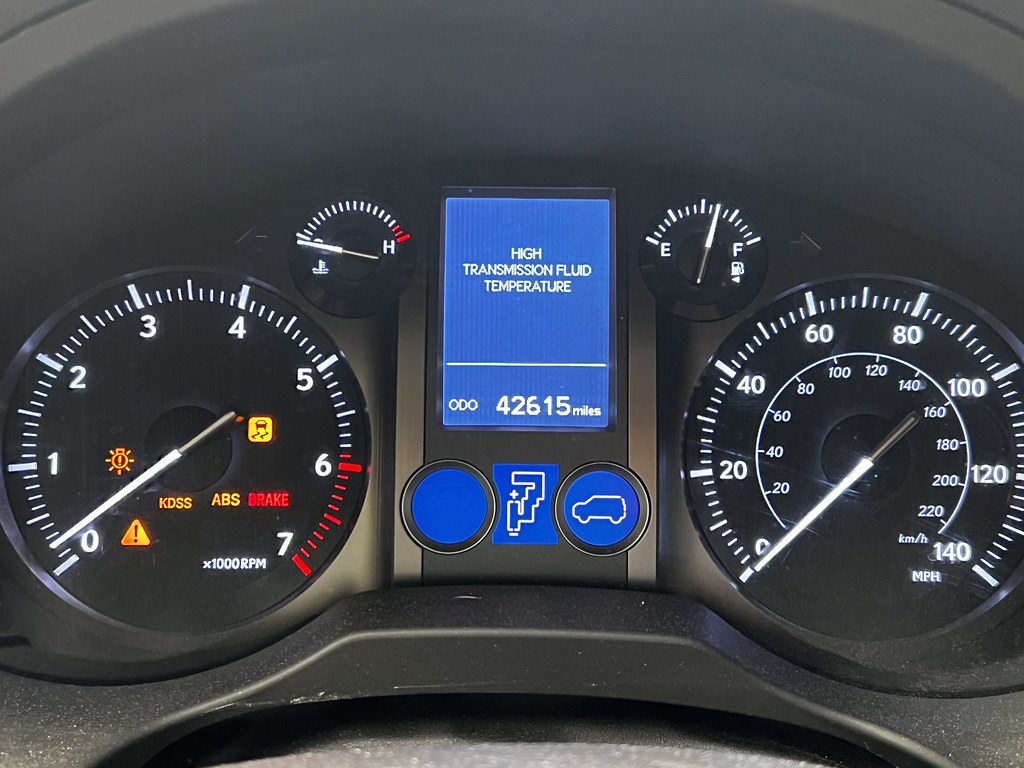

Alright so after a solid week of no issues the electronic woes are back. Had been driving it daily without issue. This afternoon I started it and let it run for about 10 minutes then drove it for about 5-10 minutes. Shut it off at daycare to pick up the kids, and when I turned it back on all of the warnings were back out of nowhere.
Here's the weird one: High Transmission Fluid Temperature warning.

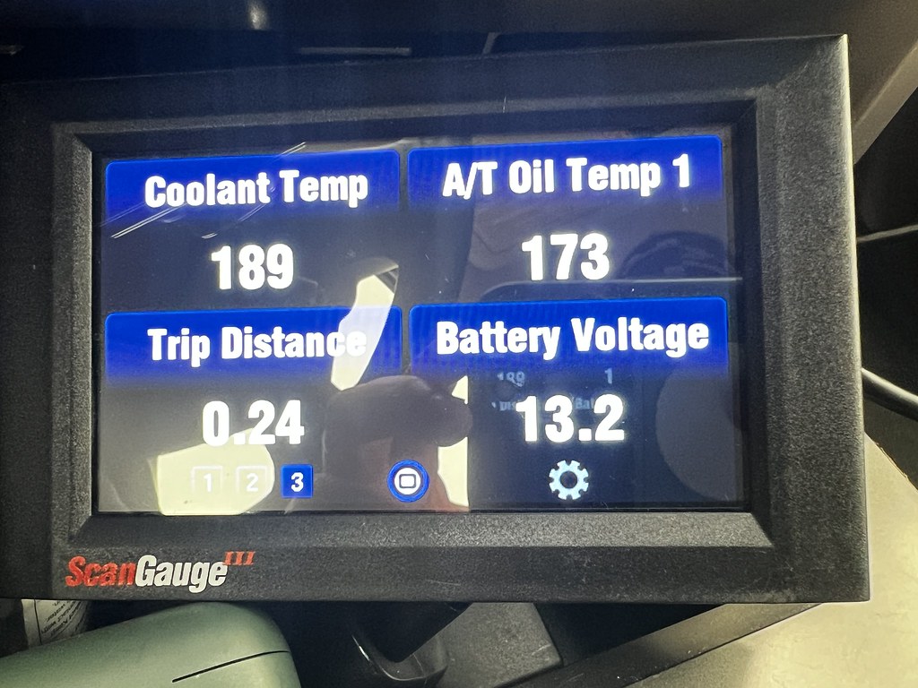

Meanwhile, the Scangauge says the ATF is only 173*F... which isn't even close to being a high temp.

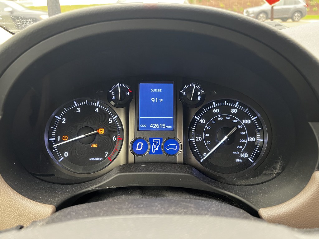

After a few minutes and driving about 1/10th mile the majority of the warnings went away, leaving only the ABS and TCS lights:
Haven't had a chance to pull codes or play around with anything yet, but my frustration with this situation is coming to a boiling point.

This afternoon: Started the truck around 2:30, no warnings. Drove it 5 min, turned it off to run into a store, started it again, all the warnings came back. Drove it 2 min, turned it off to run into a store, started it again, only ABS and TRAC warnings. Drove it 2 min, turned it off to get gas, started it again, no warnings. WTF.
