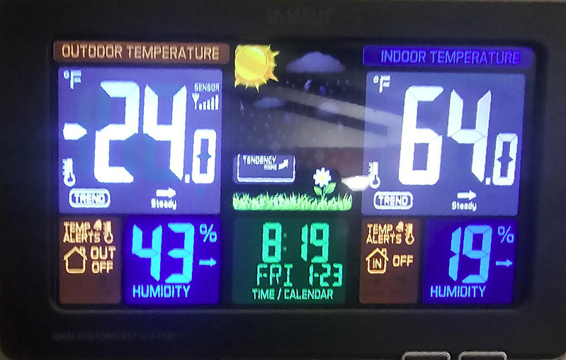

With this weather it seems to be common. I've had a dozen or so nearby that have lost batteries in under a week of non-use. It's crazy. I start all my vehicles every day for 10-15 minutes when temps are twenties or below.
That's reassuring to hear at least
