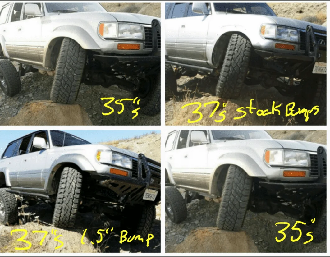

With 35s it's possible to get unrestricted travel without trimming, but with 37s it's a must if you want to stay low COG. A 3" suspension & 1" body lift totaling 4" of lift.
With doing a lot of research most rigs with 37s are running lifts that are 2" to 3" taller (5" or 6" of lift) then spacing down the bumpstops 2" to 3". This gives about 4" of uptravel. If I go back to stock bumps up front I will get my 4.5" of shock uptravel back. I am willing to cut & if I do it correctly most will not even notice that I have cut the fenders. Adding .5" more body is a option, but I want to do all this with only 4" of lift.
Look at @Apounder he is running a 850J/863 suspension (3.5" lift), 14" shocks, no body lift, cut fenders & 4Ds... his rig has custom bumps, so I don't know how much uptravel he has, but it is a slick & sick set up. I would like to know what his belly height is with those 4Ds...
But my goal is to get what I had with the 35s. Here is a pics of my rig on the same stump with 35s & 37s. See how my hood is almost flat. My goal is to get back to a flat hood.

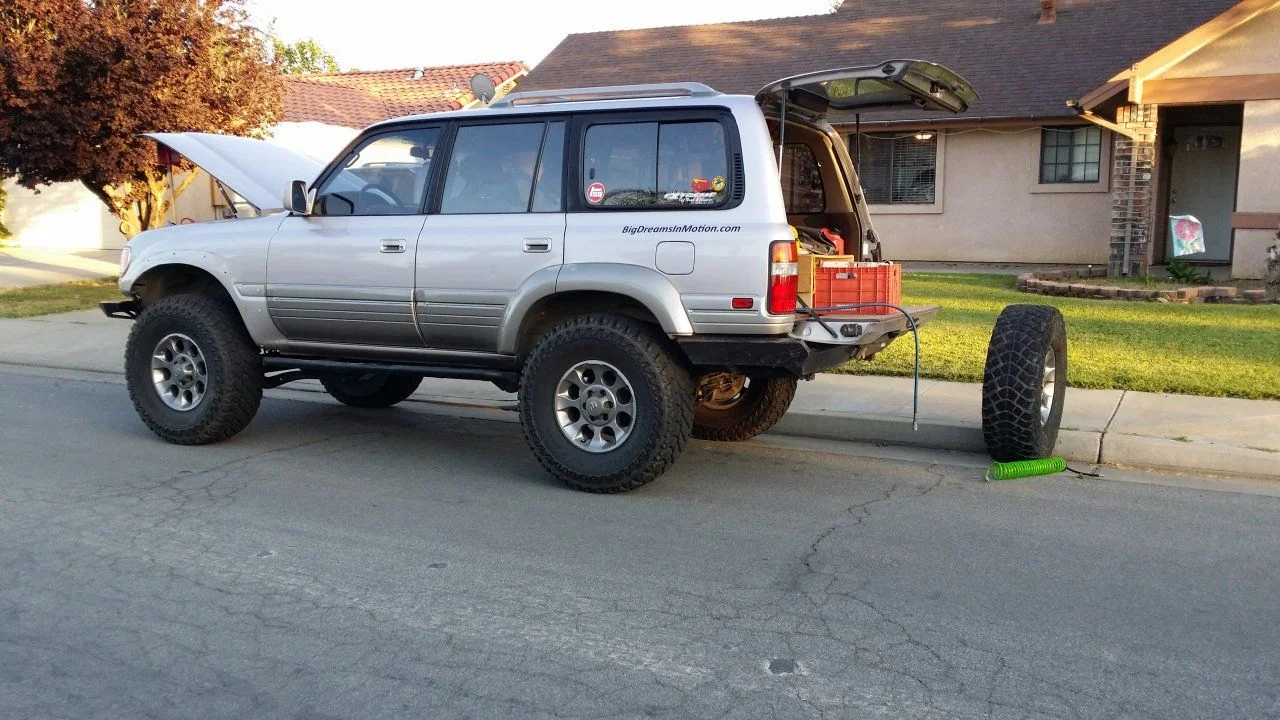

Now that I have broke them in a bit loaded & empty, they are just what I wanted. They have helped Lexi450 have even better turning manners. I can feel the plush 170lb. rate while empty, they feel very nice. When I make fast hard turns I can feel them set into the firmer 260lb. rate & it turns like it's on rails. I can't be happer.
To note: these are considered to be stock height replacement springs that gives approximately 1" lift over stock. To achieve a 2" lift I added 30mm to them giving a final center hub to bottom of flare of 22" after minus of 1" for my body lift (Stock is approx. 20").
If only OME would only add one more turn & .5mm thicker wire to the 862 it would increase lift by 1" like they do to the 850 & 850J. They could call it an 862J.... Hmmmm, just having fun.
It's level with 300 to 400 pounds in rear for test run.

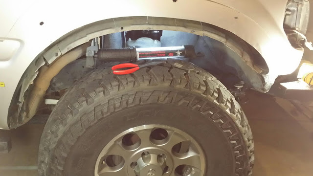

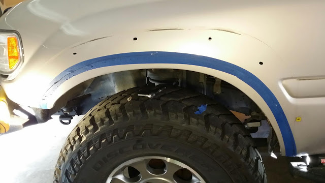

Cutting the front fenders.
The latest project has been to remove the 1.5" bump stop pucks that I recently had to install after putting on the 37"s. I trimmed 2" up from the bottom & cut some relief slits on the inner fender to open up it up wider.
The latest project has been to remove the 1.5" bump stop pucks that I recently had to install after putting on the 37"s. I trimmed 2" up from the bottom & cut some relief sits on the inner fender to open up it up wider.
I love the hack saw blade hack for the air saw!

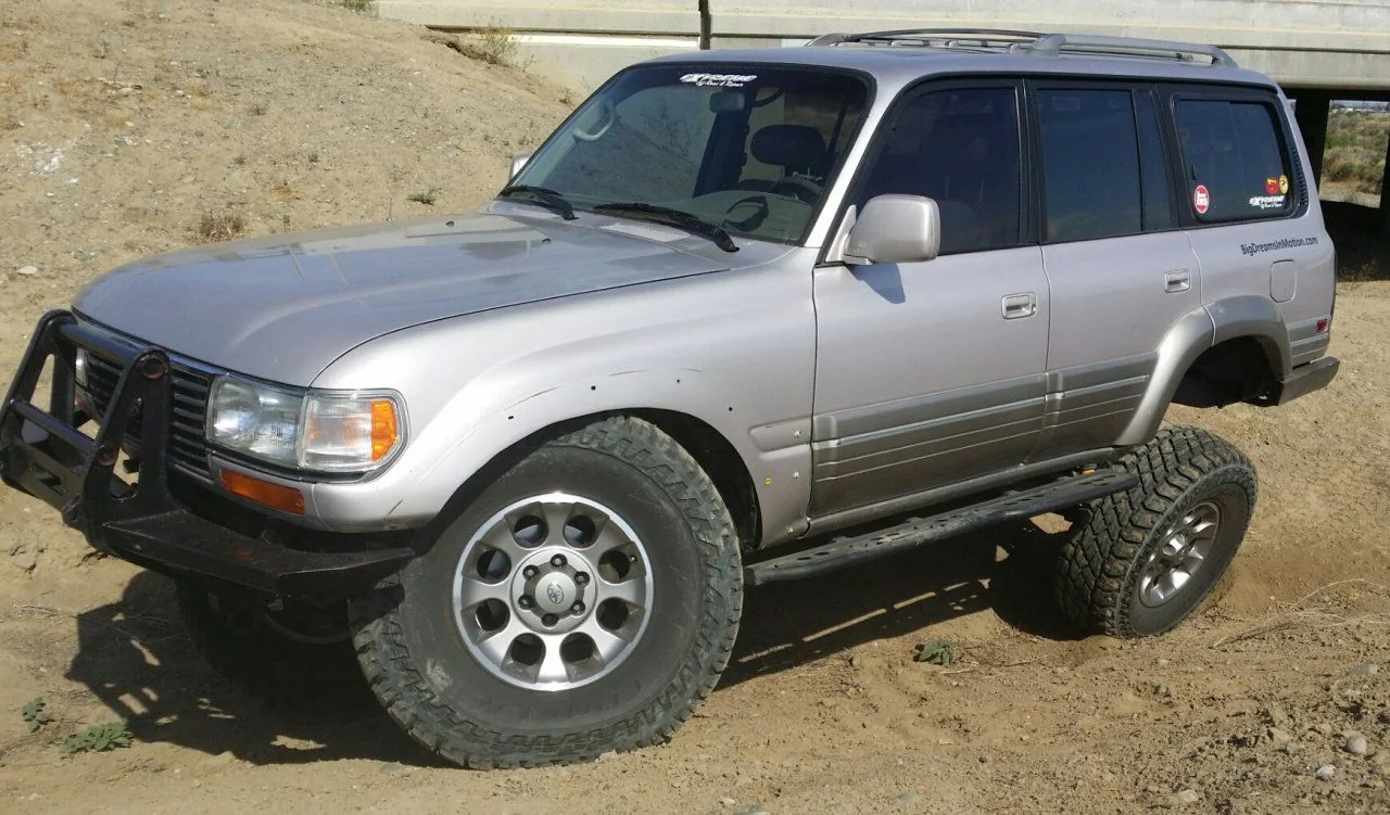

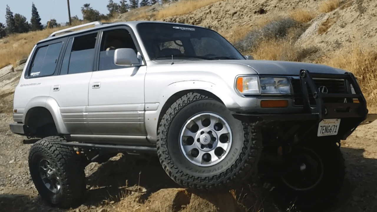

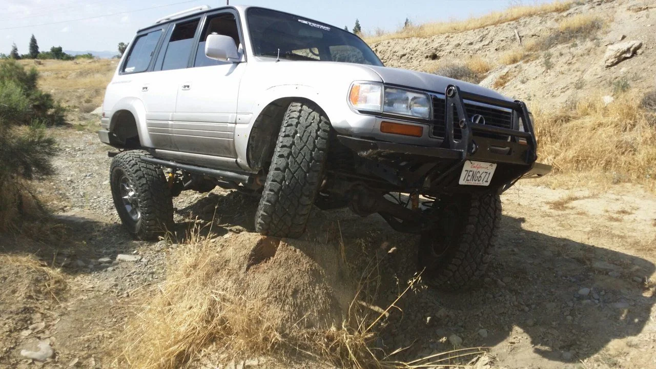

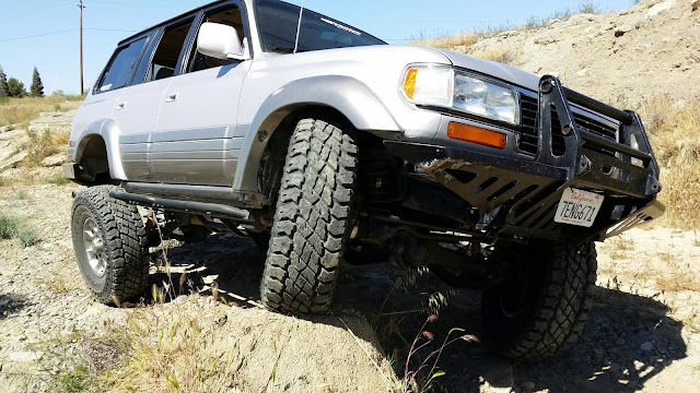

I took out the 1.5" bump stop pucks after cutting front fenders & got back 3" of uptravel. I went out on the same old stump to compair. It's definitely stuffed in there. Cutting was worth the effort. Sway bar is disco'd.
I didn't quite make it to a flat hood like the 35"s but close.
Anything rubbing on that front stuff? Sway disconnected? Looks good!
Yeah sway bar is disco'd, it's rubbing evewhere, even the top.
I need to add some bump stop pucks back in there .5"?
It won't rub as bad with the sway bar on because it restricts travel.

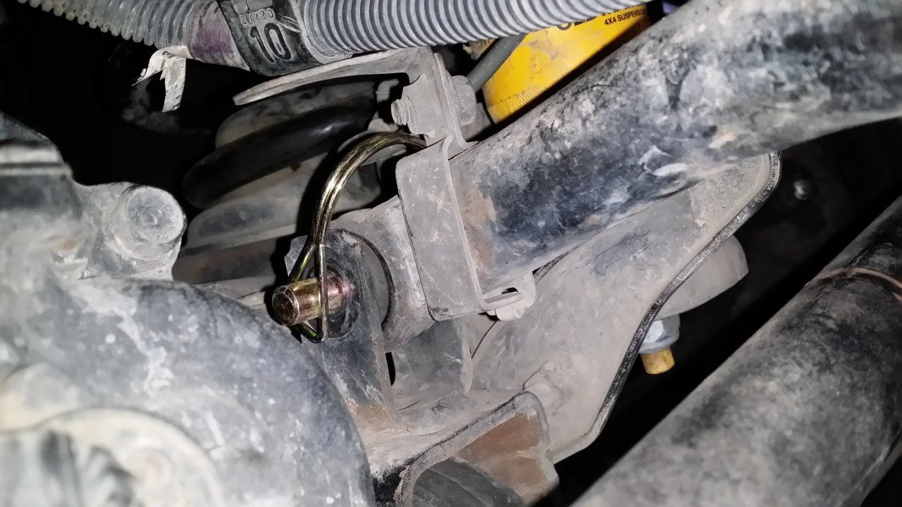

Hey all, I picked these up for $7 on Amazon they make it a bit faster than bolts.
