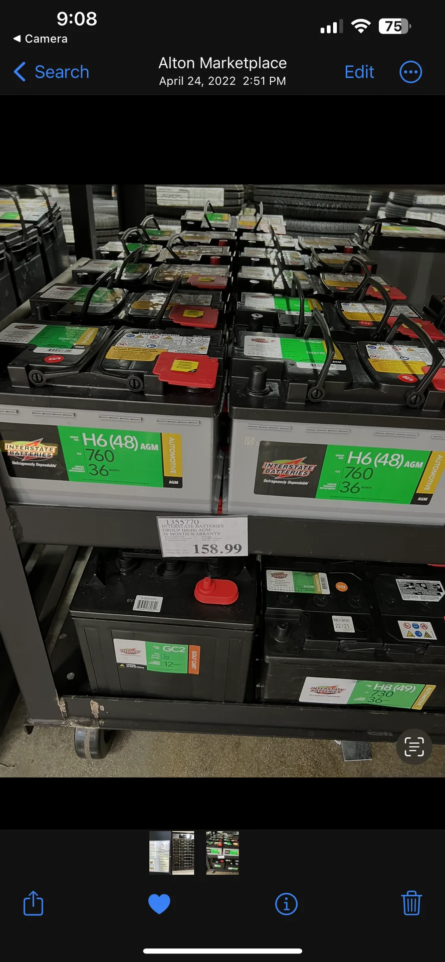

The Costco Interstate 31 is about as good as it gets from a quality and price perspective.

Have been running Interstates from Costco in a half dozen vehicles and have been very happy with them.

For you folks that buy the Costco batteries, Are they AGM? How much are they? I cannot find any grp 31 batteries on their website. I ordered the voltage gadget from Oz.
My local Costco's is carrying AGM interstates now.

I had to get them to order it at the counter. Mine was a standard flooded 31 but he asked me about an AGM.
