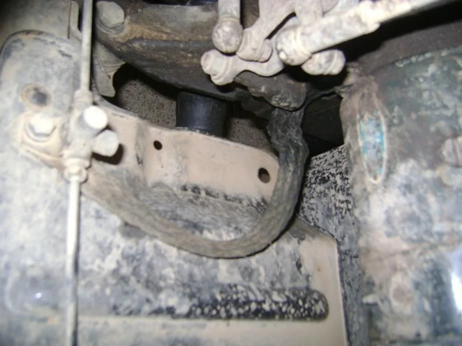

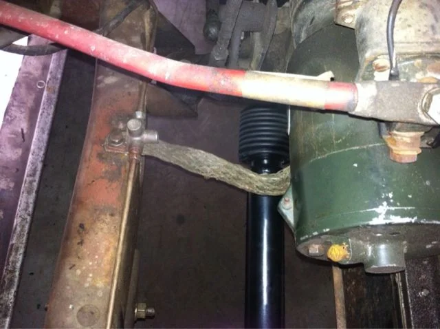

i've got a wider ground strap than what annie originally had, iirc, it was about a 1/4" and bolted under the brake junction. the battery ground is attached at the upper battery tray mounting bolt
Checked the only one I have easy excess to, my early 61 FJ40. The starter is a later one and no grounding strap anymore. The battery strap is still the original. It bolts to the battery bracket where it mounted to the frame just like the picture Ige posted. I'll check my white 25. That's the next easiest to get to.
