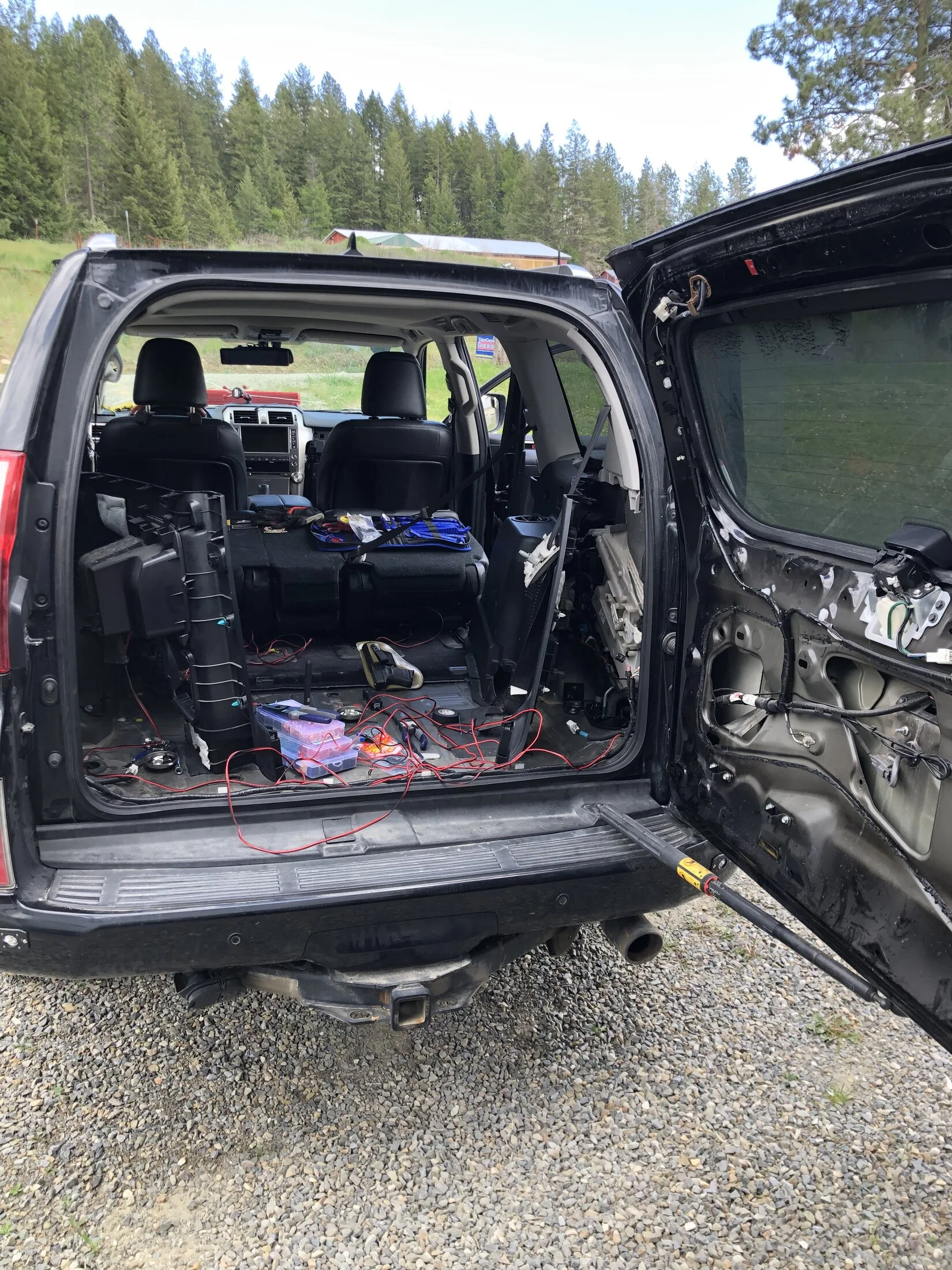

Finally got around to doing some wiring maintenance. Needed to take the 3rd row out and rear panels off along with the 2nd and 1st row door sills, console, and etc. Oh man is it dirty back there in the back. Ran out of time so I couldn't do the sound deadening so that'll wait for later once my retainer clip replacements arrive. Put the panels and stuff on but not everything.
Just look at the 2/3 row HVAC behind that rear passenger panel. That thing is ginormous and there is no way to get the seatbelt out on that side without removing it. So it'll stay for now.
Yeah in Jakes video when he got to the rear AC he called it something like a cross between a Borg ship and oil refinery, or words to that effect. I already have the color matching seat belt garnish replacement that doesn't have the slot in it for both sides. Planning on removing as much of the belt as I can then cutting that bitch. In theory the tensioner should pull the slack in as long as I pull it out as far as I can first. In theory...

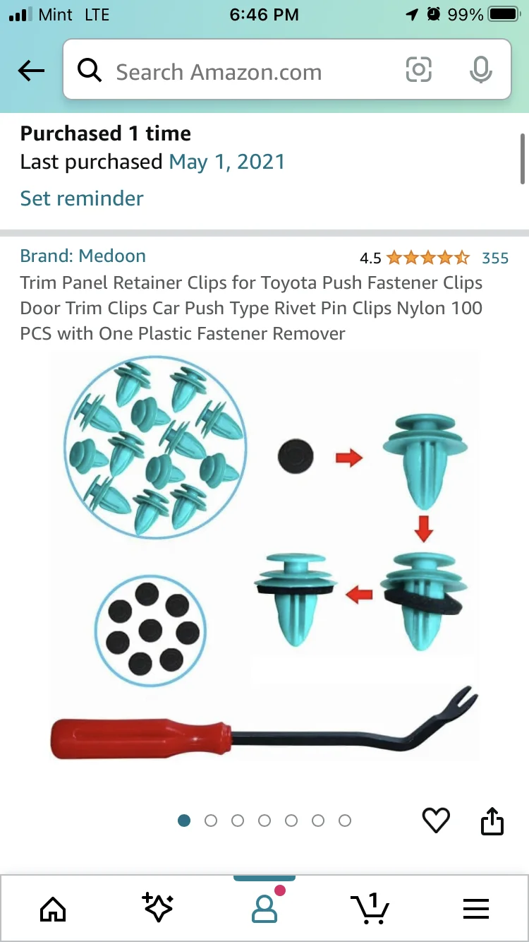

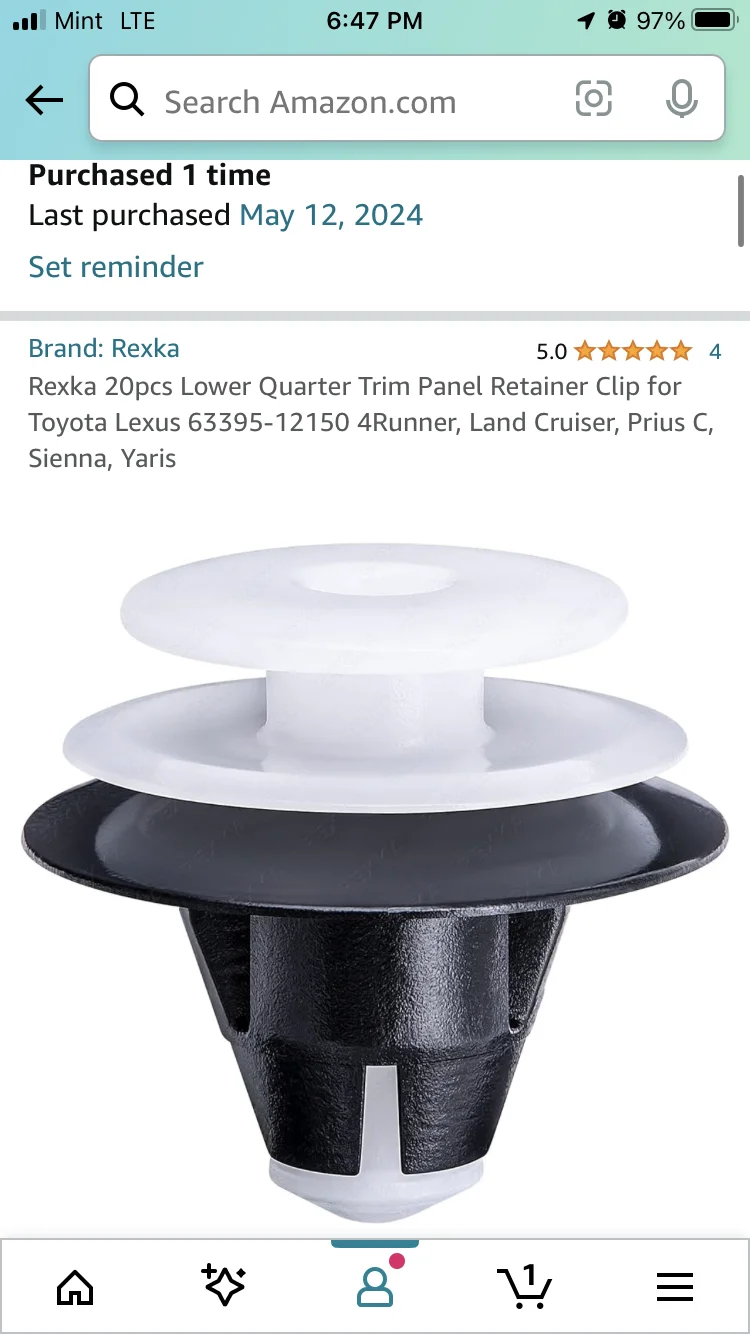

Some time ago I purchased a bunch of mixed body tabs from Amazon. They come in handy when needing to pull an interior panel and a tab breaks.
