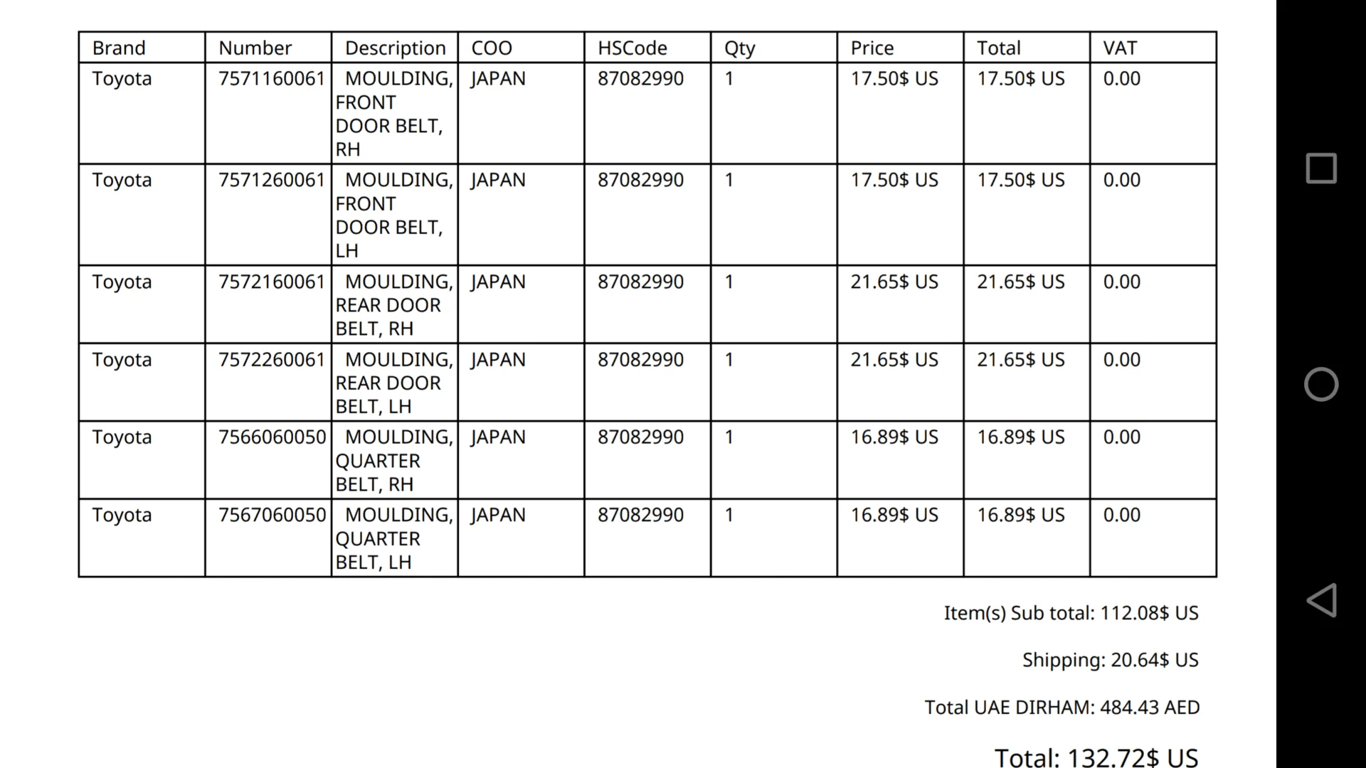

@Bluetribal i just ordered all the black belt moulding for mine from partsouq and it arrived in ONE day from The United Arab Emrites!! It was cheap and everything is in factory Toyota bags I'm attaching my receipt but it was all 6 pieces for $132 shipped! The part numbers are on the receipt.
