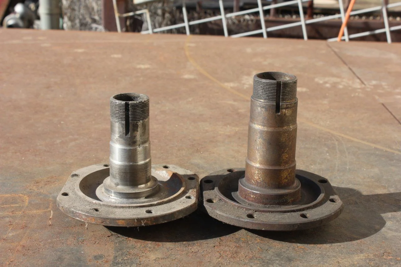

A member recently inquired on this topic. Assuming the info would be easily found on a Google search, I ran a search for images of drum vs disc brake spindle. Nothing really came up right away so I'm posting a side by side photo of the two for those who have never compared. I've always recommended the factory disc swap to early drum brake trucks primarily because of the strength difference of the two
spindles. Hopefully this post will spider out to the google search engine quickly and one, answer that
question to anyone looking for that, and two, bring non members to the forum who might be asking the same question
drum brake on the left, disc spindle on the right

Unfortunately the title of your thread here (and the message it conveys) is incorrect lcwizard..
Here's my LH-front spindle on my DRUMS-ALL-AROUND BJ40:
Note how it corresponds with your DISC spindle.
The difference you are discussing must be related to something else entirely (and can't be used to support any "drum versus disc" argument).
:beer:
EDit: OK.. I see you do refer to "early" ... But still I feel I need to say what I've said because year for year, the drum spindle is just as strong as (in fact exactly the same as) the disc spindle.

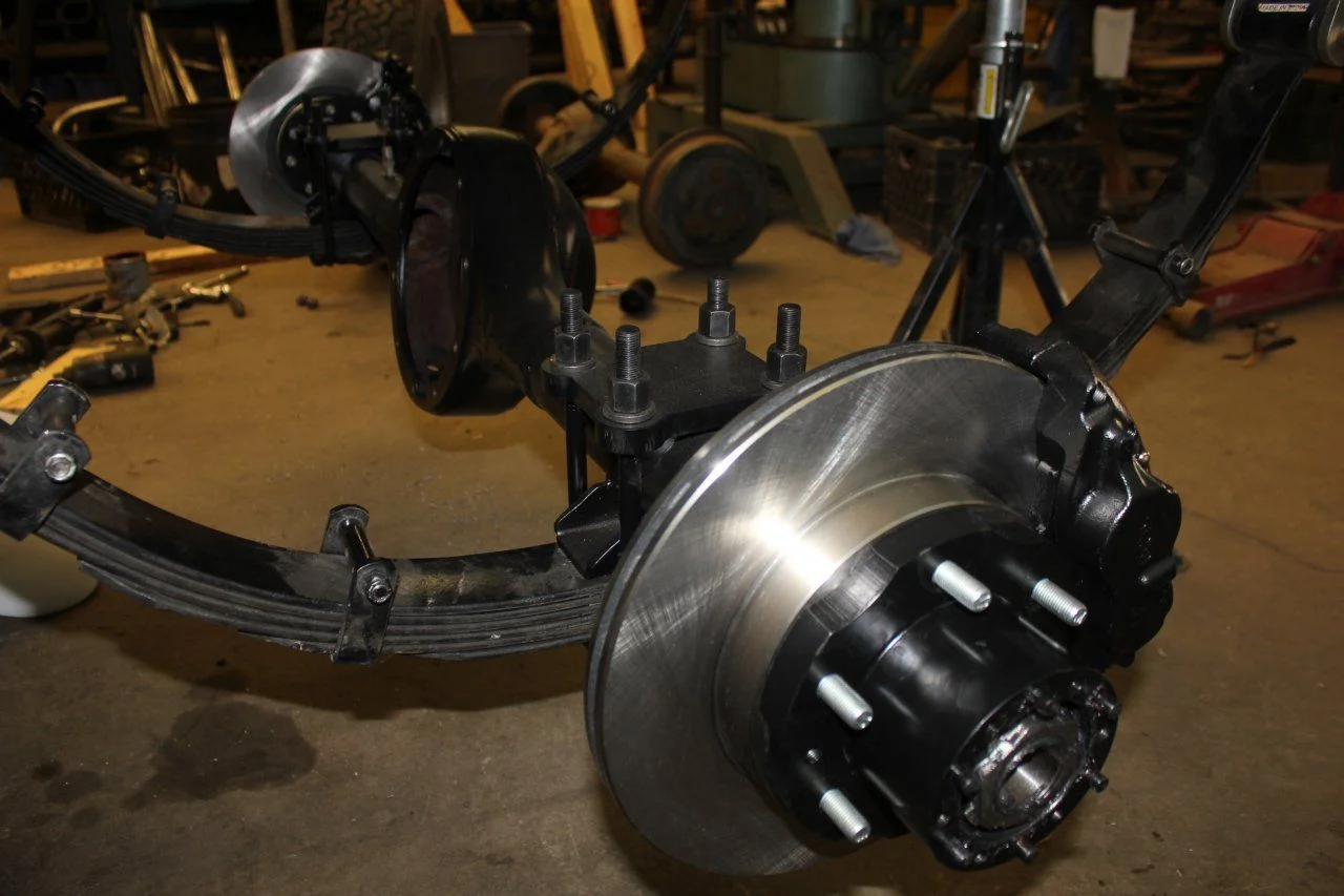

My 74' had the short spindles like the one in lcwizard's pic. Will be converting the rear to FF with Dave's rear FF bracket and need to source two more spindles & hubs for the rear. Just picked up an FJ60 so will use the them from it.
Will use the FJ60 front housing instead of the 40 housing because only need one of Dave's front spacers for the short side with the 60 housing. Though will need to cut the long side knuckle ball to turn it.

I guess I should say USA and Canada perhaps. I know around other places in the world The 40 continued using front drum brakes through the end of production. In the USA, Canada and perhaps some other countries the front was upgraded to disc brakes in 1976. With that upgrade the spindles were upgraded to larger, stronger pieces and the wheel hub offset changed so the front track widened by about 1 1/2". In the USA there are many companies offering quick fix disc conversions for the pre '76 40 and 55 series that retains the smaller front spindle from the drum brake front axle.
This is what I was referring to as far as using the stock Toyota components vs aftermarket when doing a disc swap to a drum front end.
The bearing journal OD dimensions on the early spindle are very similar to a DANA 44 while the
later spindle journal is similar to the DANA 60. In the US the large bearing journal diameter is about 50mm where the drum is about 41mm and the spindle length from the inner bearing shoulder is 110mm vs 85mm for the drum spindle.

In my book form follows function. Since the primary function of the spindle is to support the bearing inner races [which are not supposed to rotate] it shouldn't matter if the spindle race surfaces are pitted as long as you can keep the bearings properly preloaded against the outer races. I generally pass over recommending spindle replacement to customers unless I see evidence of fatigue in the radius where the snout of the spindle meets the flange. This is much more common on drum brake spindles than disc [on the order of 30 to 1].

Now I'm even happier to be using Dave's rear FF brackets so my spindles will be bolt on replaceable if needed.
Allen

This is very interesting. My '79 FJ45 has big spindles like lostmarble's truck. Are they actually identical to the disc brake items? If so, that's good news, as I was already planning to move my front spindles and hubs to the rear once I come up with a flange to weld on to the rear. I also was toying with the idea of mounting my original front brake backing plate with its double leading shoe brakes on the rear axle while putting Hilux discs on the front. I even considered welding on disc brake compatible flanges so that at some point in the future I could do a disc brake conversion on the rear.

One of the reasons I like using front spindles on the rear FF/Disc, is that the spindles on the OEM axles are welded in. So if one ever gets buggered up, cross threaded or damaged it's a production to replace it. But with front spindles just a matter of unbolt one and bolt on new one. Well, I guess a little bit of machining to open up the spindle for the Marlin Eco Seal, but that isn't too problematic tho.
